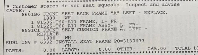

Update: It took longer than expected but I have an appointment (dealer) next week to have the seat frame replaced. They had the parts but needed Honda approval along with scheduling an upholstery specialist.

Did you get this done yet? I am curious to know how it goes and if it solved the issue.
Yes, picked it up yesterday and the squeaking issue is 100% resolved. Cabin is now amazingly quiet. Below are some details on the parts and labor used to assist anyone else experiencing this aggravating issue.
11th Gen Honda Civic Interior noises - rattles, creaks, squeaks! seat fix

Whats the most crazy to me (me being a Honda SM) is that dealer had to sublet out the seat work. Hilarious lack of abilities these days. I have 6 guys that could do that job no problem. Is it a PITA? You betcha.
