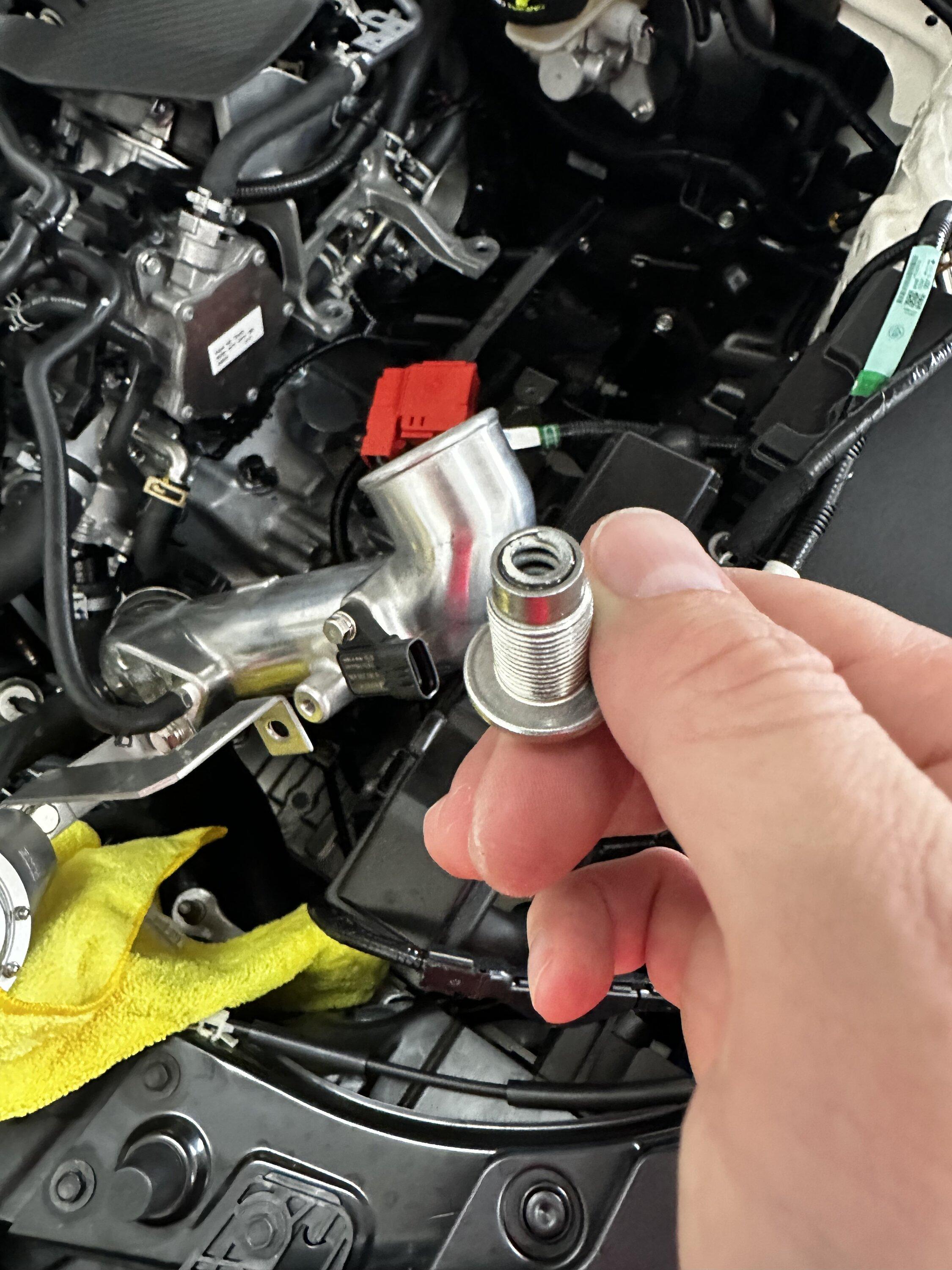

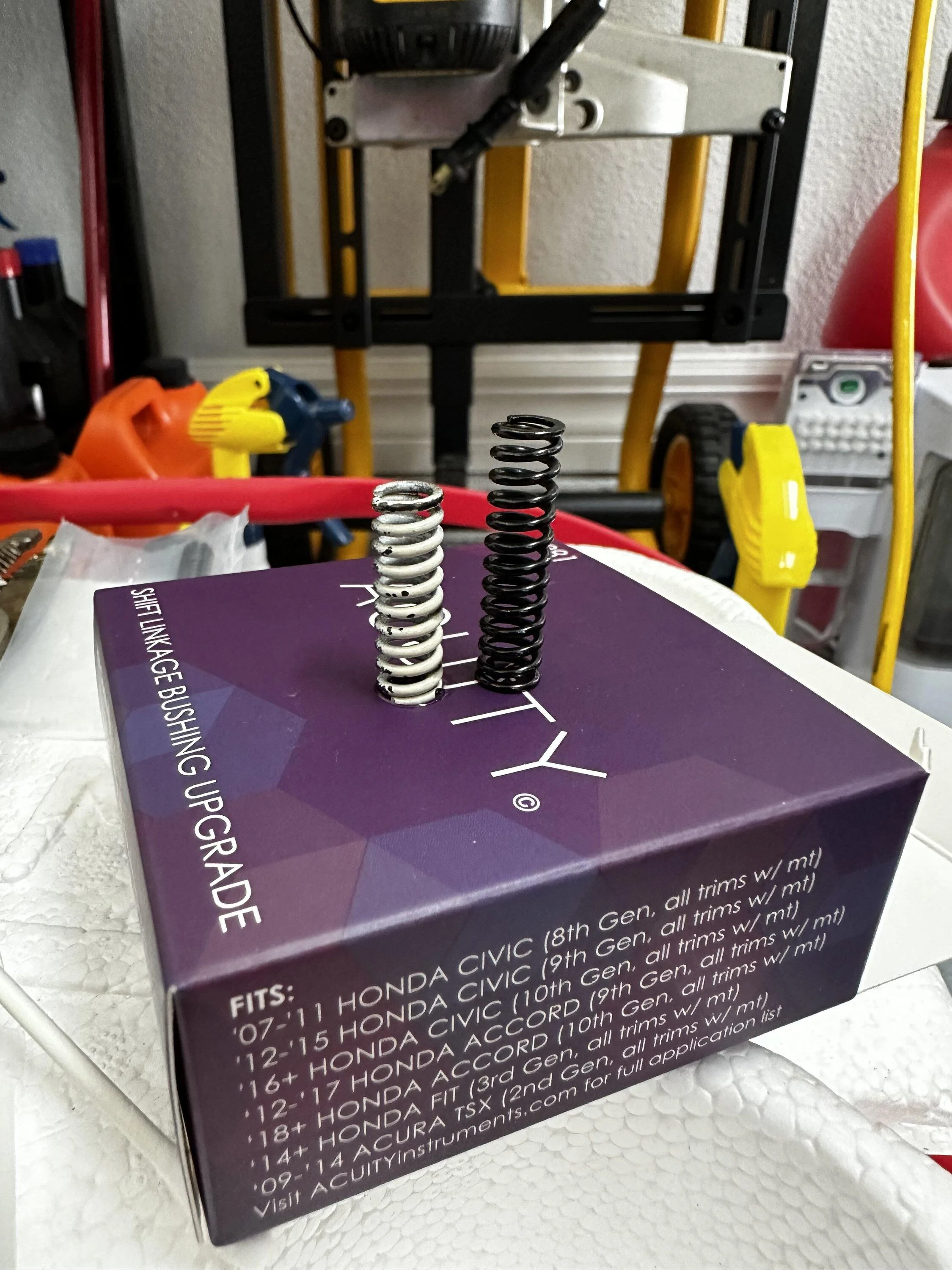

Ok so installed them! Side to side movement on the shifter has a lot more resistance and it feels really tight. Forward and back is marginally improved almost not noticeable. @Fl5ap

Do you prefer the stiffness with the upgraded detent spring?
Once I do the additional cable bushings I think I'm gonna go for the clutch delay valve mod. After that, I think it will be perfect. My objective was to enhance the feel of to be very direct between shifts. Well see!

I really should? but I feel I sound silly in videos. I think the delay valve delete is a great mod and will be also taking it out. With the detent springs the shifter feels solid. In my opinion its worth it, its only $20 bucks and if you will be in the area it might be worth trying out. Worst case you don’t like it and it did not cost much and its super easy to install if you already have the battery and intake box out.

If you're gonna be changing the cable bushings. Go ahead and grab a set of detent springs and install them while you're down there. For a $20 mod, it makes the shifter feel even more better.

what model number for the detent springs? seems like acuity website states it does not fit k20c1 transmission?

what model number for k20c1? can’t seem to find fl5 compatible one?
