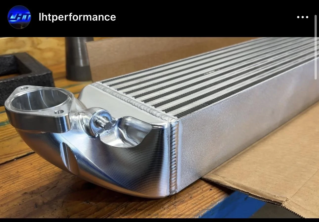

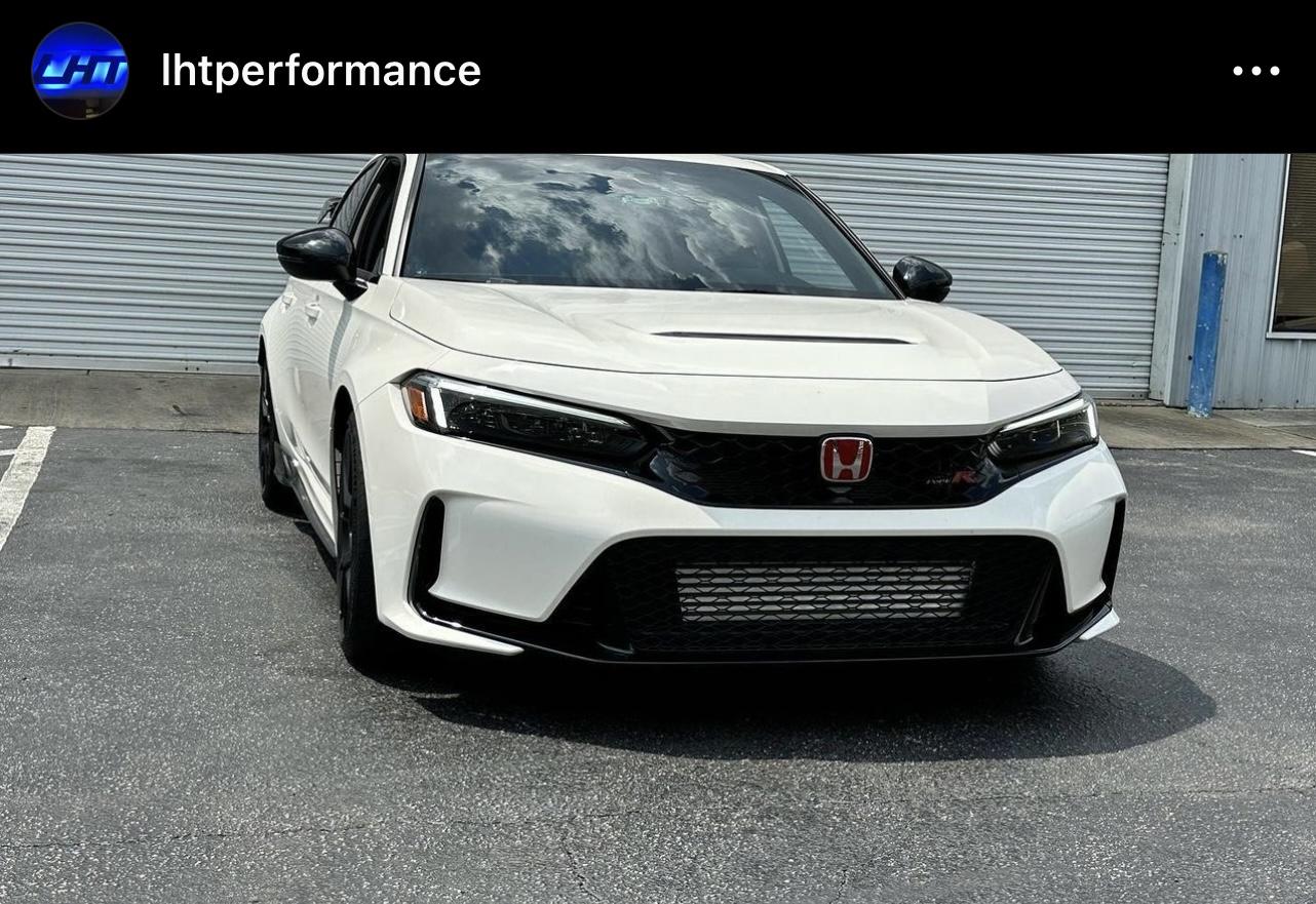

Unexpected opportunity and decided to jump on it. Worked with LHT performance on this. PRL fmic.

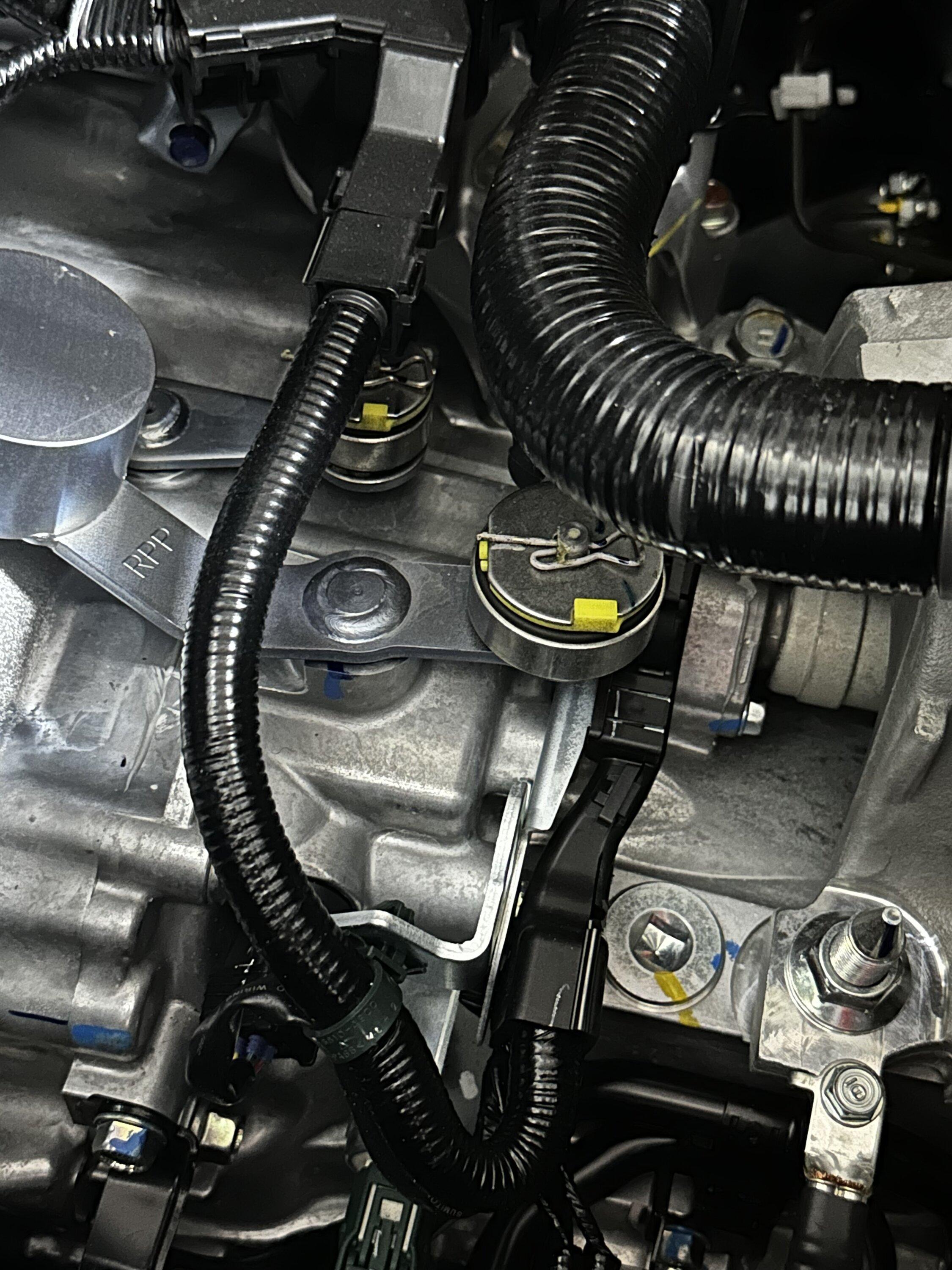

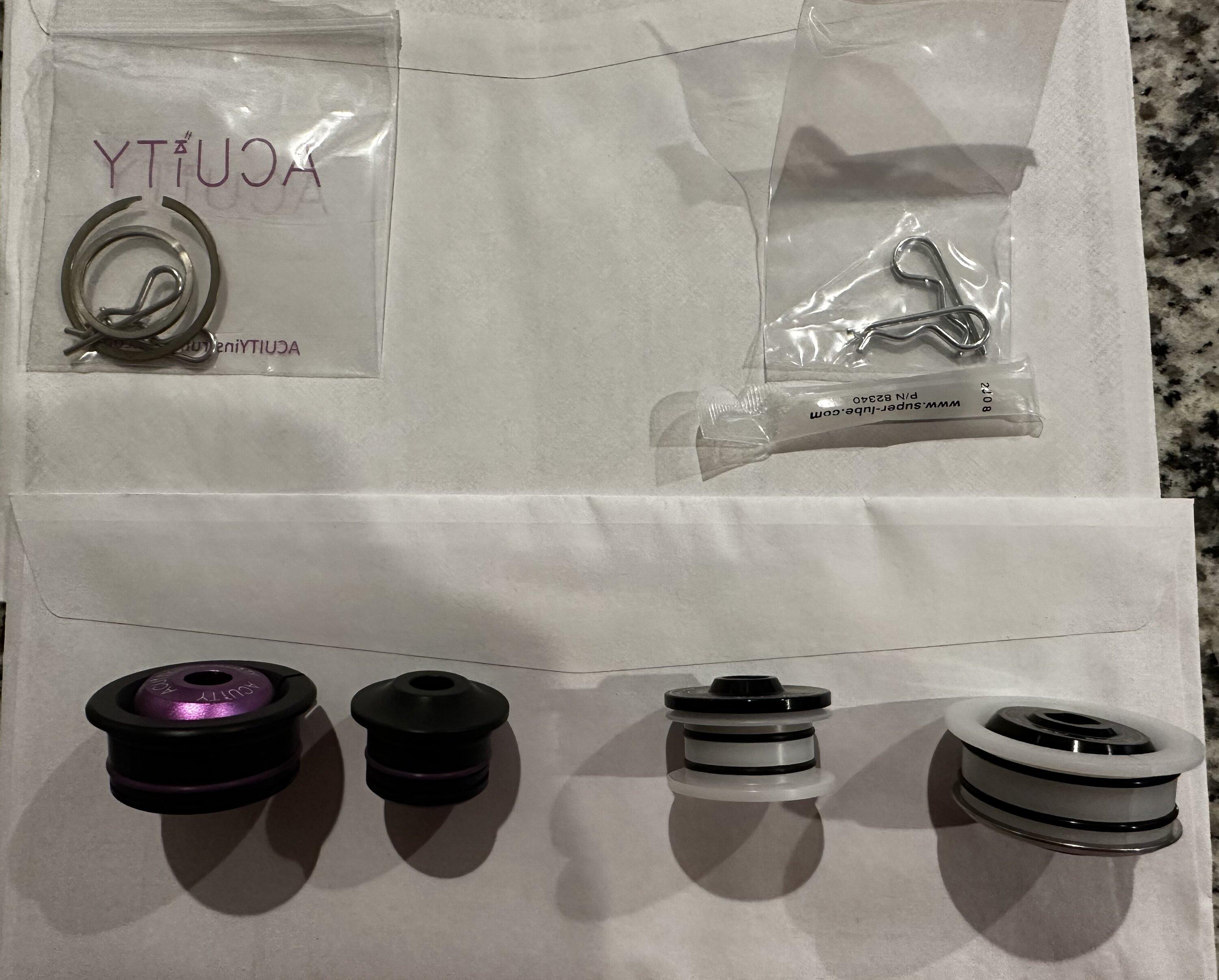

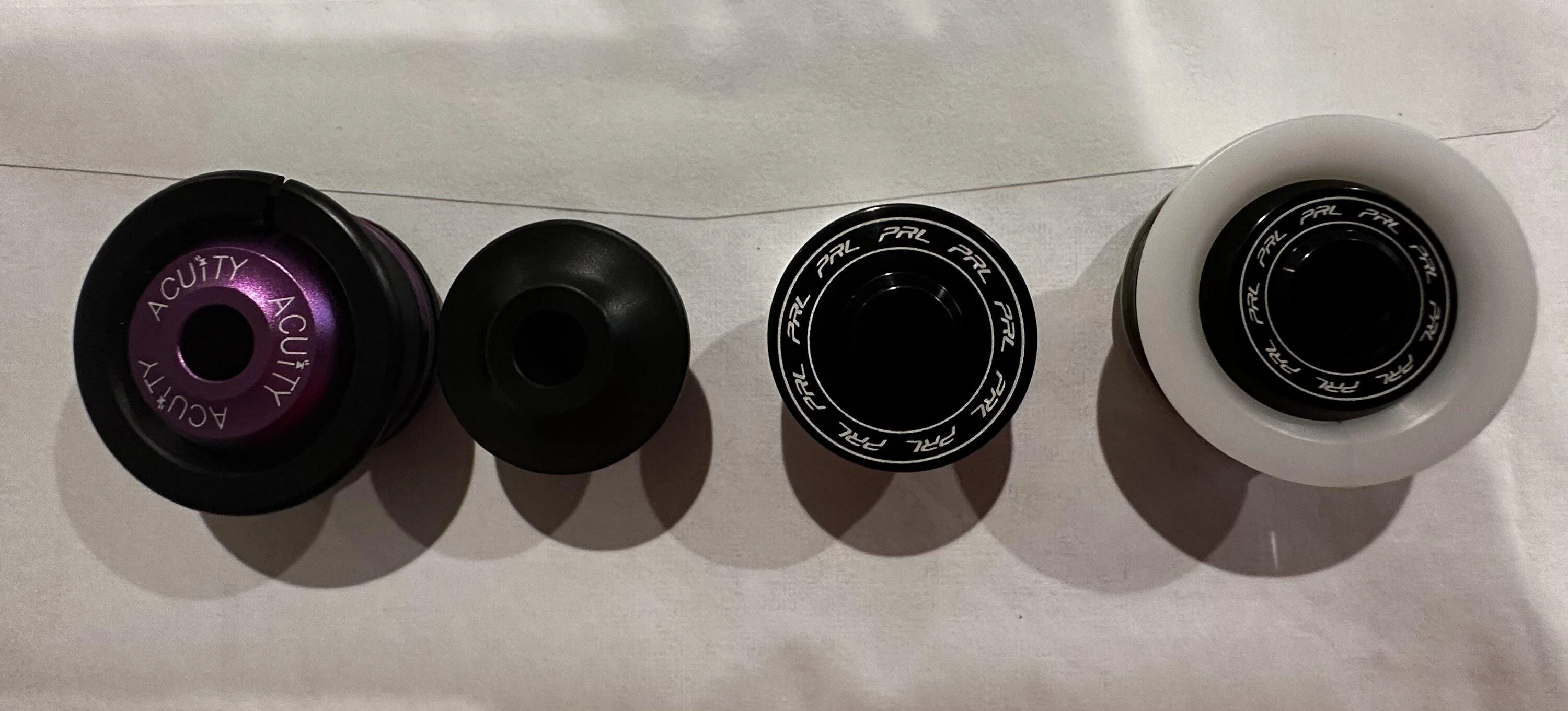

Doing a shifter cable bushing install on the car today with detent springs. Bought an accuity and had some PRL bushing kit to compare.
Both kits seem to be excellent quality, the PRL does include grease in the kit. Securing the bushings is different for the smaller one. The PRL has a cap on the bottom but no clip and Accuity used clips on both. They are also both made out of delrin so no binding should occur. Will install the accuity since it has the black delrin which I like over the white one and it also has that signature purple color.
I also installed some PRL shifter base bushings which were a PITA to install but did not take pictures.

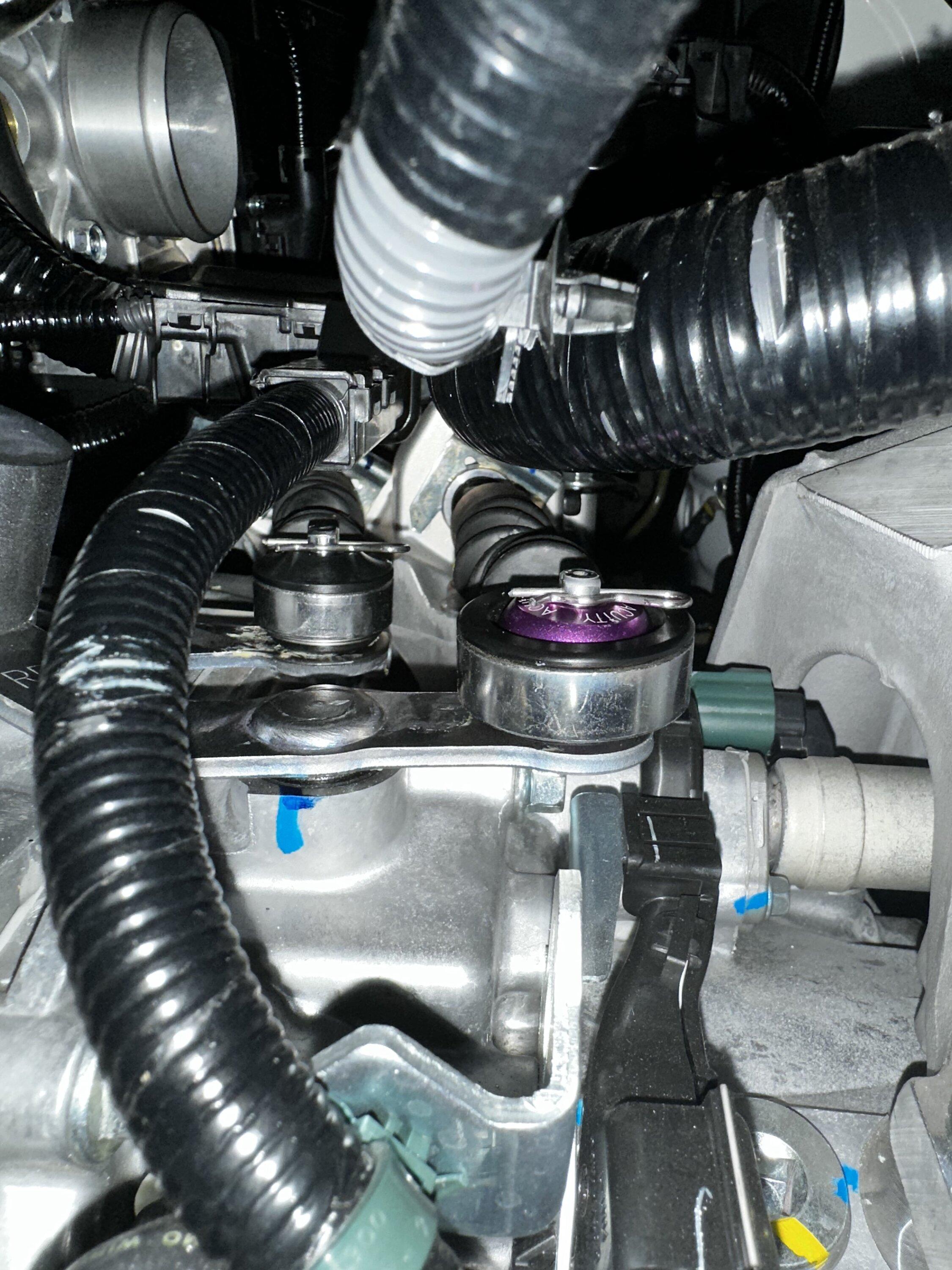

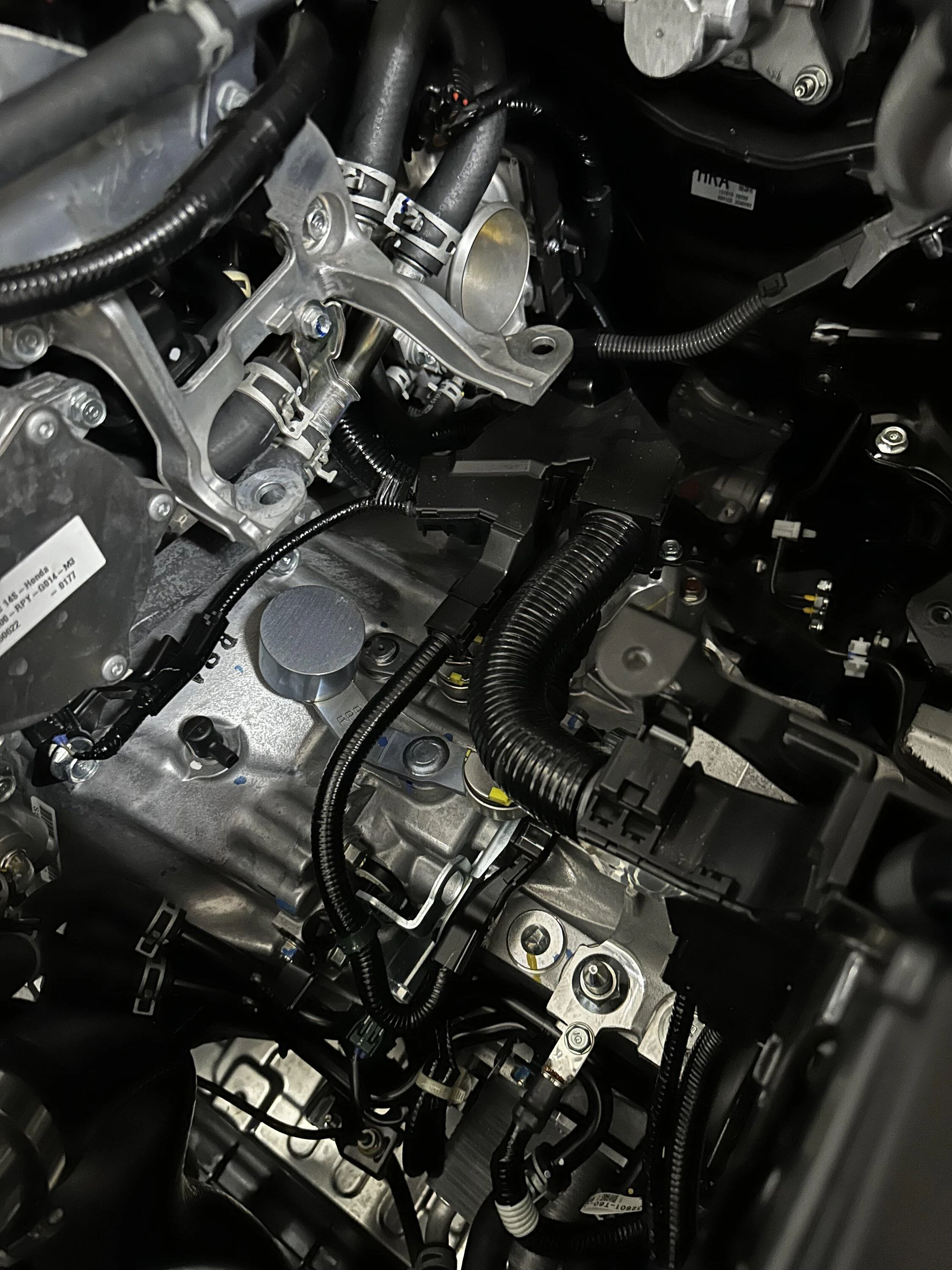

Bushings installed! You do have to remove quite a bit of stuff to get into the shifter cable area. Did not remove the harness covering the cable just decided to take my time and install them right there.

Stock vs accuity bushings in the video. First one is stock second one is with accuity. No change in engagement or any issues. You can’t tell in the video but it feels marginally tighter when going through the gears.
