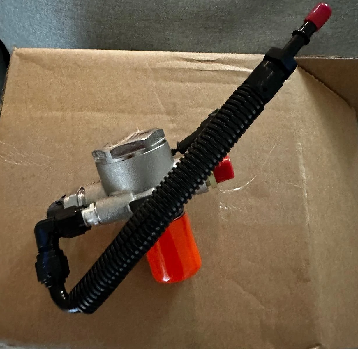

Here is a little snapshot of what is coming for testing.
Huge shout out to @Two Step Performance for the help in acquiring the full race fuel pump. I try my best and spend a lot of my own money for testing and providing you guys the data to be able to make your own choices while having as much information as possible to help you in your upgrade path.

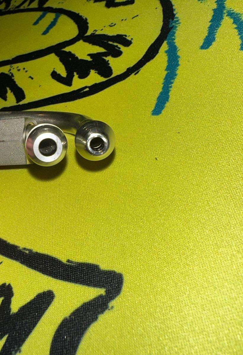

Fuel line comparison:
Pump connection for the fuel line on the pump side OEM (right)vs Full Race(left)

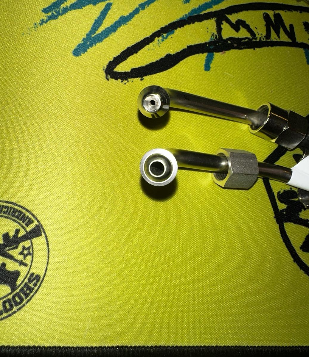

And now the biggest difference:
On the fuel rail side Stock line modded (top) vs full race (bottom).
11th Gen Honda Civic Jester’s Hondata thread IMG_4255
The difference is absolutely on another level.

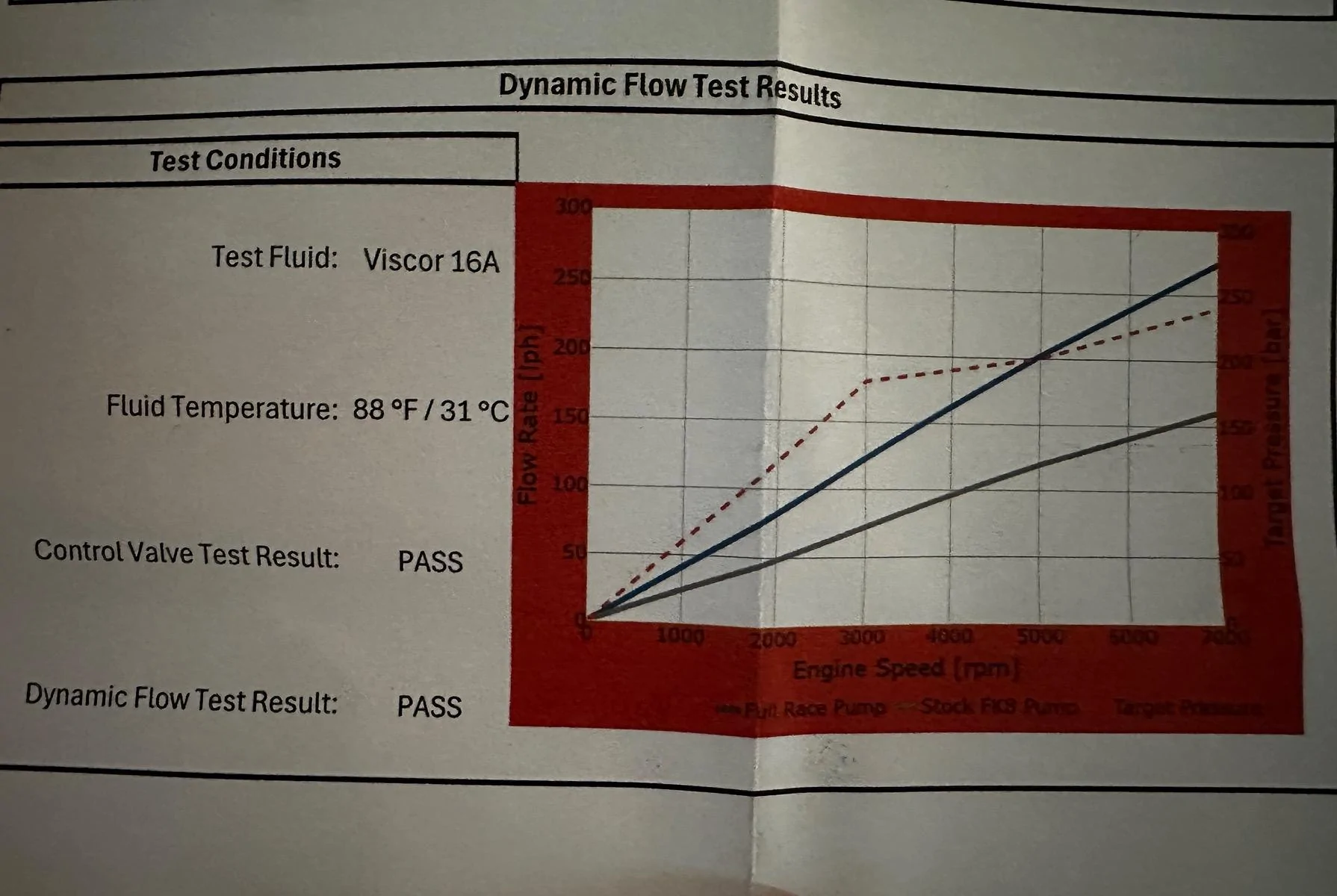

A little chart comparing fuel flow for the pump.

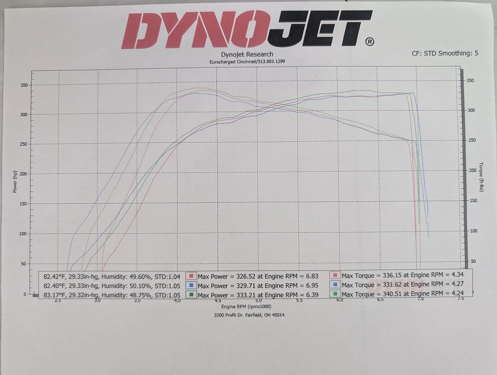

Well to be fair just a flash with a tune will make more power than that on the FL5. That is how much more efficient this engine is.
