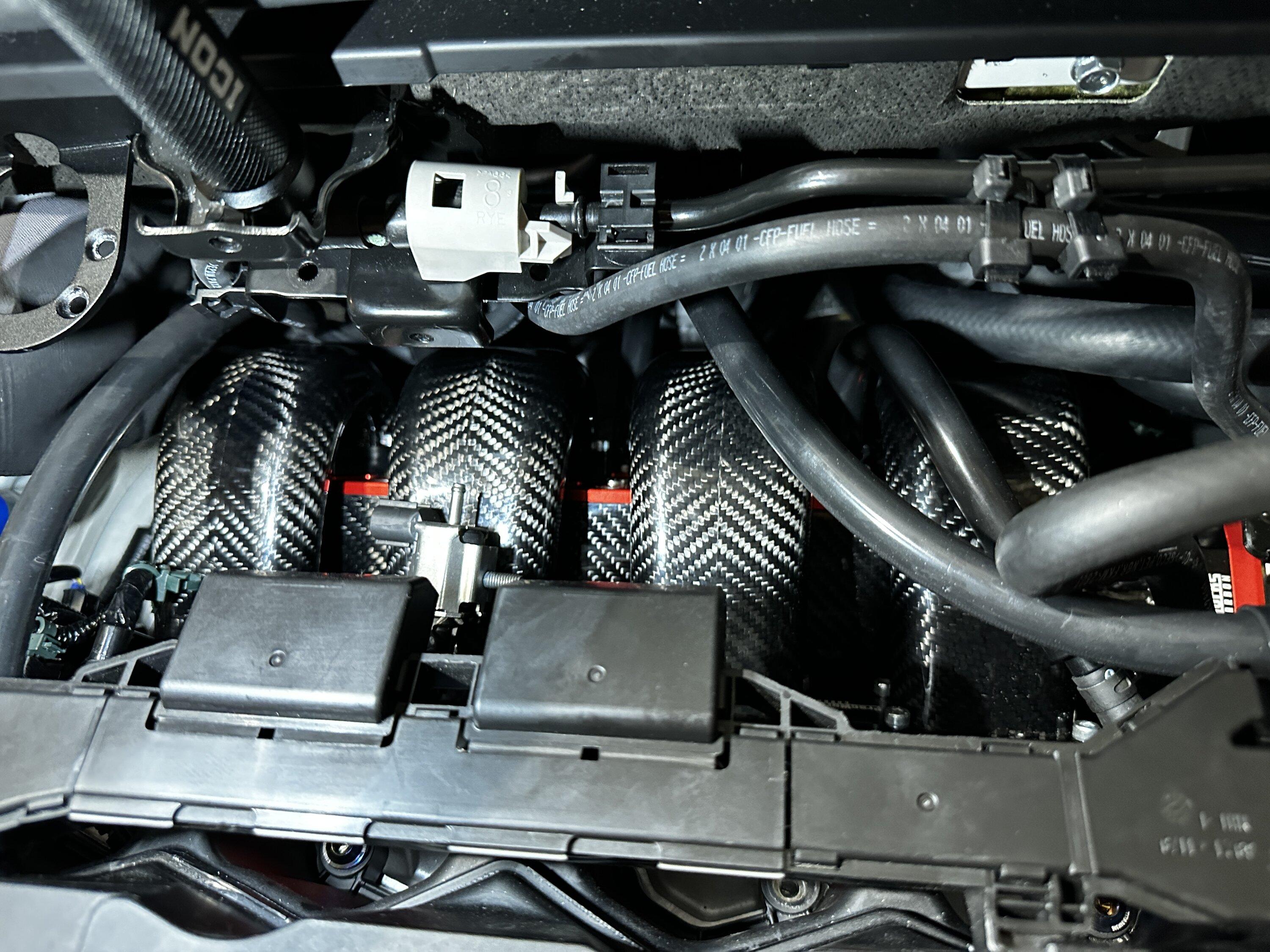

11th Gen Honda Civic Jester’s Hondata thread IMG_3187
Also fair warning you have to modify a lot of the lines in the car and the fuel line flops around. A stock intake manifold will work for 99.9% of most people unless you enjoy the bling.

I helped my friend install his intake manifold over the weekend and we are currently testing but all the mods went in at the same time. So it harder to gauge what affects what.
It doesn't have a 10% power increase at 3500 RPM like all the marketing suggests?!
Sucks to hear it's not plug and play especially for the price. I'm used to aftermarket intake manifolds on LS which were easy to swap.

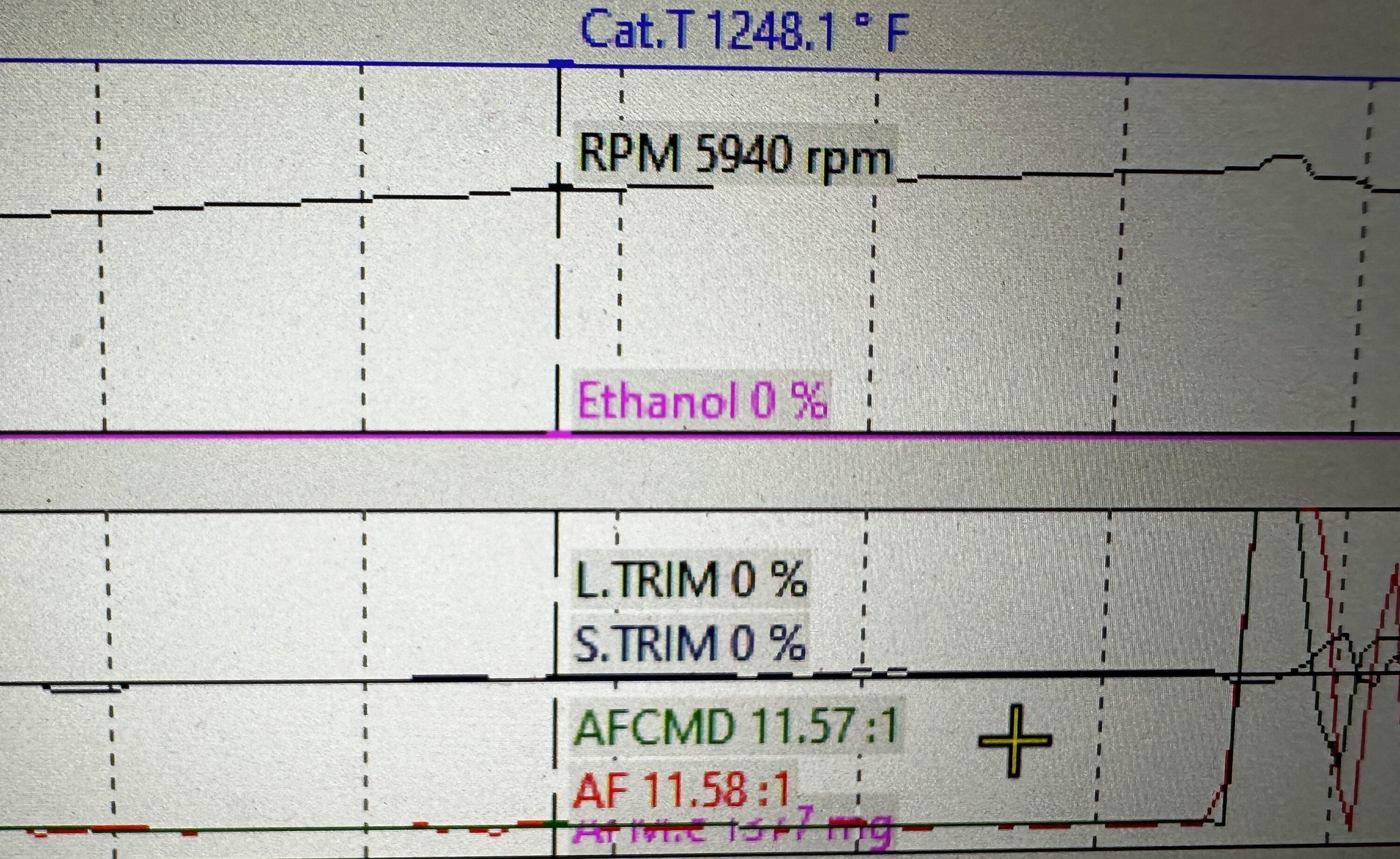

Just got done with another FL5, Will have 2 more spots open this next week. I don’t take many cars at a time to be able to provide excellent service.
Last car I did, with XDI pump and 1400 fuel injectors. As you can see the fuel is as dialed as it can be.

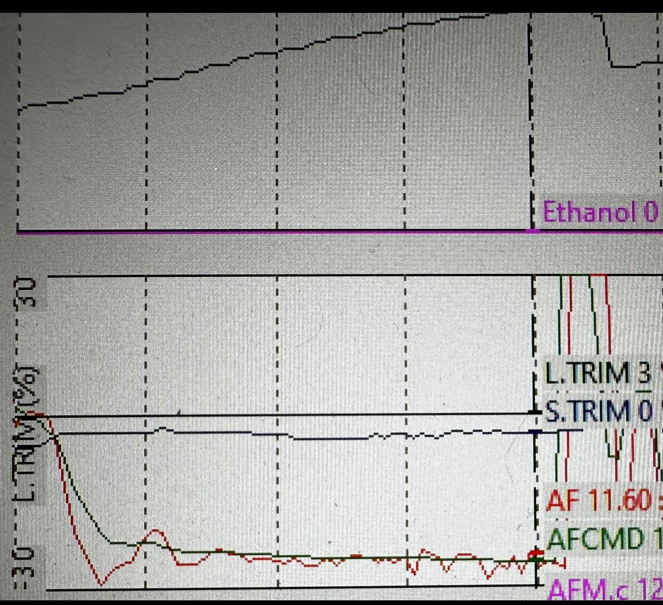

I forgot to post this yesterday since this thread is to help also with information and education about the platform.
This is the same car with just slapping on the pump and injectors and enabling the settings on Hondata.
You will be able to see how choppy it is by just going off the settings. Every car needs their own adjustment to bring everything to where it needs to be.
