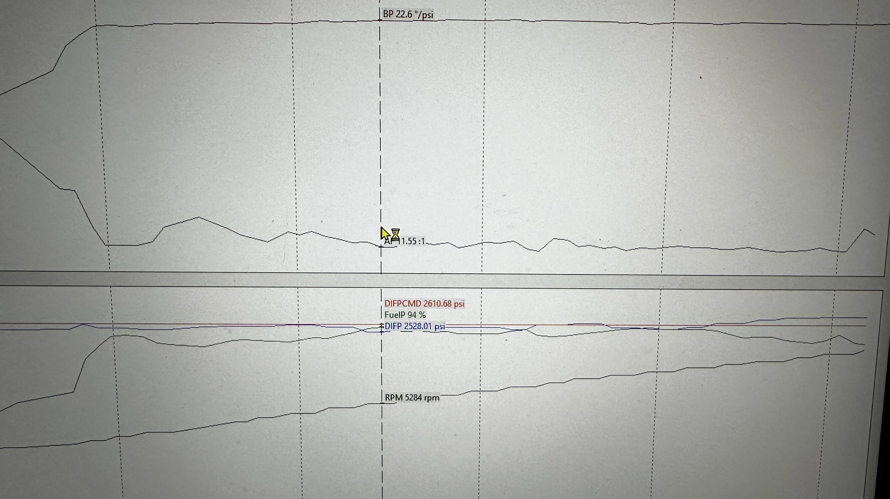

So little update with some data to back it up. I’m still adjusting the fuel curve to bring it in line with the commanded so it’s a work in progress.
Here you can see the fuel pump duty cycle commanding a very conservative 11.5-11.6 AFR. It gets up to the 90’s but it’s holding rock solid. Boost is at around 23-24 psi. I’m going to leave it there boost wise and play with some ignition timing and see if it likes it. The highlighted part of the graph is the highest pump cycle that I saw. Also take into account that the pump does a better job going through the gears. This is way more stressful on the fuel system to go wot at low rpms and have it carry the power all the way through.
