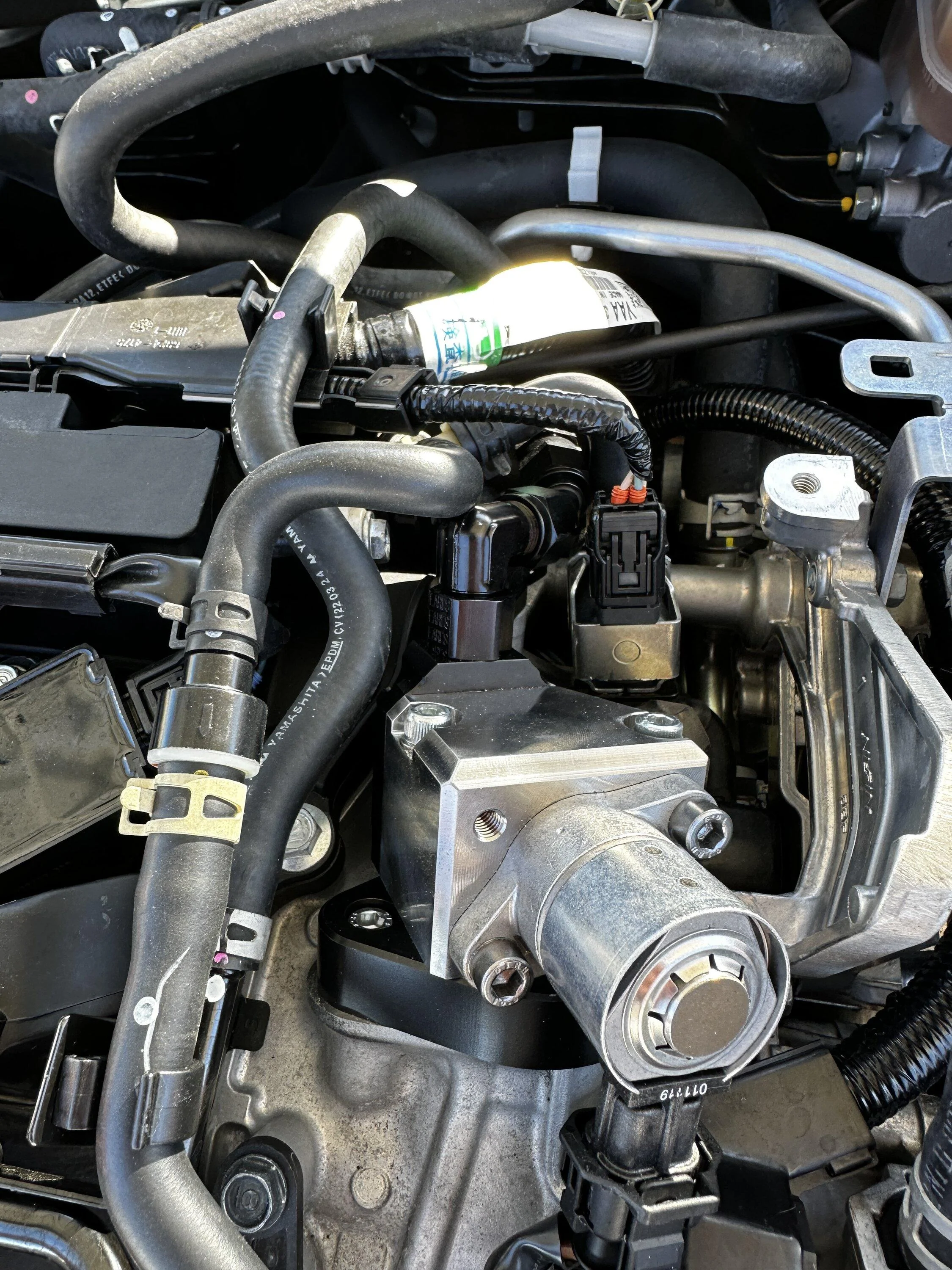

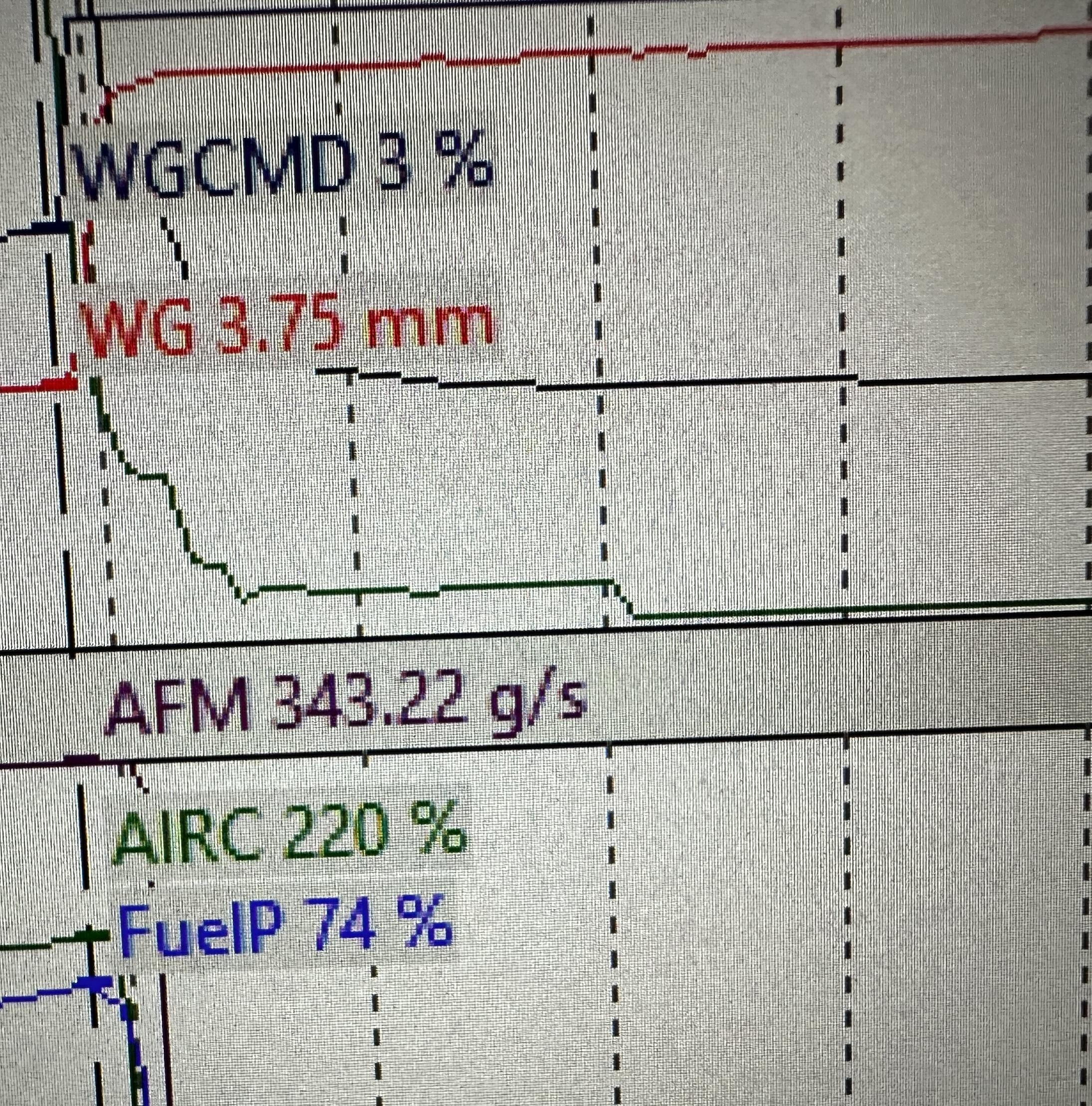

Ok so fuel pump is in. Managed to get everything lined up and installed. Initial testing seems like the fuel pump is working great. I am getting some oscillations at the top of the rev range which makes the AFR erratic but not unsafe.
I strongly believe this is because the High pressure line is still stock and the pump is asking for more flow to stay consistent. I will be testing it out this week and report back. But if the oscillations continue upgraded line is the next step. I won’t be able to keep testing with the stock injectors since to me it makes no sense to unbolt everything for the line and not swap out the injectors for effort and time saved.
But from my initial log it looks like it can be just line and upgraded fuel pump and stock injectors will get you close to 450whp no problem.

Holy crap the install on the FL5 HPFP looks super easy compared to the last HPFP install I did. On my last HPFP install I had to take out most of the items on one side of the engine, including the intake manifold. I will definitely look into this upgrade in the future.
Jester04
Jester04
2,039
2,666
Awesome info, keep it coming!
Yes super easy to install! About an hour and the hardest part is lining up the fuel line everything else is super easy.
But fuel line upgrade highly recommended

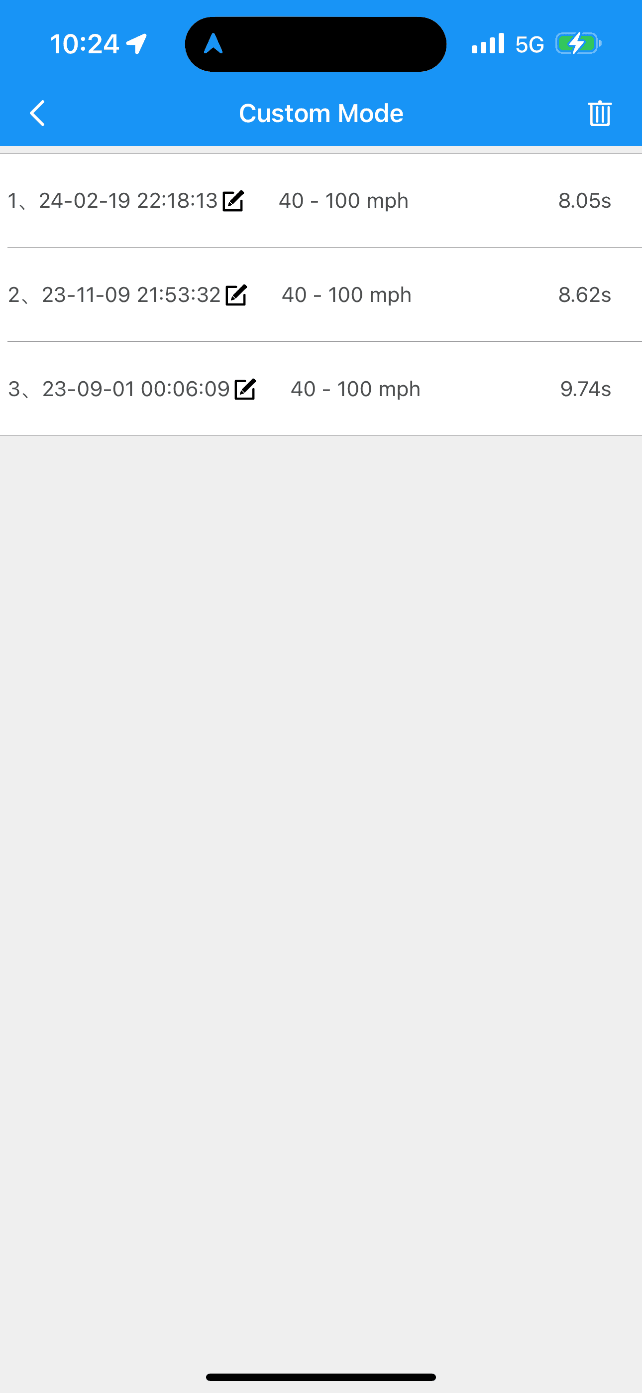

Here is a little comparison. These 3 are 40-100 mph pulls.
Stock 9.74, tuned the 8.62, big turbo xdi pump tune is not done at 24-25 psi 8.05 it would have been faster if it wasn’t spinning so much lol. Should easily do it in the 7 second range with less spin.
