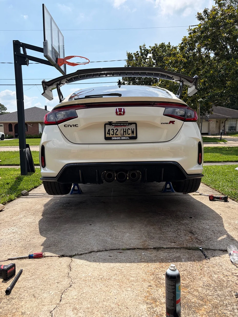

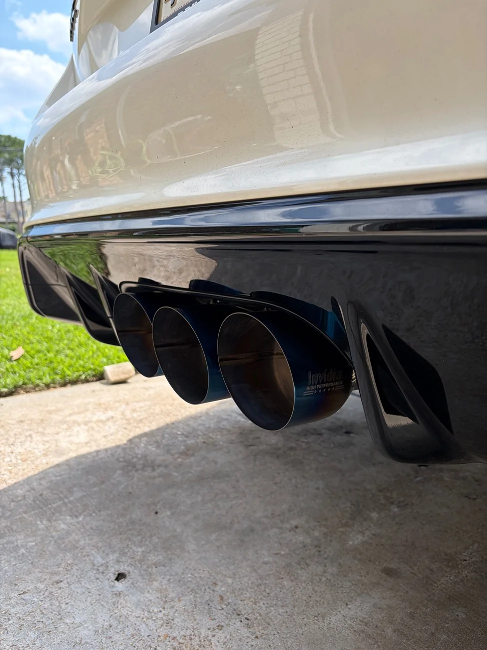

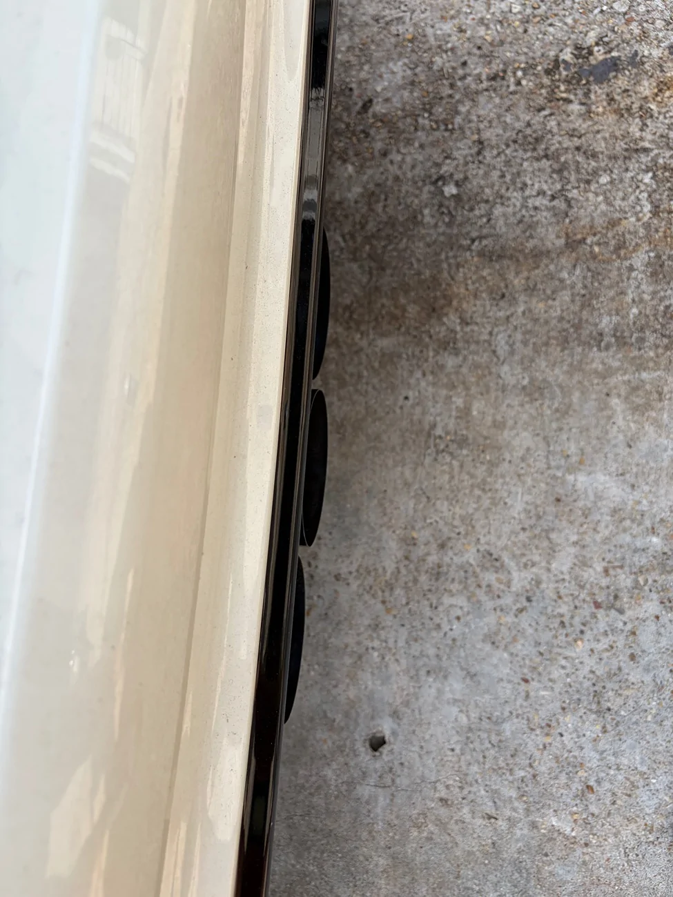

Got the install knocked out and it was surprisingly easy to bend the piping with vise grips to get the tips on so no real issue there.
You can’t completely set all 3 tips flush with each other but you can get them very close. The center solidly mounts and the outer tips when flush with the center aren’t slipped far enough onto the piping for me to be comfortable with, but it still looks great IMO.

That looks really good ! How do you like it so far and do you have any more pictures from the back? Thanks again

looks really good and not as far out! How loud it is? The outlets are the same size the 3 of them?

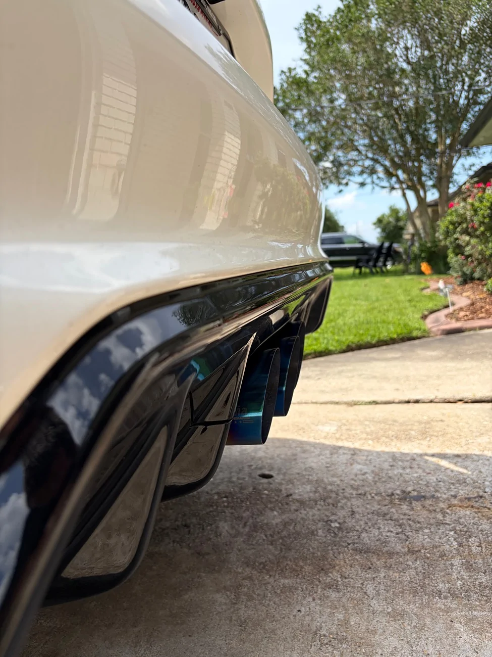

Looks great from the rear. The adjustable rear hangers let me tuck it up pretty high which I prefer.
11th Gen Honda Civic Need Help with Invidia Q300 IMG_8910
I had a remark dual tip stainless exhaust before so it’s the easiest way for me to compare it. Valve open it’s louder than the remark, valve closed it’s quieter with a hell of a lot less drone. I would call it oem+ with the valve closed and completely tolerable under load even for someone like me who gets headaches easily and often.
all 3 outlets are the same size as well.
