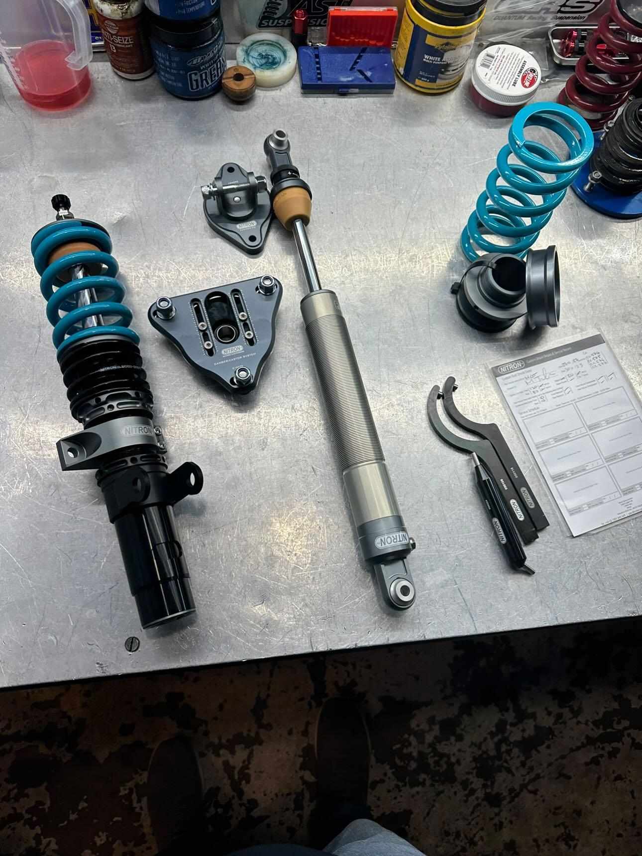

Well the new coilovers shipped from Inertia Labratory today. Really excited to get these on with the suite of RV6 parts.

4k shipped, includes the camber plates.
110/70 or 140/90 nm rates
I went 120/80 so 695/456 ft lbs.

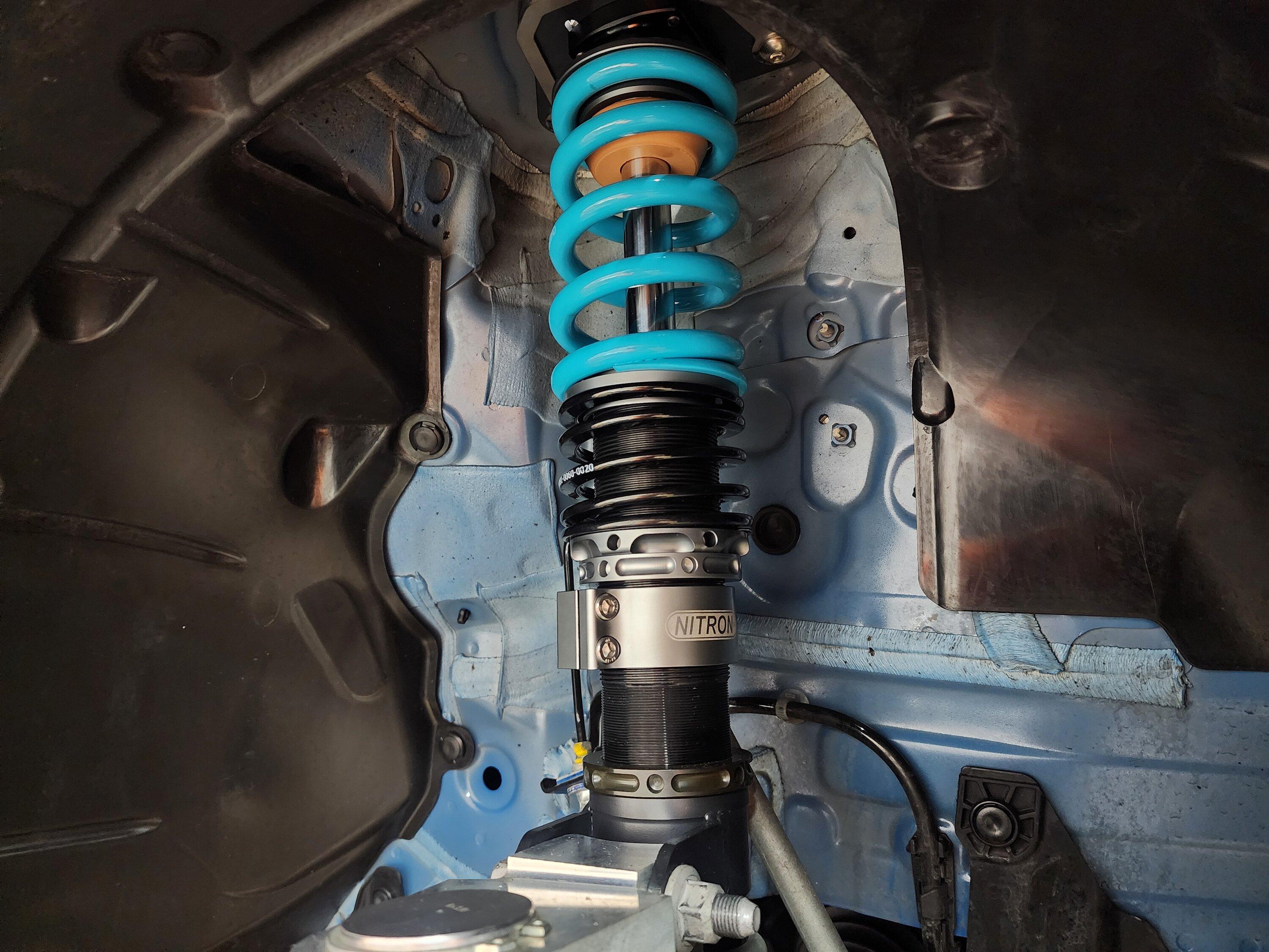

Install went off without a hitch. Now to adjust the height and get the alignment squared away. Still waiting on my new wheels so I tossed on some Apex VS5RS for the time being.

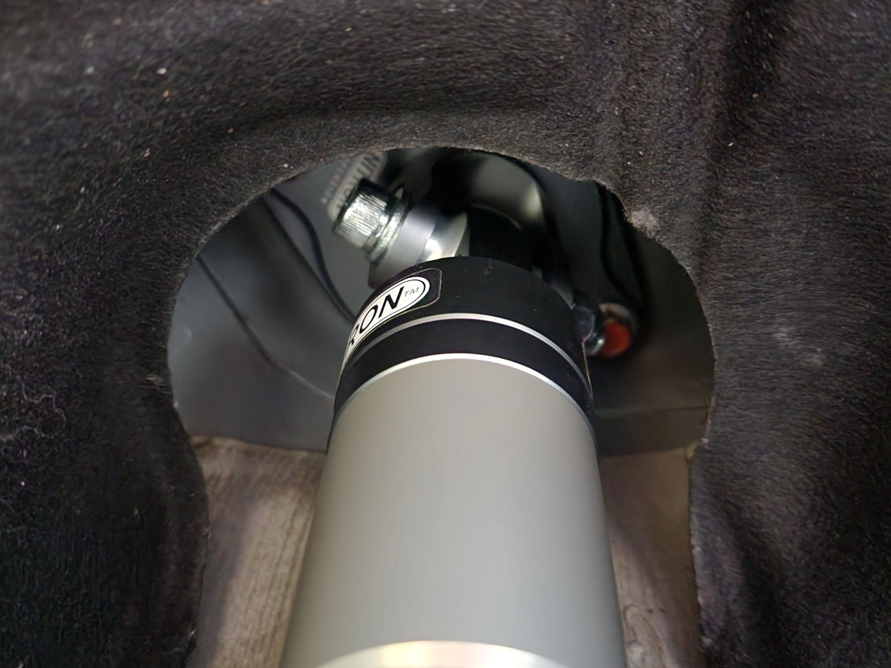

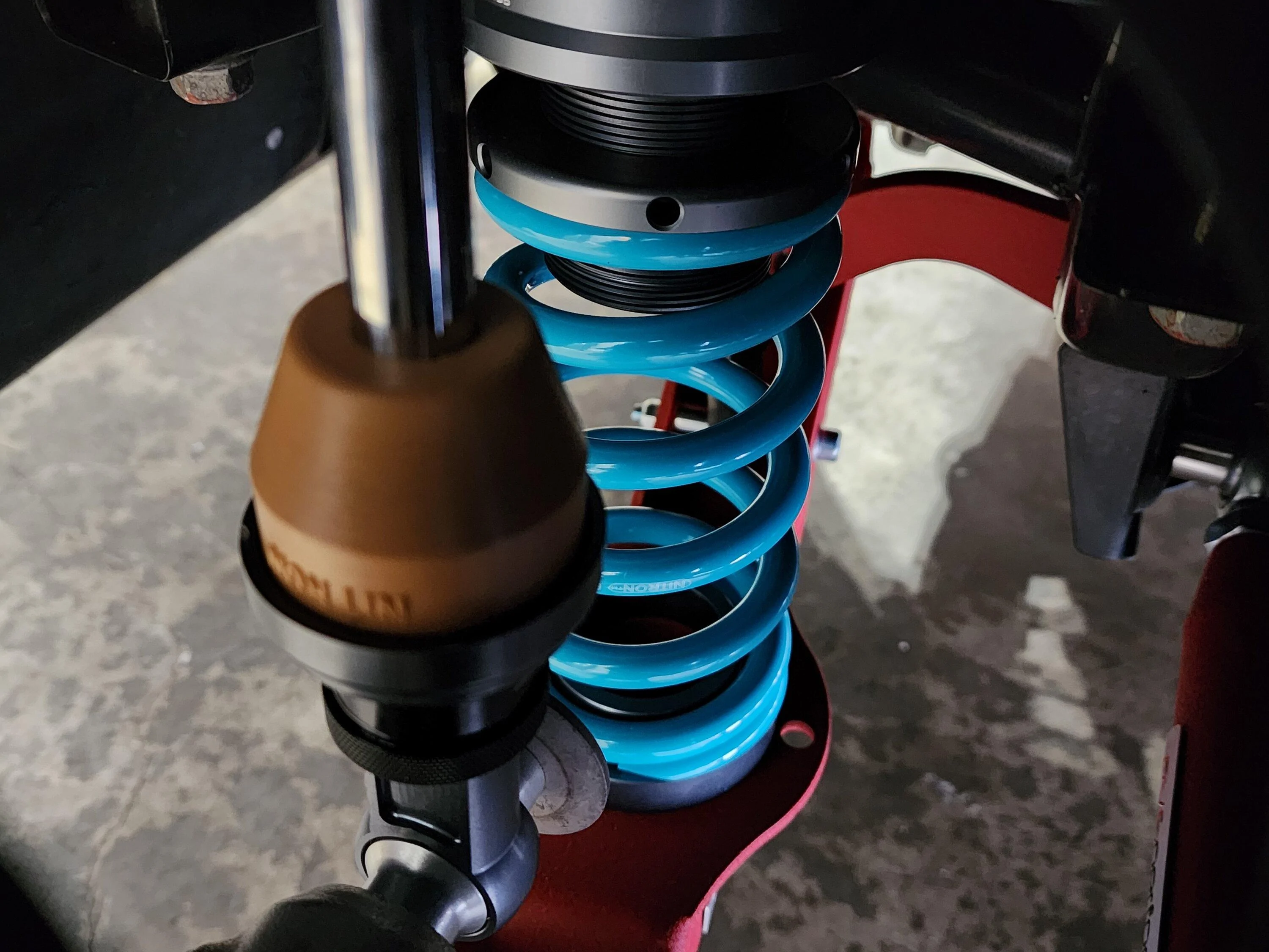

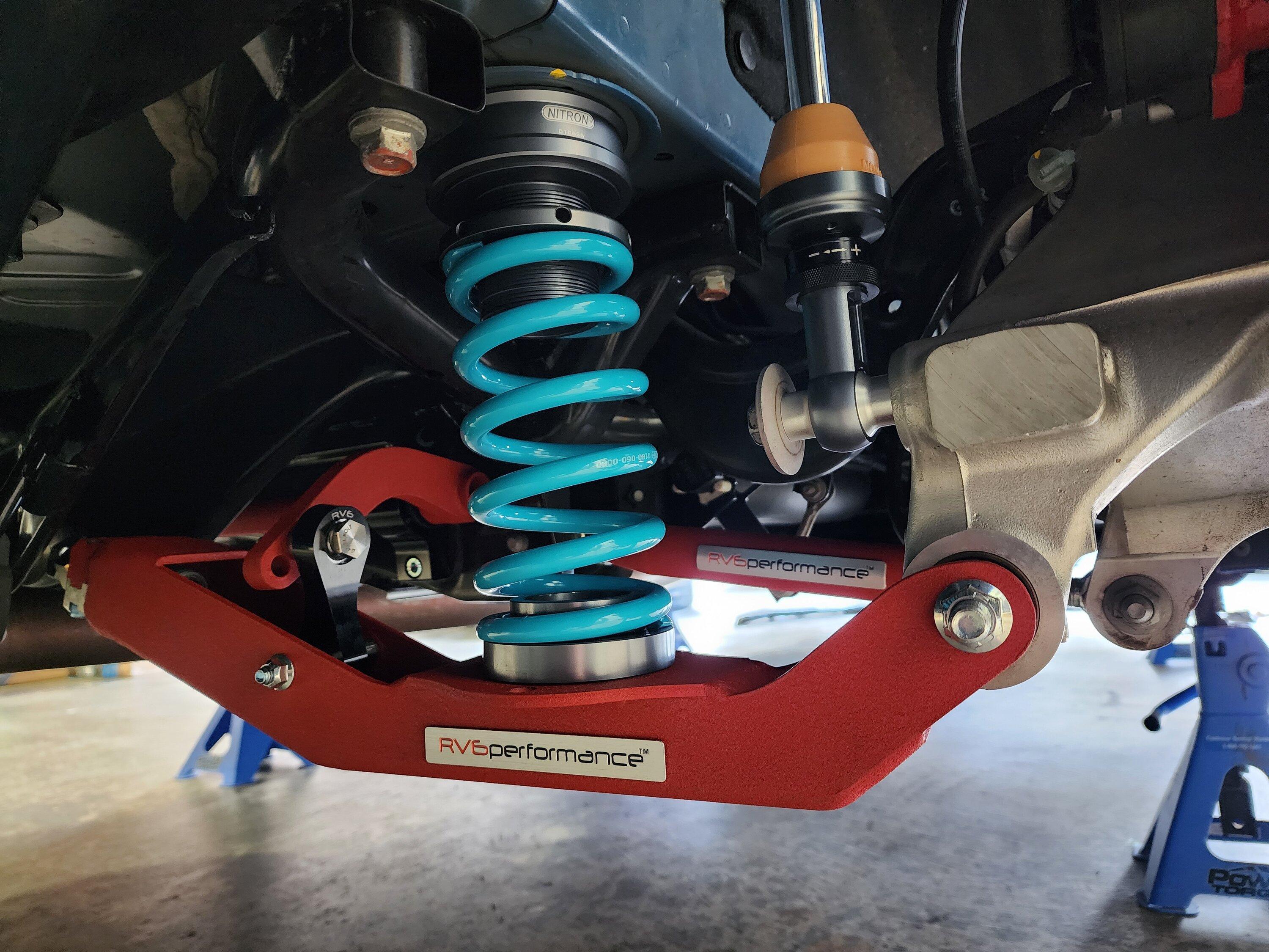

the clevis design for the rears is interesting. It seems like it would delete a good chuck of available shock stroke. I guess the design was needed to get the rear shock inverted?
How much droop do you have in the front and rear?

Yeah, interesting for sure. Same design I had on the set for my GR86. I will measure droop for you later today when I have a moment.

Spot on at the below measurements.
60 MM - F
30 MM - R

Is that rear measurement with the rear sway bar still attached?
