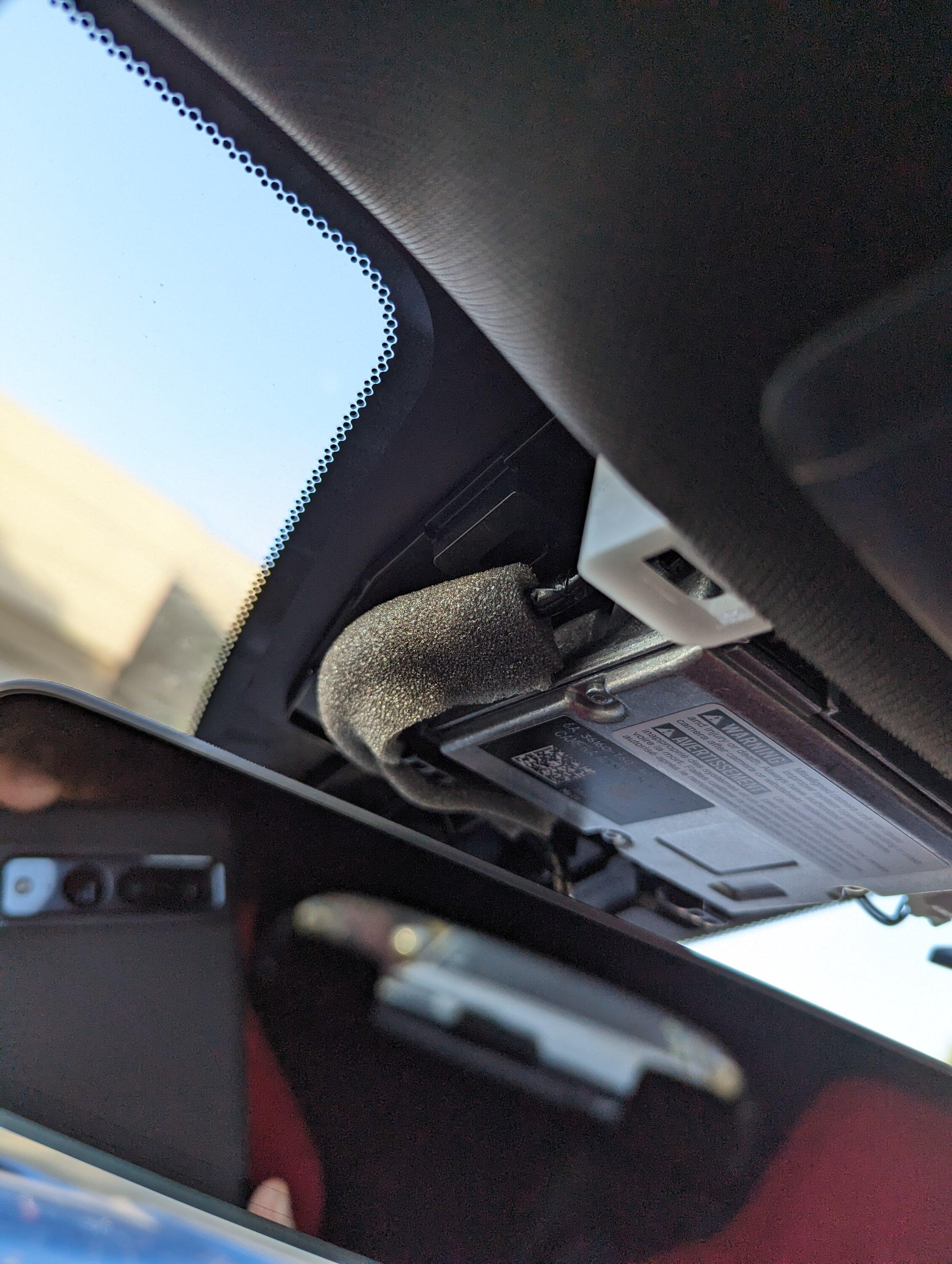

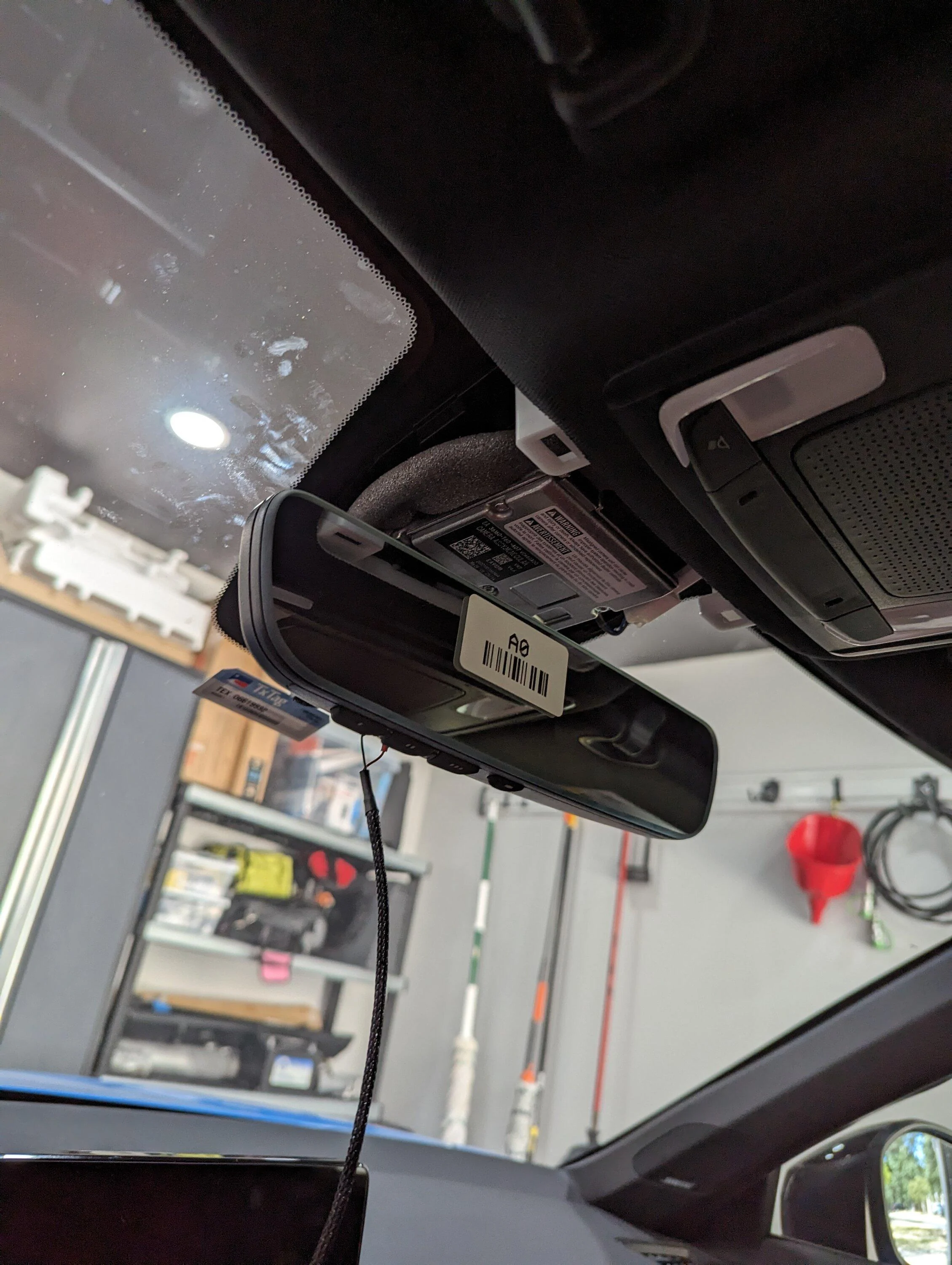

Thanks for the info! Just installed mine last weekend:
11th Gen Honda Civic Plug and Play Homelink Mirror for FL5 -- 1 Hr Install PXL_20230813_175551224.MP
Does anybody know where I could find more of this Honda cable foam (shown below)? I'd like to use it for my radar detector.
11th Gen Honda Civic Plug and Play Homelink Mirror for FL5 -- 1 Hr Install PXL_20230814_133400768
s2kdriver80
Paul
Nov 21, 2015
779
360
Could be a variation (thickness/length) of part number "06993-SA5-000" or "76258-TG7-A01". I would contact a dealer parts dept.
