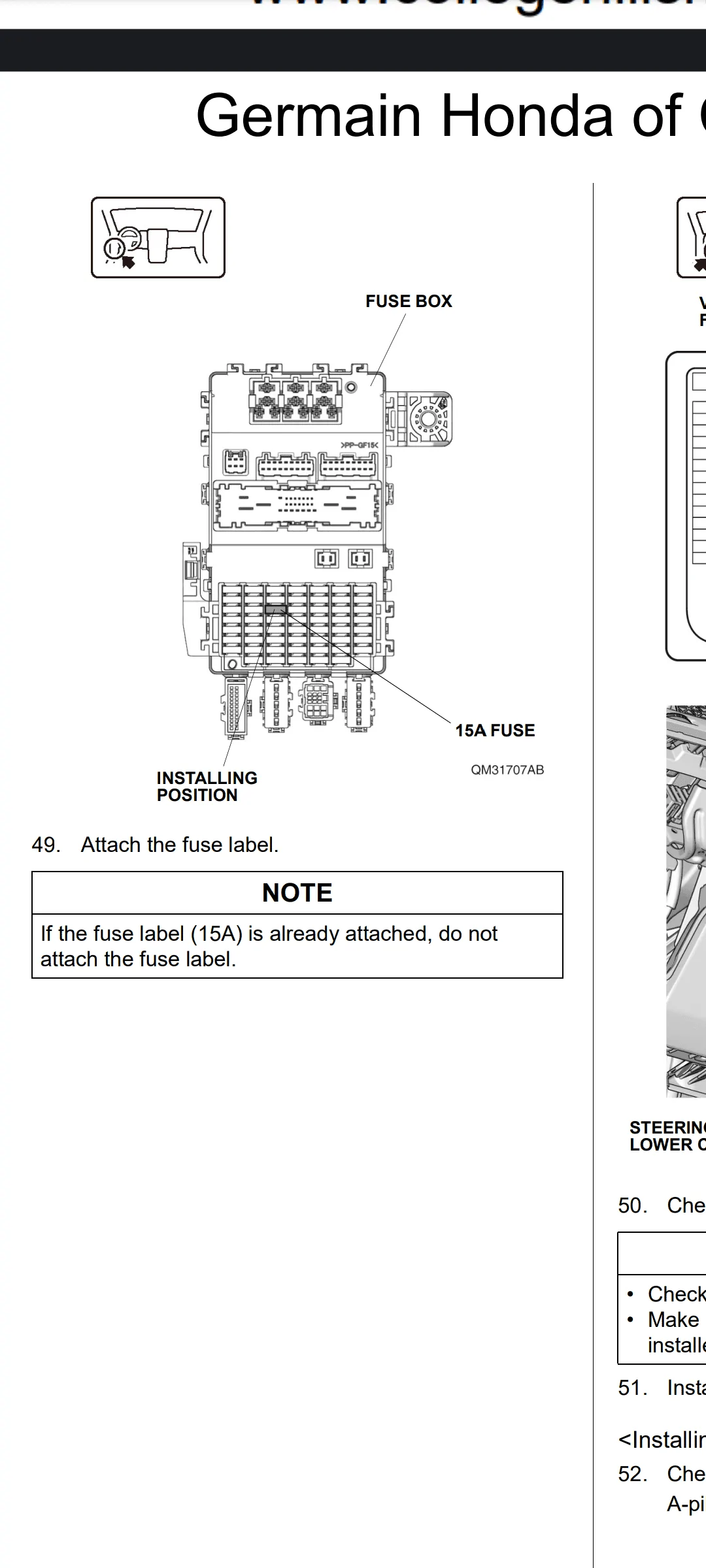

I am having an issue with the indicator light not working on my new auto dimming mirror. There is no green or orange light that emits from it while trying to set Homelink to work with my garage door opener.

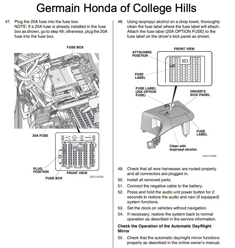

I saw that someone here said they were able to resolve the issue with these collegehillshonda instructions on step 47, but there is already a 20A fuse in that port.
getGroyped
Josh
Aug 1, 2023
48
37
Is home link supposed to just work? I don't get any lights on the mirror glass like seen on videos. Auto dimming mirror works.
EDIT: Fixed the problem. Installed the 15A fuse as indicated in step 49 page 26/27 of the collegehillshonda instructions
Thank you for commenting about this issue, I am having the same problem..
Could you tell us which instructions you are referring to? I found that the 2022 Accord PDF instructions mention a 20A fuse on step 47 on page 16, but my fuse box already has a 20A fuse there. The wiring hardness includes a 15A fuse but there is no mention of where to plug it in.
Go back and download the instructions PDF included in the OP of this thread. Scroll to page 26. That is the correct position of where to put the fuse. Not sure where you got the instructions you quoted, but it's very different from the OP.

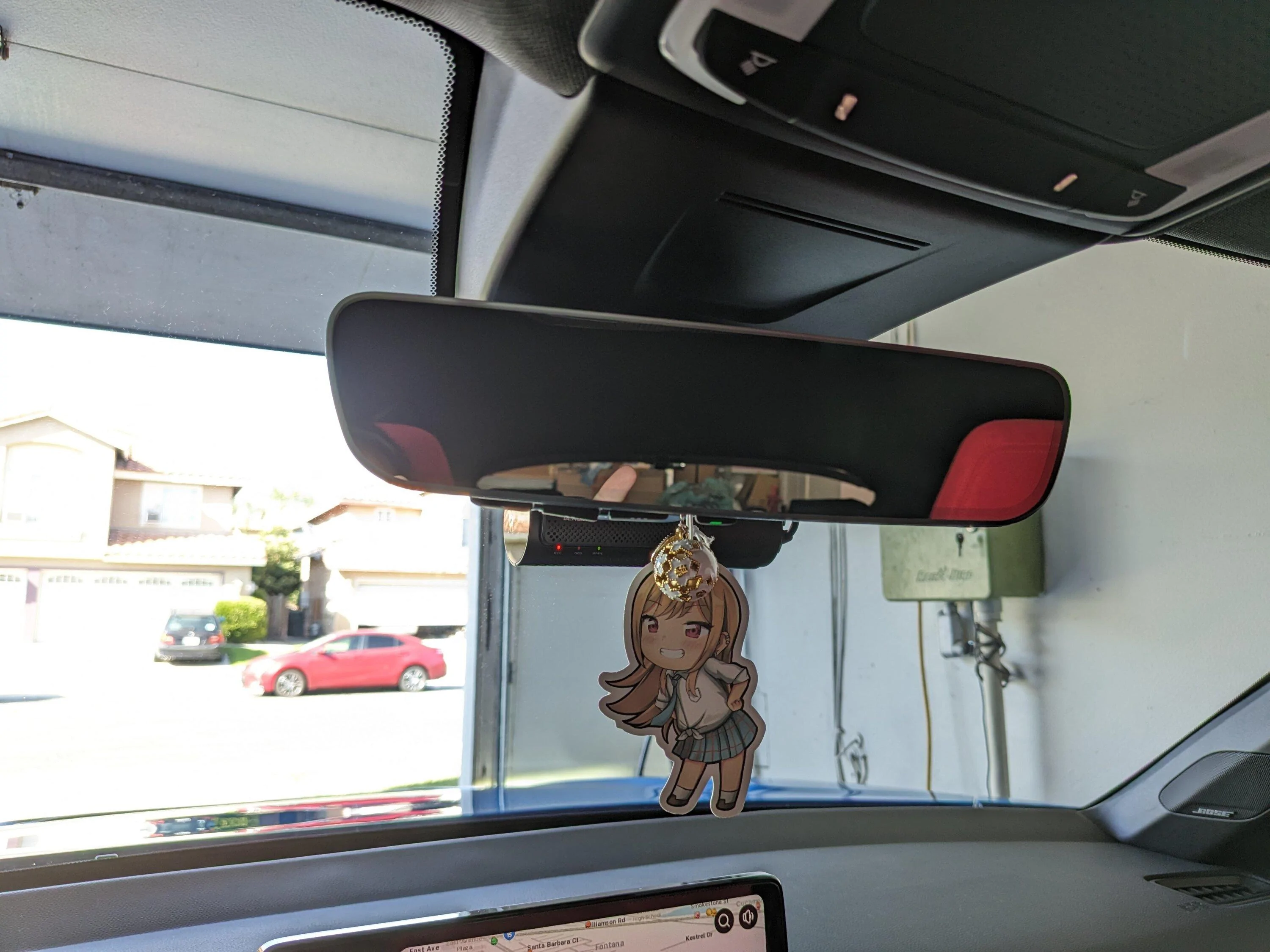

I installed mine a few weeks ago and it's great. Relatively easy to install. I rarely drive at night so I haven't been able to test the auto-dimming but homelink makes a huge difference for me in terms of convenience.
Now I'm wondering if the blendmounts will work with it for my dashcam.
