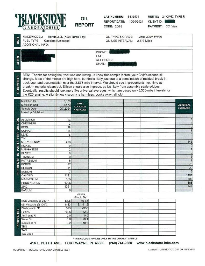

I got my used oil analysis back. This was from the second oil change after the break in oil was drained. This oil has 4 track days on it.
11th Gen Honda Civic PointByPatrol #21985 Build Journal! RIP #9243 1730319830043-776a1bfa-c0cc-4f66-846f-59927695f698_1
