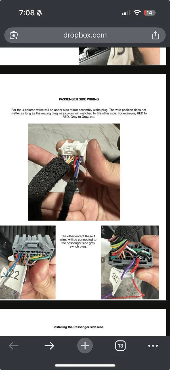

Do you have the pin out for that tilt wire? I assure you have to wire in 3 wires on the passenger side window switch correct?
dphunky
Mar 22, 2025
Bay Area
Mazdaspeed Miata, Ford Mach E
I don’t have the exact pin out but it shows in their instructions. The thing I messed up on was the wire colors in their pictures on the instructions didn’t match exactly my colors. So make sure to match the wire colors on the white plug as stated in their instructions.
