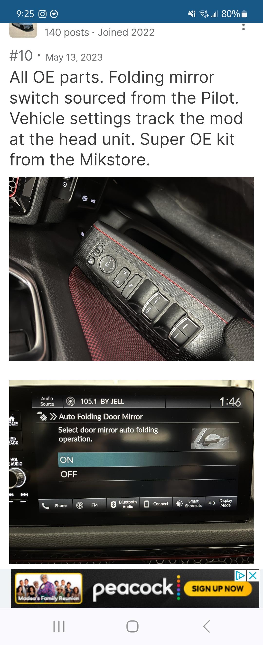

That link doesnt work and for some reason wont let me share it here- from another 11th gen civic forum... basically they installed the Mikstore "model C kit" on their 22' Si- said everything pinned into factory connectors except for 2 wires needed to be tapped... (theres instructions/pics posted I can post here if anyone would like) then the option in the infotainment for folding mirrors showed up in their settings

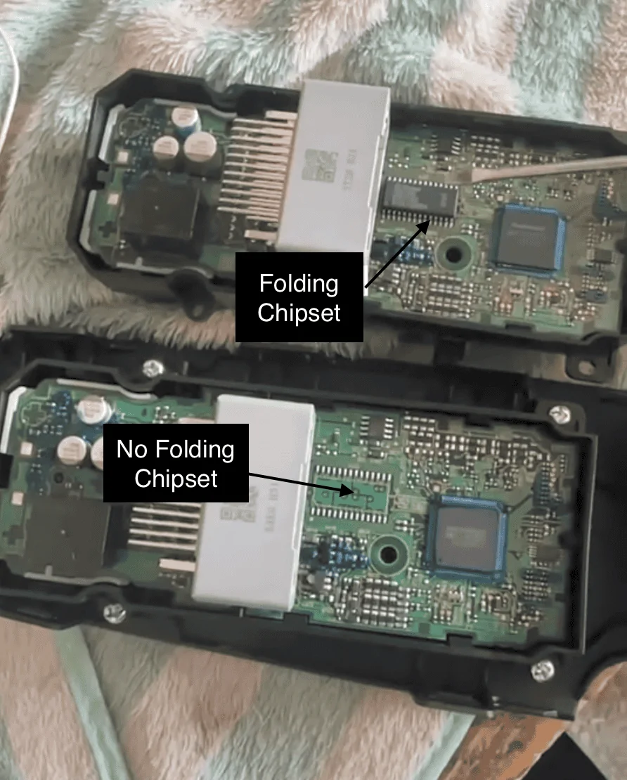

To get the OEM integration into the headunit looks like you will need the Model C or E kit from mikstore... now question is does the USDM FL5 come with that "chipset" with the auto fold function in it and we just got robbed of the folding function... or do we still need to purchase the C kit with everything...i'm going for easiest method here haha but would spend the extra cash for the C kit to do it right
