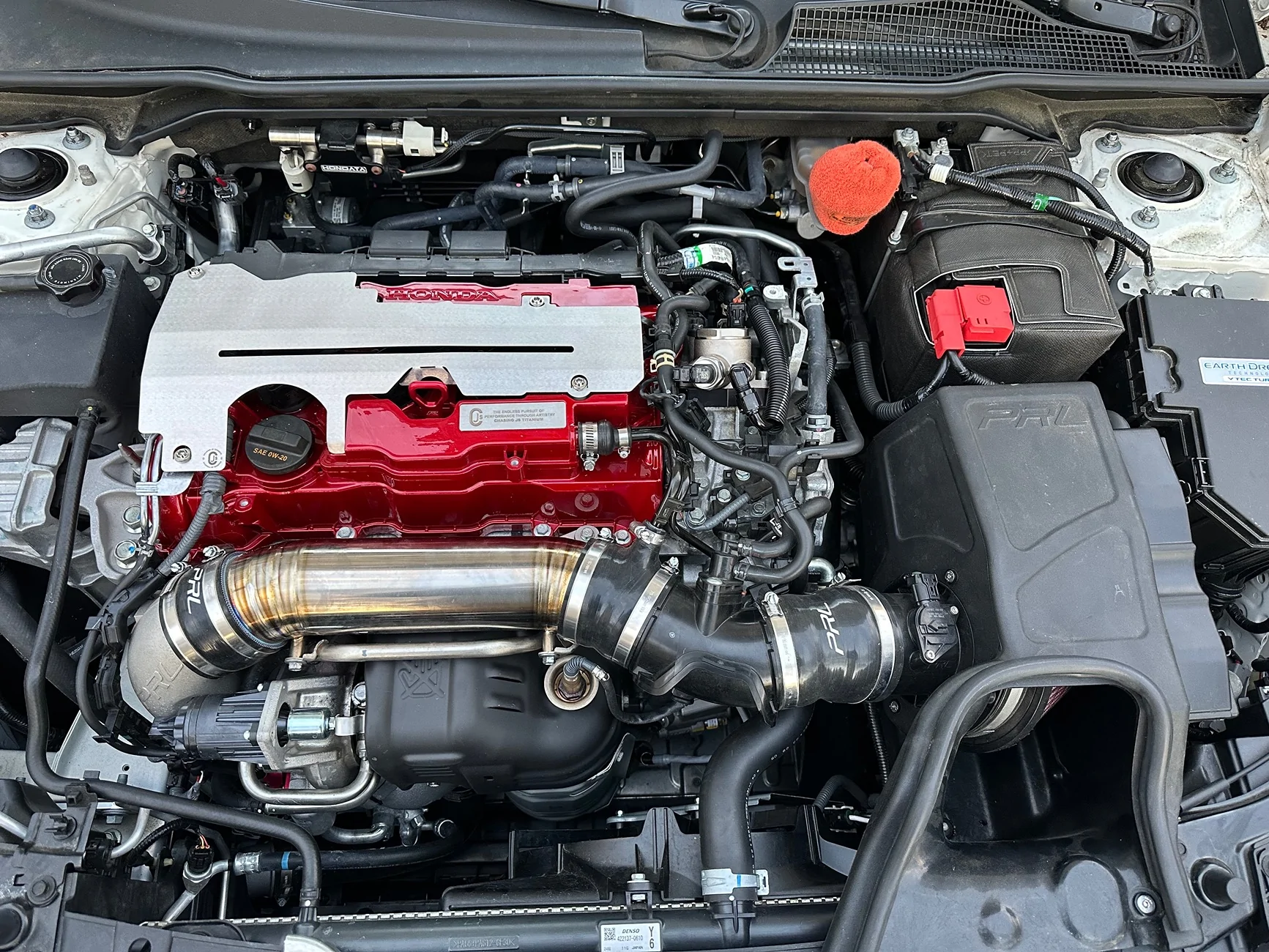

Intake has been proven to make substantial power gains on stock and/or built cars. Infinity Design seems to separate from the pack a bit here, at least based on some semi-scientific data-gathering procedures some Youtubers have gone through and documented, but also that could be me justifying dropping nearly $2k on it.

This is a pretty accurate statement, but as someone who just dropped the aforementioned $2k on an intake/inlet tube, you can notice that ~20 hp/30tq. Whether it's worth the cost is of course debatable, but it depends on what you're after. As long as you're not expecting earth-shattering acceleration, personally I was pleasantly surprised.
I've long maintained (and many agree) that the car makes enough power as it comes from the factory, but the little extra bump doesn't hurt anything. If you've got the cash. And there are far cheaper options than Infinity Design. Sort of like watches or suits or many other things; sometimes price can't be easily quantified by those who aren't willing to pay for things. Usually that won't stop them from chiming in though!
I am however still puzzled why anyone wants 500 whp out of these things though but that's a topic for another thread. ;)
