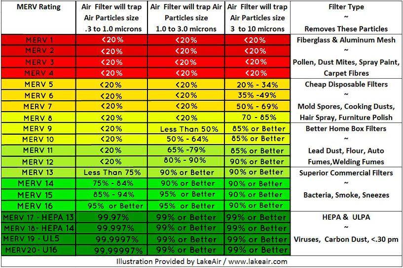

Does anyone know what filter is being used in this intake? I know it is this one from prl, but does prl themselves outsource these? The reason I'm asking is because in another thread on this forum people were comparing the filtration performance of aftermarket drop in filters ie. The Sprint Filter polyester air filters retain 93.13% of 100 ÎĽ particles (Sprint Filter P08 air filter) - 91.8% of 37 ÎĽ particles (Sprint Filter P037 air filter) - 95.22% of 100 ÎĽ particles (Sprint Filter P08F1-85 air filter) but how does the performance of this cone oiled filter stack up? The only mention i see on their site of filtration performance is where they say this cotton filter traps particles as small as 5 microns. Is there not a standard that these filters are tested to where similar to the drop in filters it will say a filtration percentage for defined particulate sizes? Also as far as I could find on various forums there were two conflicting mesh filter micron ratings people were throwing out for the oem filter either 10 or 20 microns. Ideally I would like to stick to as close of a filtration rating to stock as possible but with a dry cone filter that would fit on the prl high volume intake, any suggestions?

I work in HVAC Engineering and specifically airborne infectious disease mitigation where I deal with filtration media specs all day. BConlon is spot on with the concern and I agree. I want to make sure whatever is filtering engine air has the same arrestance value as OEM.

@Tickle I also reached out to AEM and a few other manufacturers via email. AEM got back to me with the following about their dryflow filters
Hello,
At this time, the micron rating test information about our air filters is not available. However, each AEM air filter is designed to meet or surpass the factory requirements of the vehicle engine manufacturer.
If you have any additional questions about our air filters not related to the micron test data, please feel free to reply to this e-mail or contact our customer service department at 800- 858- 3333 and a customer service representative will be happy to assist you.​
Thank you,​
I appreciate you checking! Does this mean you outsource your filters or that there is a different measurement method that you test to? I can try contacting the manufacturer if you do outsource and wouldn't mind saying who that was? ​
Brandon​
Hello,​
While all of our filter material is manufactured in-house, unfortunately we are unable to provide micron-ratings at this time.​
As I said in the above emails I don't know personally if their is a standard as to how filters are tested. If someone in here does I would love to know so I can pose the question differently to other manufacturers, but it did not seem like they were willing to give any data to back up the blanket statement claim that their products surpass all engine manufacturers which is hard for me to believe when they are not forthcoming about the data. Anyways sorry this wasn't useful towards getting an answer but I just wanted to put everything in one place in case someone was curious.

The AEM 2093DK filter fits the PRL HVI. Supposedly the AEM filters filter a lot better than oiled cotton gauze like the green filter that comes with the intake. However, the fact that AEM won't share any of that data makes me doubt them. If any of these filter companies made filters that actually work why wouldn't they publish the data?
