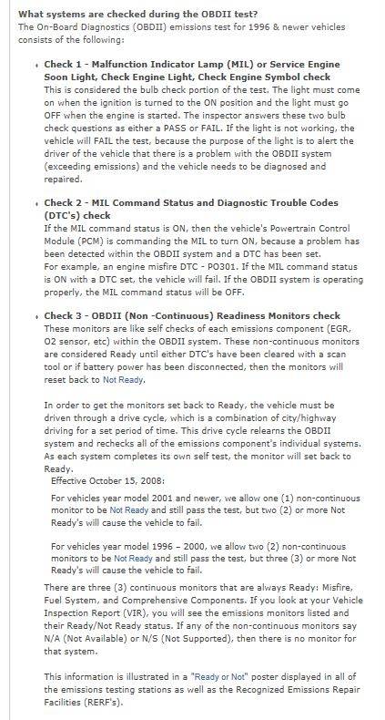

however if you want to be able to run the catted version to pass emissions, disabling the catalyst efficiency code will not allow the car to reach readiness state and you will fail... (assuming they do the obd2 connection test). there still may be visual testing as well, but there isn't here.

CEL is a non-issue. However you WILL NOT pass emissions as readiness WILL NOT set with a race downpipe.
This really sucks! I live in Florida so I can careless about inspections lol only thing I don't want my dash lighting up! Absolutely no work arounds for flash pro currently or in the future??
Just ktuner from what I hear.
