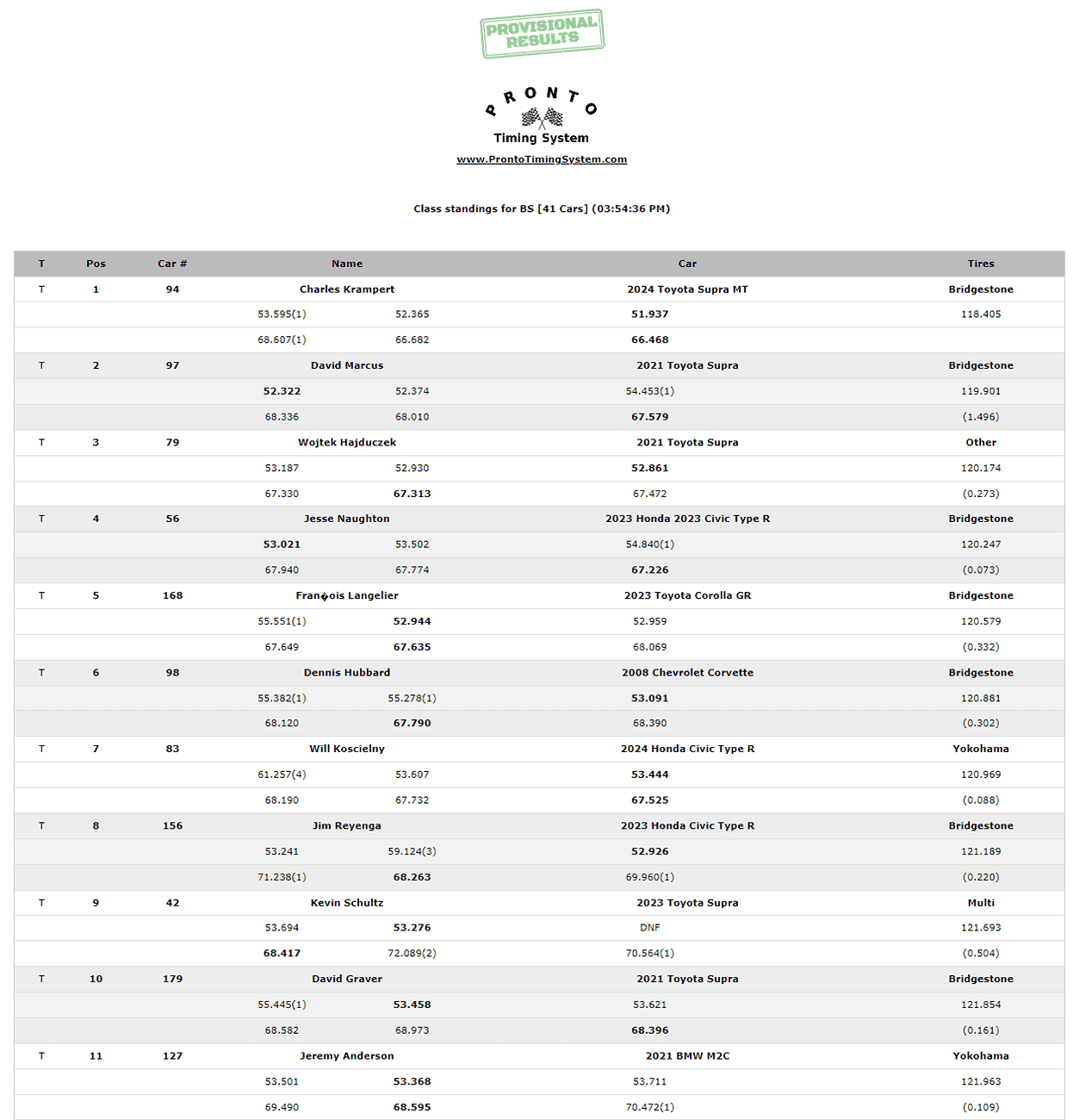

Nats Day 2, FL5's claimed 3 of the 11 trophies ? Great job all!
Wow the manual Supra is next level ?

I am the driver in car 156. I struggled to get on schedule day 2 and my codriver was on fire but I am really happy with the car.
Setup has been pretty simple. Karcepts thick bar in the back at full stiff, 275 bstones, zero toe front and rear. I still have the stock exhaust on it, it was like watching a Tesla leave the line it was so quiet.

Nice job for Jim and Jesse. We ran the thick Karcept rear bar at 3 and I still had the big moment on run 1 for me....I think next year I will actually play with rear alignment more....
Actually curious question, what did the car weighed in in the end in race trim? Mine never seen a set of scales yet....
