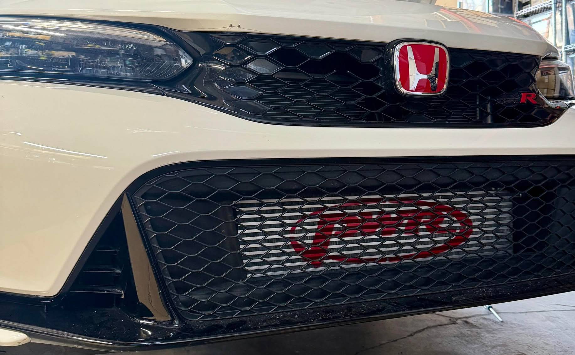

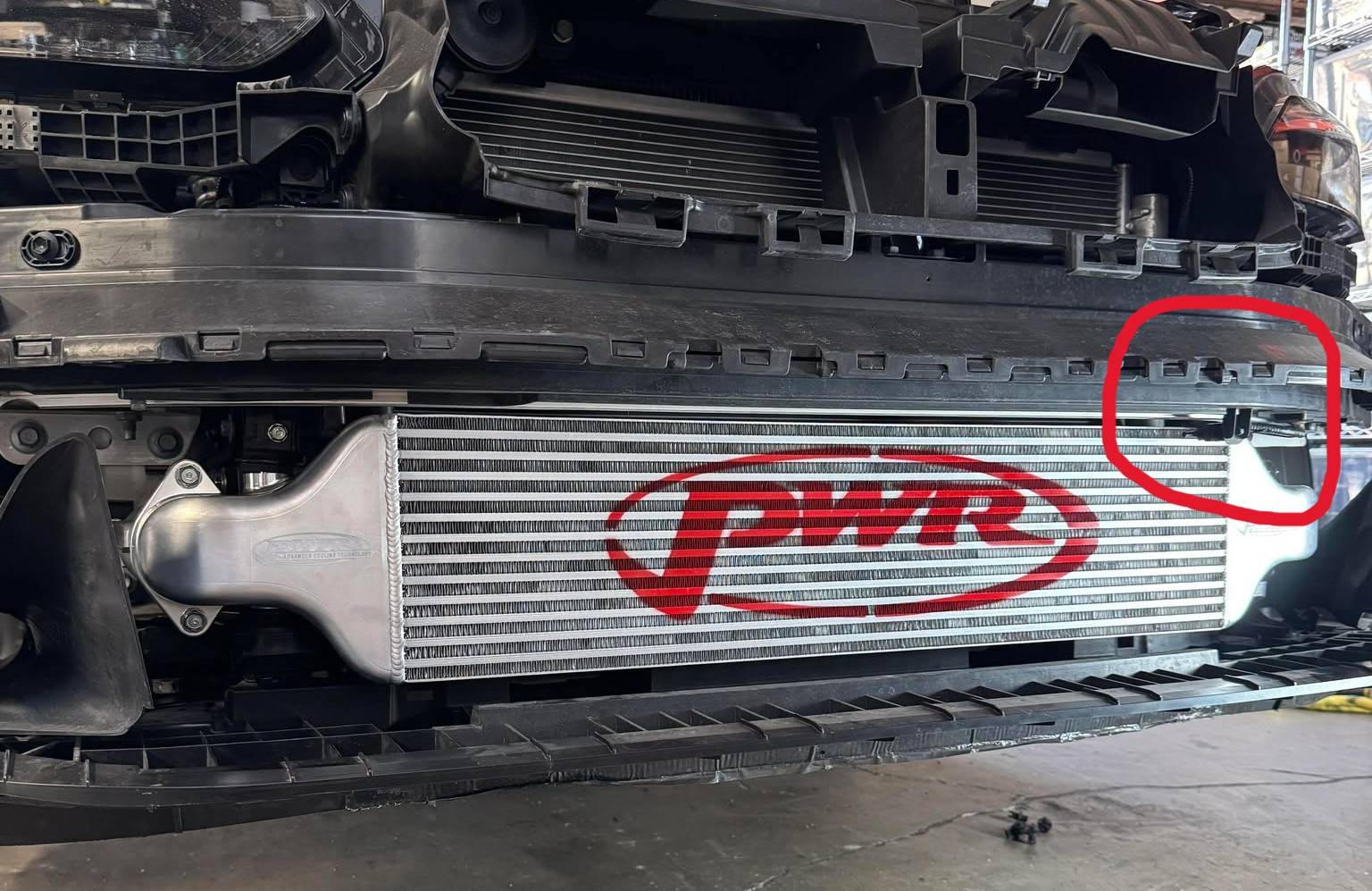

Picking parts that are legal for class is always tricky.
While it's pricey, the PWR intercooler does meet the letter of the rules, as the it fits with no modifications to the stock plastics, including the temp sensor mount. From what I see most of the larger ICs out there all require the temp sensor mount to be cut and sensor relocated, which is not allowed. The Wagner IC might be another legal option, but I am not sure what modifications to the stock plastics are needed for install.
Pics for reference and sensor circled in red

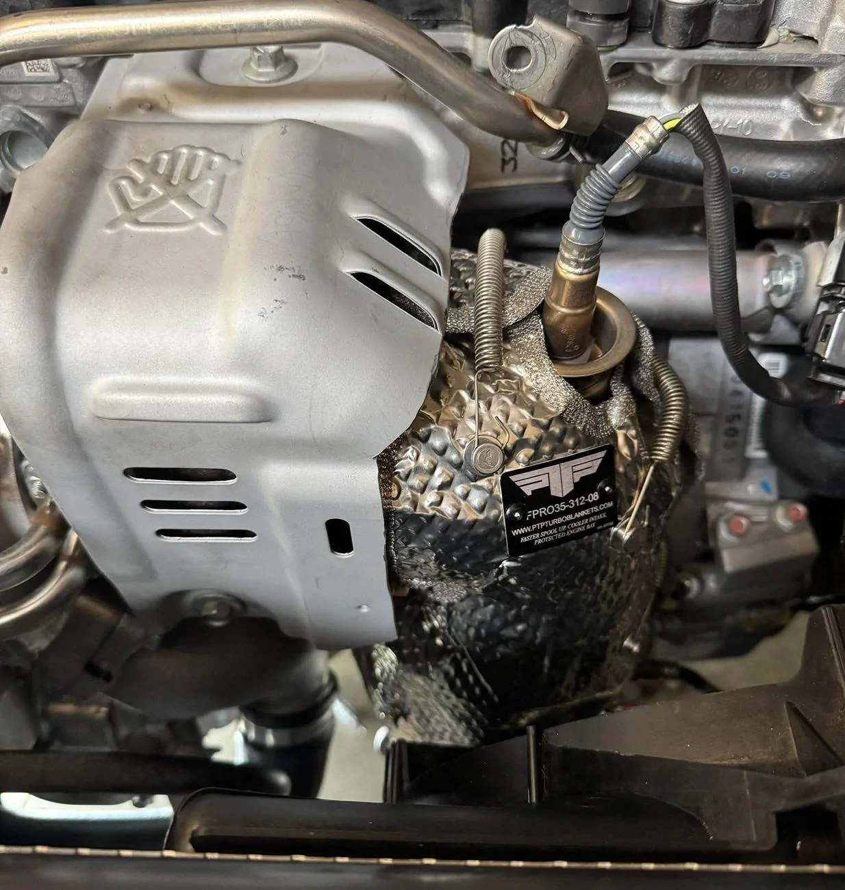

With the TSP downpipe potentially generating additional heat, I optioned for the PTP heat shield. While it seems to do a good job keeping under the hood temps down, you cannot fit the stock turbo shield around it.
Class rules do not have a specific allowance ("if it doesnt say you can, then you cant") for an aftermarket turbo blanket, but do allow you to modify the surrounding OEM heat shields to fit any heat shielding you do for the downpipe...so I took a cut-off wheel to the OEM turbo shield :rolleyes:
This is an example where I'd rather ask forgiveness than permission. Who's going to contest a turbo blanket? Although I do recall seeing something about the heat shield... I figured that was more related to aftermarket turbos. Maybe that's where you'd get a contest, is if someone thought you were trying to hide one?
Also though I highly doubt you'll run into heat soak issues during autocross... and TBH I've been skeptical of turbo blankets/heat wraps since the 90s. I've seen more personal anecdotes of them doing more harm than good than the other way around. Probably why I skimmed over the heat shield stuff when I was poring over the rules.
I flip back and forth between wanting to stay compliant and IDGAF. I'm drifting more towards just buying a Miata and getting serious with that.
Yeah basically destroying brand new components vs being able to replace is super lame :thumbsdown:
Some of the local SCCA regions I race with can get pretty strict and I plan to compete at National events, so the decision for me was pretty clear. Much really depends on the tribal culture of your local region and the attitude of your fellow competitors....especially if you start winning :rolleyes:
So the turbo blanket thing got successfully protested a few years back at Nationals with an Fiat 124S in STU iirc, so there is precedent against it.
Heat soak during an autocross run is unlikely, but if ProSolo somewhat possible? My desire mitigate the heat from the downpipe was more a concern with all the plastics in the area as I will occasionally mix in HPDE events too.
Yep, it's more to protect the surrounding elements, I get that. I just also recall coking issues from the 90s, but fortunately that is one of few things that has actually improved since then ;).

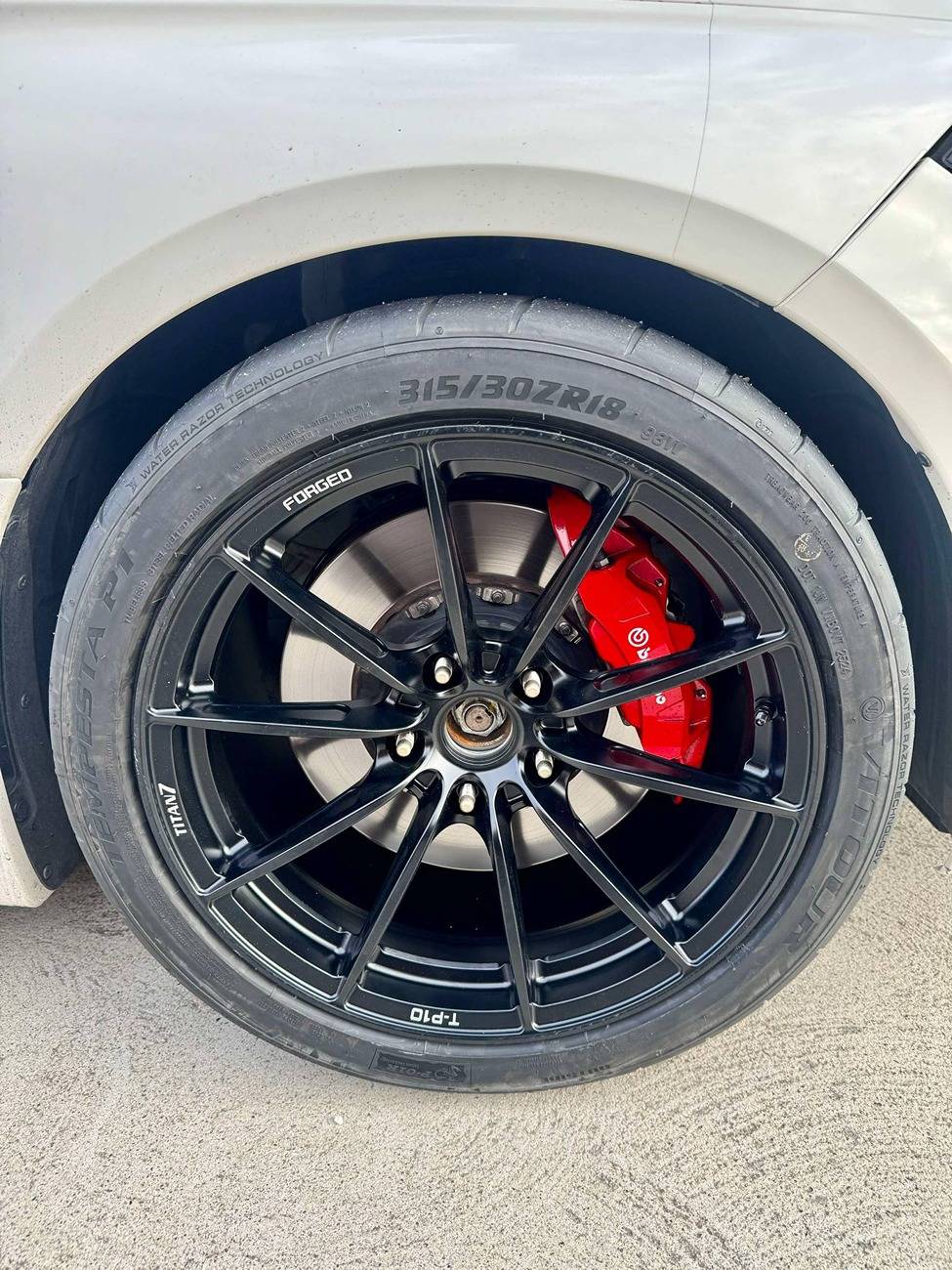

So 315s fit in the front 😁
(I did not check fitment for the rear) While no rubbing so far on Stock suspension, I might need to use wheel spacers with coilovers.
I didn't realize with them moving most of the T3 cars to T2 that they kept the old tire widths for T2. This is interesting
This is an absolutely nutty amount of tire that can fit
