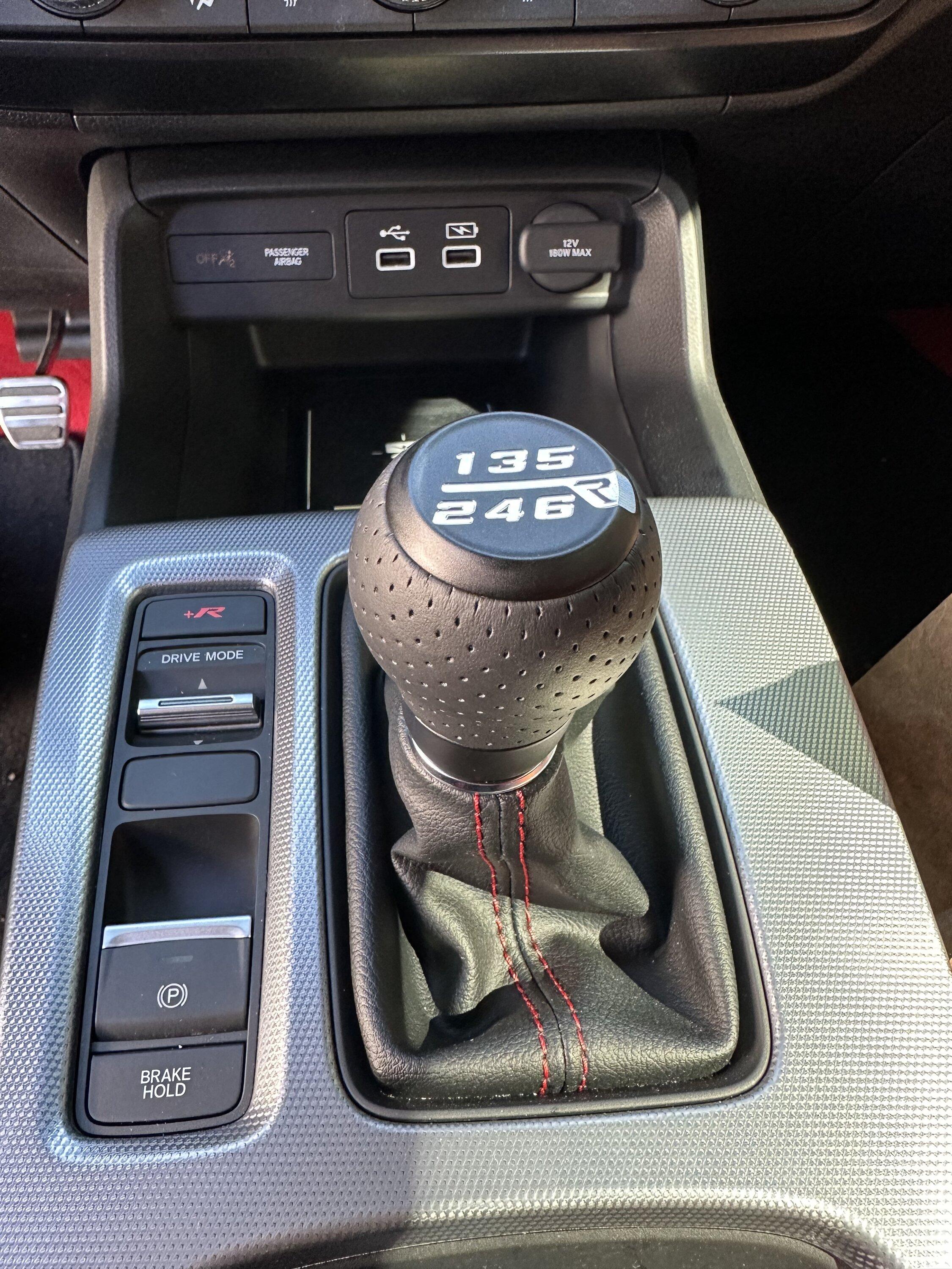

Once again, thanks for the help. I saw what you meant by the curved lever blocking the boot collar. Got a slightly longer screw and fixed the problem.

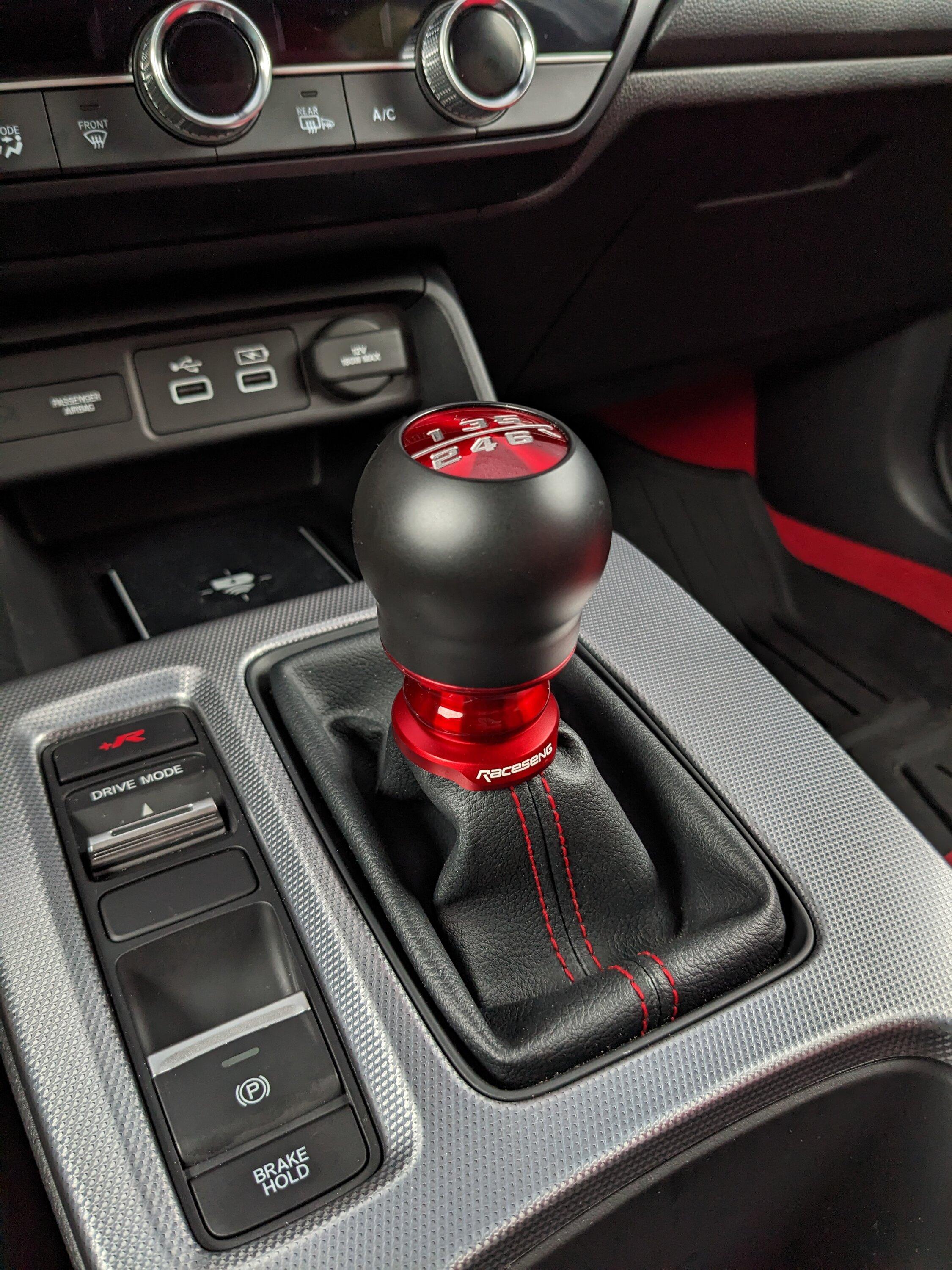

So here's the final product
11th Gen Honda Civic Shift Knob installation on FL5R PXL_20230328_205345011

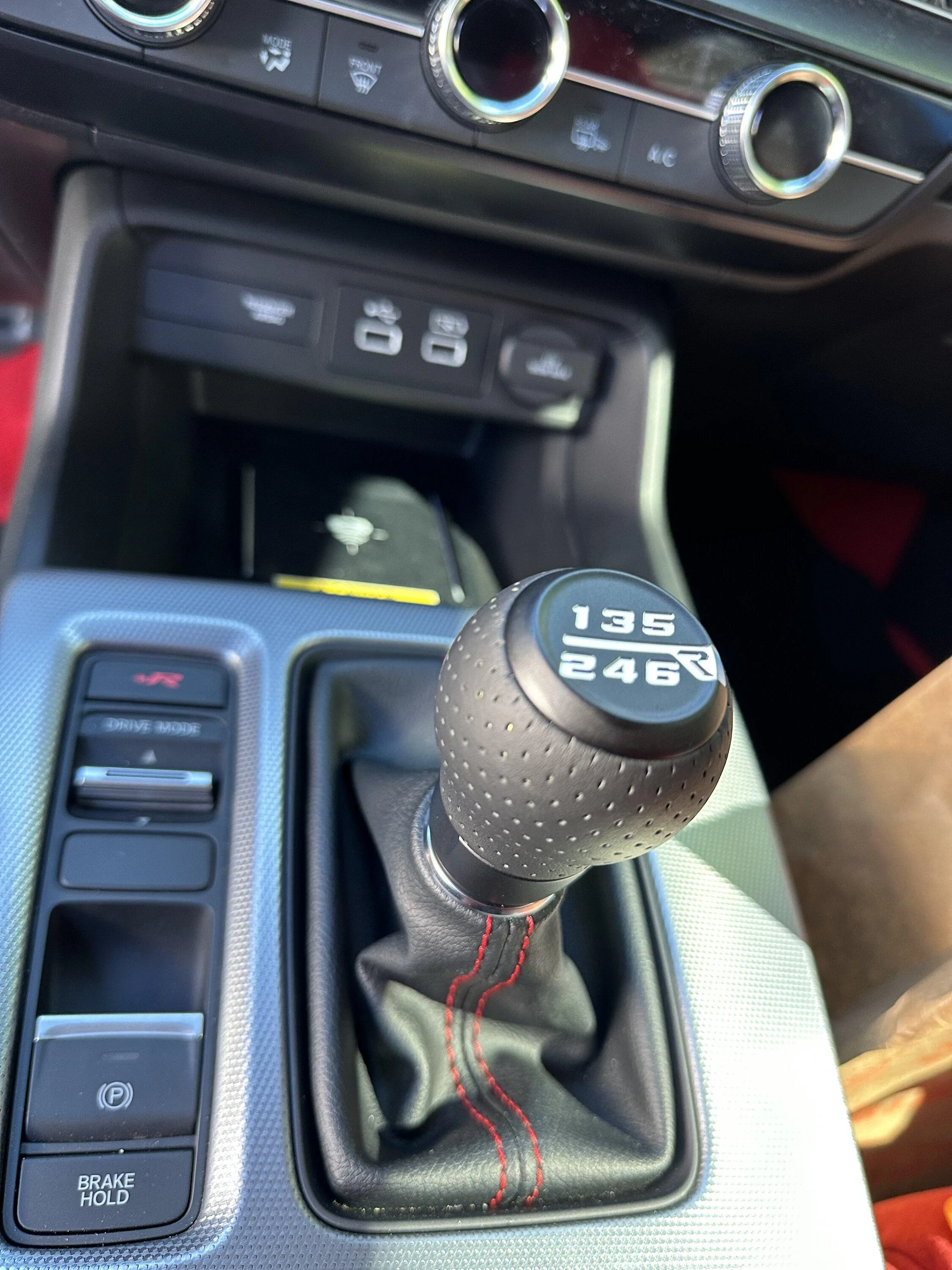

I'm having this exact same issue with the screw that goes atop the adaptor. I'll be heading out in the am to Home Depot to find that Allen screw. Hopefully I can find the sizes I need, and finally get this Raceseng Shift Knob installed. Thanks for handing out the info!
11th Gen Honda Civic Shift Knob installation on FL5R IMG_3083

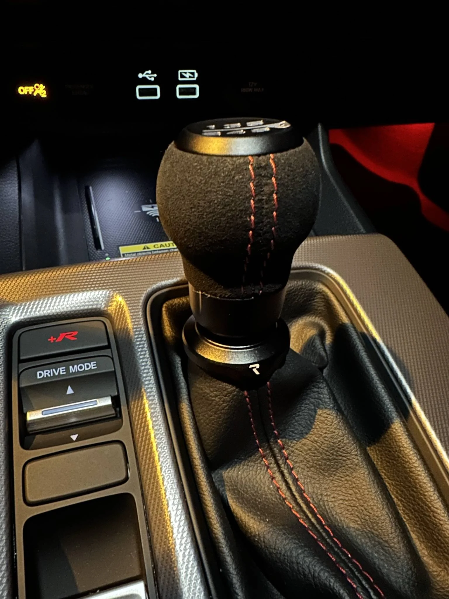

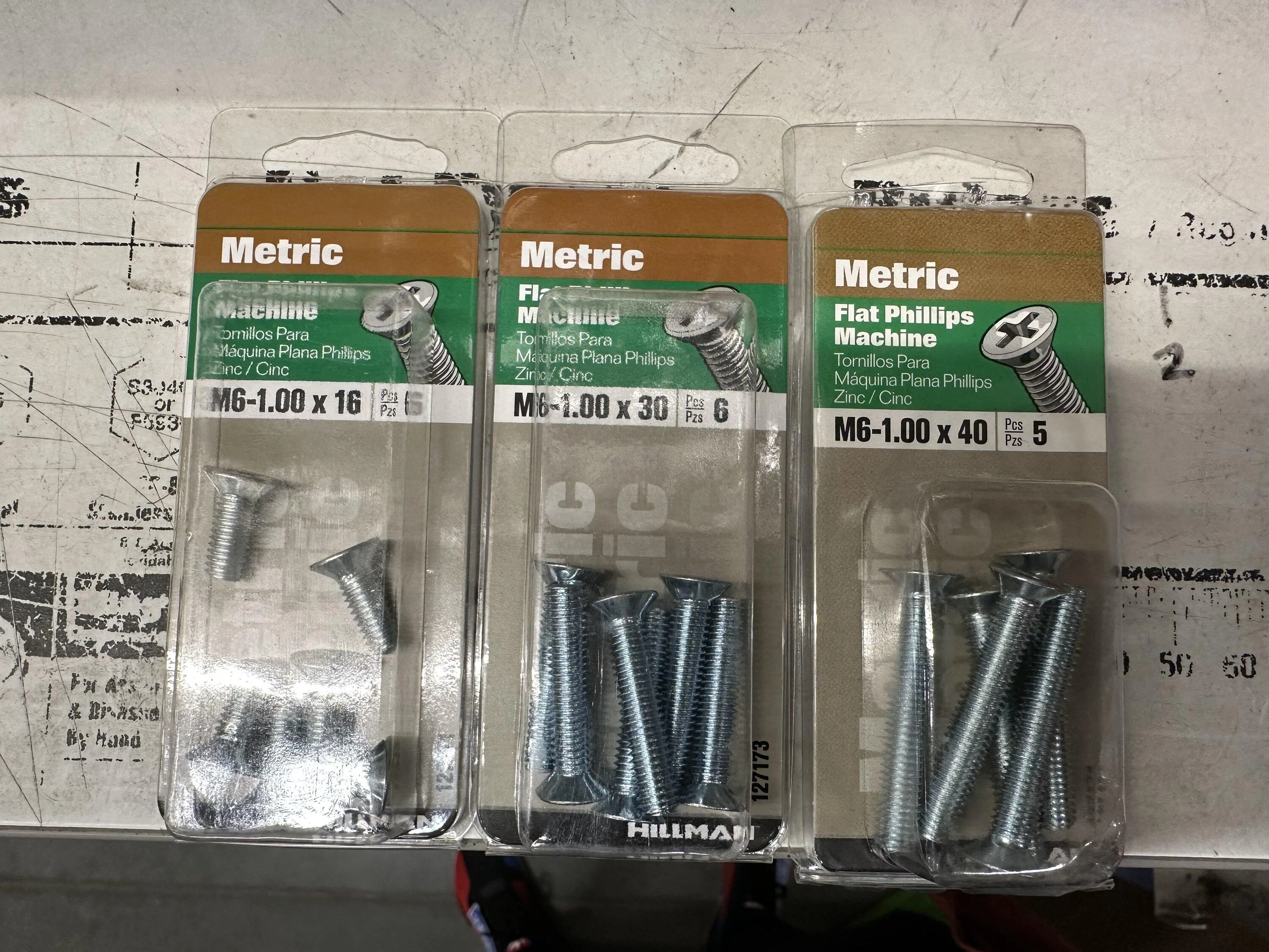

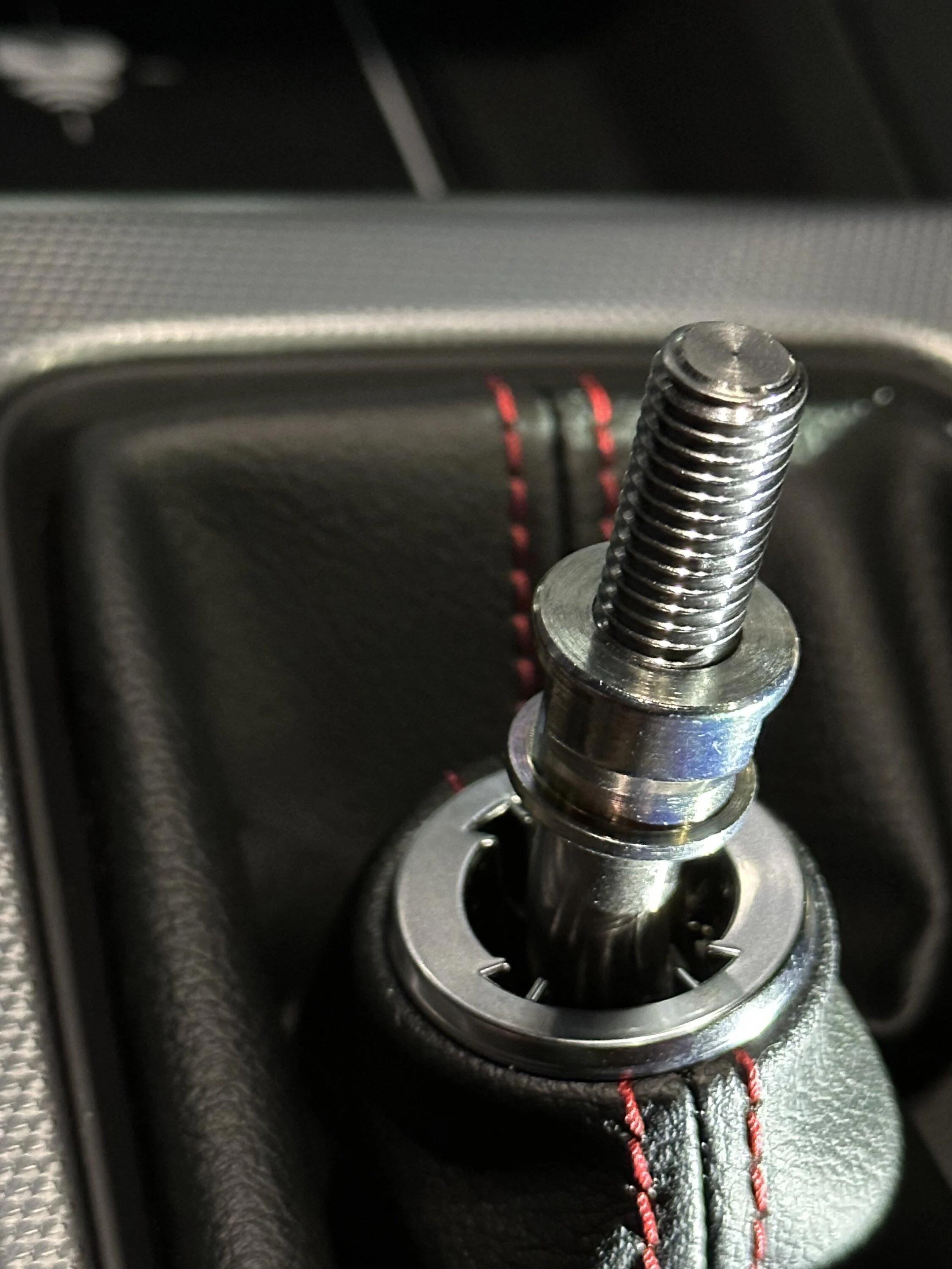

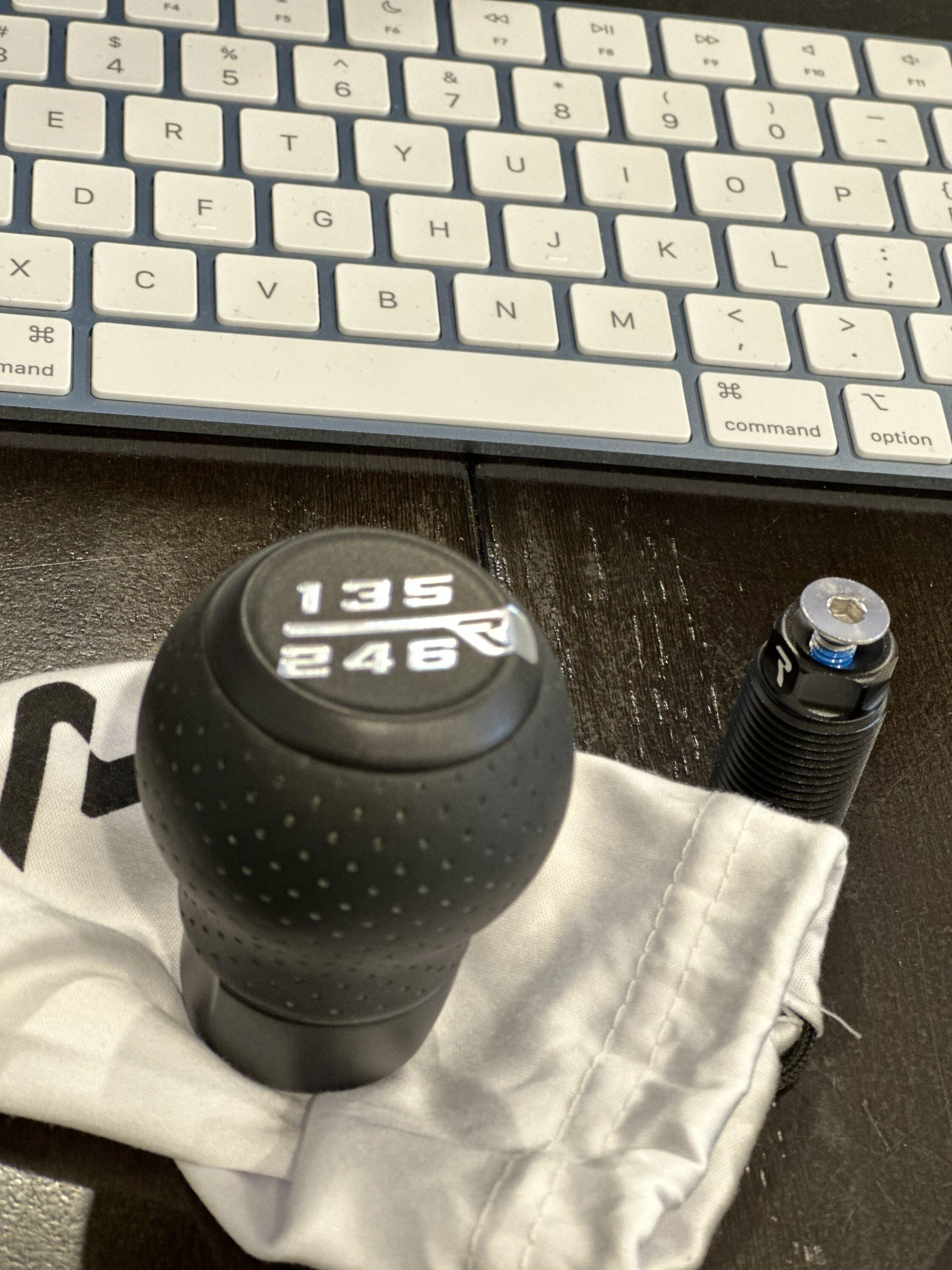

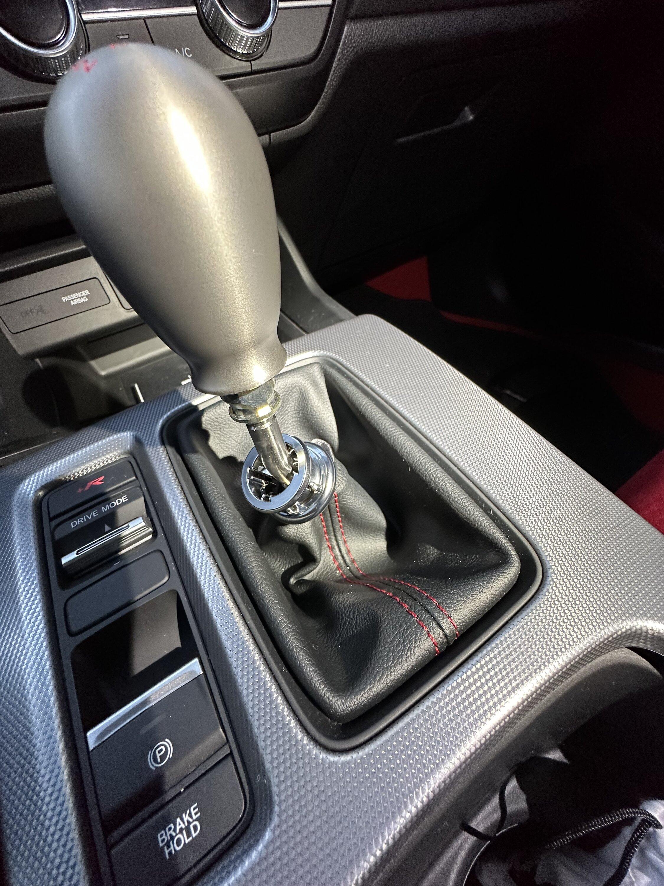

Finally got this mod completed for my fl5, thanks to all the info and videos provided by elusiveaura and others in this thread. I just wanted to piggyback on what you've said about the install, and give a more in-depth description of my own experience installing the Raceseng shift knob with the threaded adapter. I'll try to give as much detail as possible. It was a two day long project, while running around from Home Depot(which closed 1 minute before I got there that night lol), on to Home Depot again the next morning, only to find they didn't have the correct metric screws that I needed. I was then off to Lowes after that, and they finally had the right size screws to get the work done. I chose to keep the stock collar as I felt that it gave it a more retro look, similar to the leather shift knobs from 80's Sports cars, like the Toyota Supras back in the day. Just my preference.
11th Gen Honda Civic Shift Knob installation on FL5R IMG_3077
11th Gen Honda Civic Shift Knob installation on FL5R IMG_3082

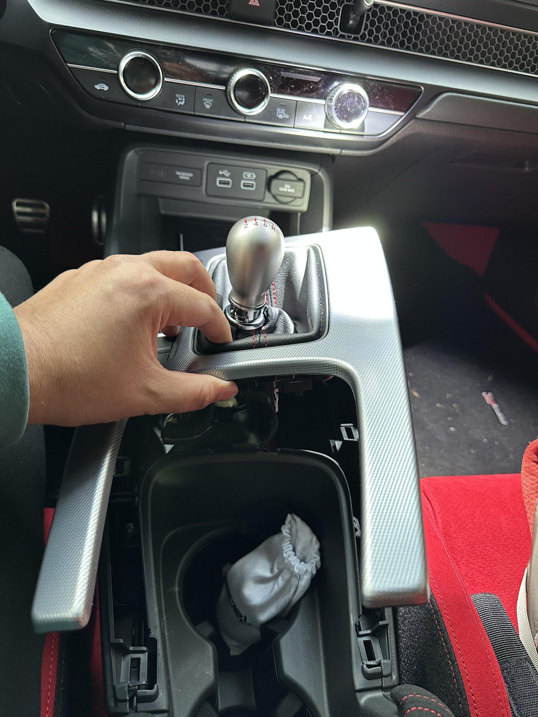

1. For those unfortunate enough to not be able to push the boot collar down(like my situation), you'll have to pry open the gray/silver console cover off with plastic tools to keep the part from being damaged. Next you'll cut off the white low profile zip tie holding the leather shift boot to the collar. Make sure to purchase a "low profile" similar sized zip tie, as the regular ones create a noticeable lump at the collar once you re-zip the boot to the collar. I had to do this all over again because of that issue. You can get them at O'Reilly's, or other automotive parts suppliers.
11th Gen Honda Civic Shift Knob installation on FL5R IMG_3087
2. At this point, you will have complete access to the collar. I may have over complicated this part of the process, but I had to loosen it with a small Allen tool that I heated on an open flame, bent the very tip of it, and pried the collar coupler open to get it loosened and it slid down. I recommend setting the collar retention screw that requires a 14mm wrench to its lowest point, so as to have the shortest height for the aftermarket shift knob.
11th Gen Honda Civic Shift Knob installation on FL5R IMG_3099
11th Gen Honda Civic Shift Knob installation on FL5R IMG_3106

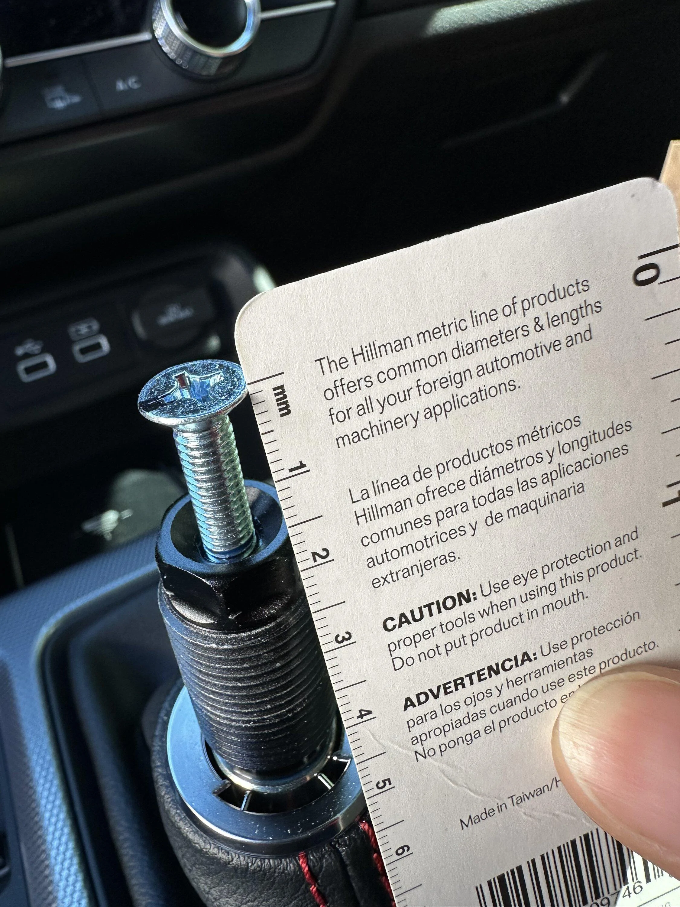

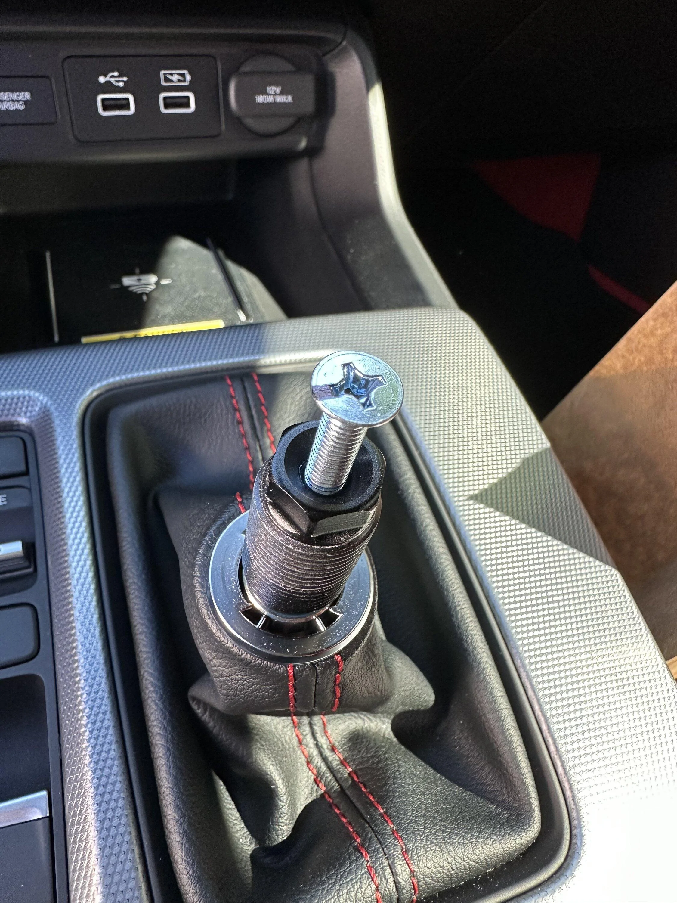

3. After getting a small assortment of machined screws from Lowes(I love that place lol), and testing which length screw worked best for my application. I chose a M6-1.00 X 30 Flat Head machined Metric screw, it's a quality item. It was perfect for the height that I wanted, while still keeping the stock collar snug without unnecessary pressure on the plastic piece.
11th Gen Honda Civic Shift Knob installation on FL5R IMG_3120
4. Finally, do yourself a favor and mark the top of the screw for reference, it'll help greatly in making the final adjustment to get the shift knob tight and lined up correctly. I set the screw to stick out by 1.5mm from the threaded adapter to the top of the screw. My OCD wouldn't let me do it any other way. lol
11th Gen Honda Civic Shift Knob installation on FL5R IMG_3163

I love the look and feel of the Raceseng shift knob! Quality product, with a nicely machined top surface, and retro perforated leather styling.
11th Gen Honda Civic Shift Knob installation on FL5R IMG_3175
11th Gen Honda Civic Shift Knob installation on FL5R IMG_3174
11th Gen Honda Civic Shift Knob installation on FL5R IMG_3197
