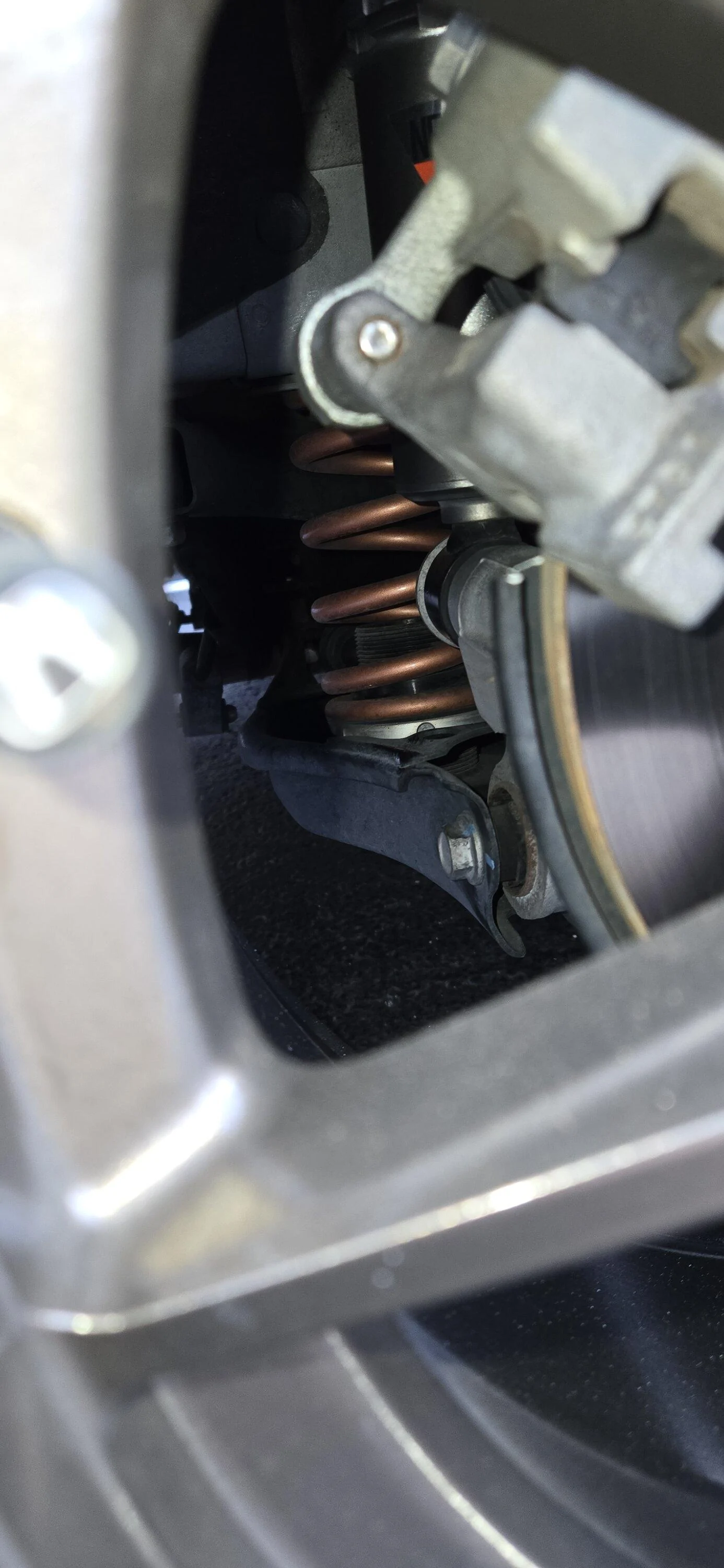

Yeah I know. I've just been trying to get it dialed in correctly for the height and the damn thing keeps clanking like the spring is still loose. Just adjusted them again down to get more preload but apparently it's not enough. Well shit it looks like I have the spring upside down again. FUCK! Their main videos show it with the adjuster towards the top.

Here is the picture of the rear spring, I can't take a picture of the shock itself without lifting the car.
