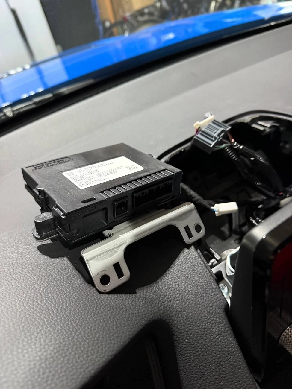

Any reason to physically remove the TCU vs simply unplugging it? Or is just easier to unplug with it pulled out?
I think they are effectively the same. Unless you think someone could plug it back in without you noticing.

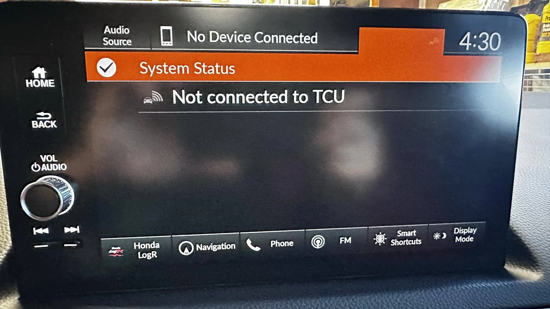

I have no clue about how the audio and TCU software functions specifically in terms of caching data. But we do know that it appears to only be a modem for data collected on the YB-CAN bus by the audio unit. Thus its not the TCU that is collecting the data, its the audio unit.
I also would bet that normal interruptions in cell service are anticipated by the manufacturer. People do drive in areas with no coverage and can go into above or underground parking without coverage on a regular basis. Thus, I would expect it has some ability to cache data and send it when the service comes back up. Since that data could be just text tables, at a minimum, it doesn't take much space. Additionally, multiple hundreds of Gigabytes of micro SD size storage is dirt cheap I would imagine it could store several months of daily driving data before filling up if that is all it is.
With that in mind I would hate for a service tech to just go plug it in during a normal service thinking he is doing you a favor and then you just wasted months of effort, that could have been avoided, if it uploads gigabytes of cached data. You can minimize that risk a lot by just removing it from the car as I don't think a tech is going to just go get another TCU and install it without you buying it. So I would just remove it altogether.

Plenty of reading and even more if one cares to dig into the Kyocera AL-T52V1-1 telematics module.
Once the weather warms up, I'm going to see if I can remove the TCU from the car to yank out the transceiver antennas.
There is not much beyond technical specifications that I was able to find for this item. Since its basically just a modem I think the better research would be into exactly what the audio unit is aggregating before it sends it to the TCU. I also saw a mention of a body control module that links to the bumper sensors and blind spot sensors. That may also be the central unit for aggregating sensor inputs.

Yea, the Kyocera AL-T52V1-1 is the "TEL/GNSS Module (Network Access Device)" chipset installed on the TCU circuit board. No need to research the NAD once the TCU is removed.

Interestingly I got an email from Honda yesterday about what to do about being in a collision. Touting the fact that Honda part are best. I found it very odd this occurred mere days after I removed the TCU.
I received the same email and I haven’t yet removed my TCU. The battery has been disconnected for months because the car is in storage. Maybe that had the same effect if it’s not communicating with Honda, but more likely they just sent a mass email to Honda owners.
