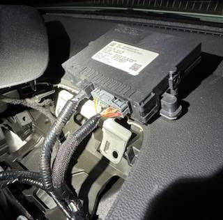

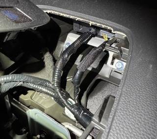

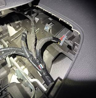

Super easy removal of the TCU. Use a plastic pry tool to remove the center speaker cover (5 retaining clips) to access the TCU:
11th Gen Honda Civic Spying on you? 1741323313454-29
Remove the two screws on the metal mounting bracket to pull out the entire unit:
11th Gen Honda Civic Spying on you? 1741323619734-tm
Disconnect and tuck harness connections (temporary solution):
11th Gen Honda Civic Spying on you? 1741323673696-s2
Reinstall center speaker cover and you are done. No more cellular communications beaconing back to the mothership.

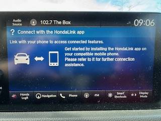

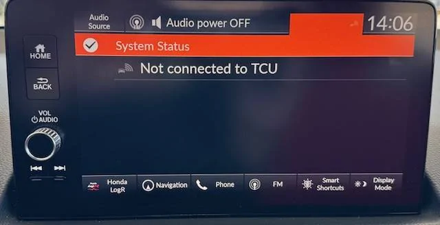

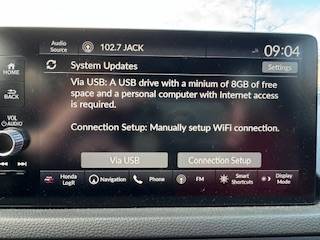

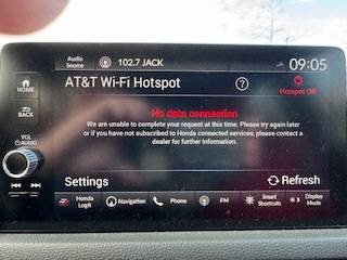

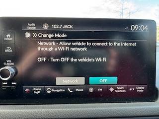

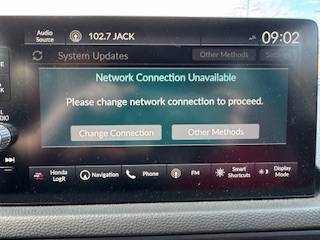

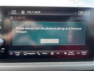

No unexpected issues at all. Everything still functions normally, navigation, traffic maps, etc. Occasionally after startup, you'll briefly see a red satellite icon appear on the top right of the screen.
With the TCU removed:
  • The vehicle is no longer pushing data to the cloud.
  • If you have the HondaLink app on your phone, it and the mothership can no longer see the vehicle (e.g., vehicle recovery feature is lost).
  • Obviously, WiFi Hotspot no longer functions as there is no cellular modem.
  • You lose the ability to receive notifications of system updates that are sent via the cellular connection. Instead, you'll have to occasionally connect the car via WiFi to check/install updates or install updates via a USB thumb drive.
  • I would not recommend connecting your phone to the vehicle as that would offer a secondary communications link back to the cloud and mothership.
Here are several PICs:

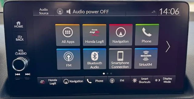

Both! ? Thank you for the information! Everything in the infotainment and CarPlay/AA still work normally without the TCU connected?
Yes, CarPlay and AA still work perfectly fine if you have those connections configured.

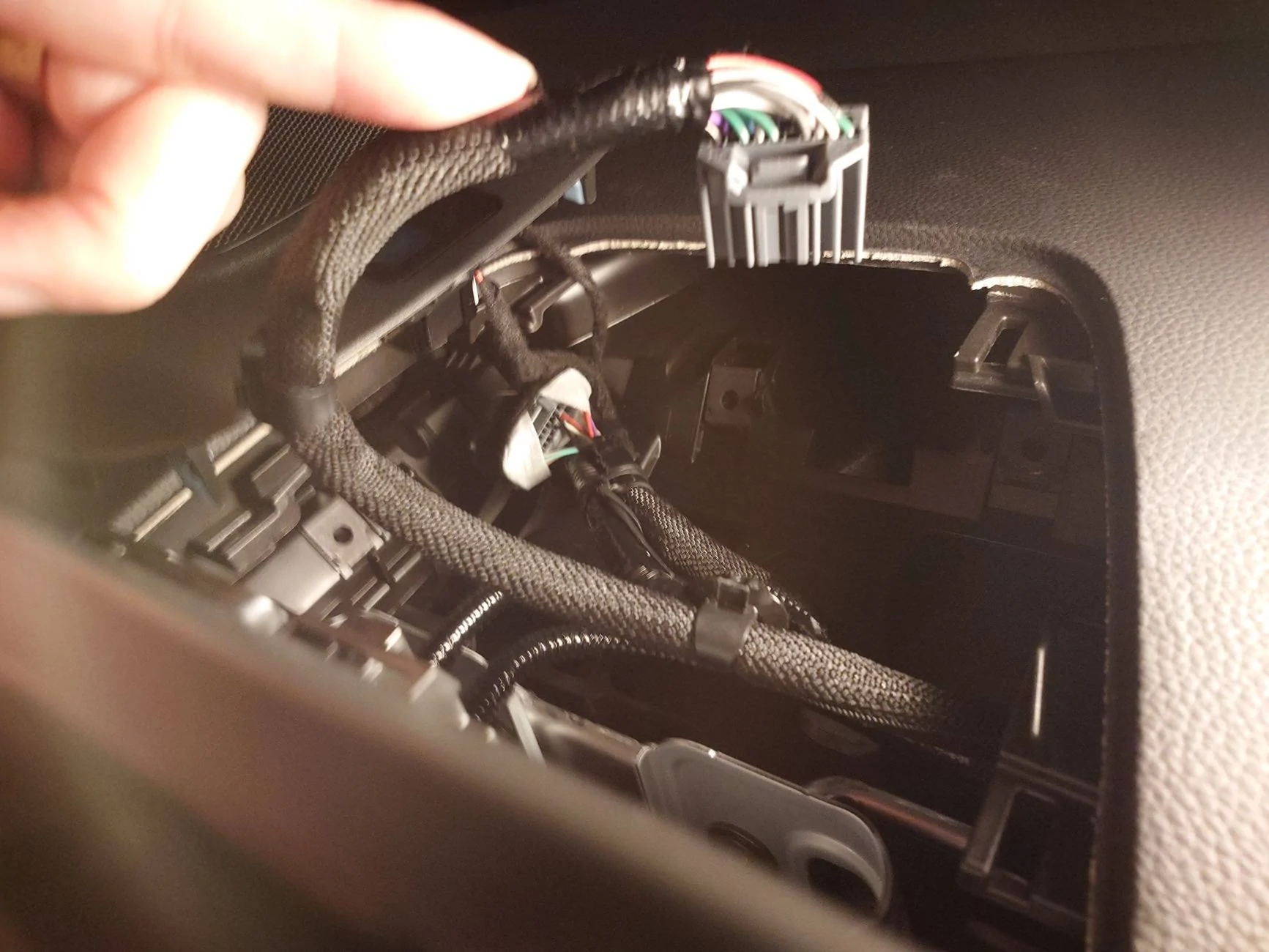

My small contribution: If you decide to remove the ASC completely from your car, you can route the ASC cable up to the hole behind the screen and tie up all three cords together to prevent rattles.
