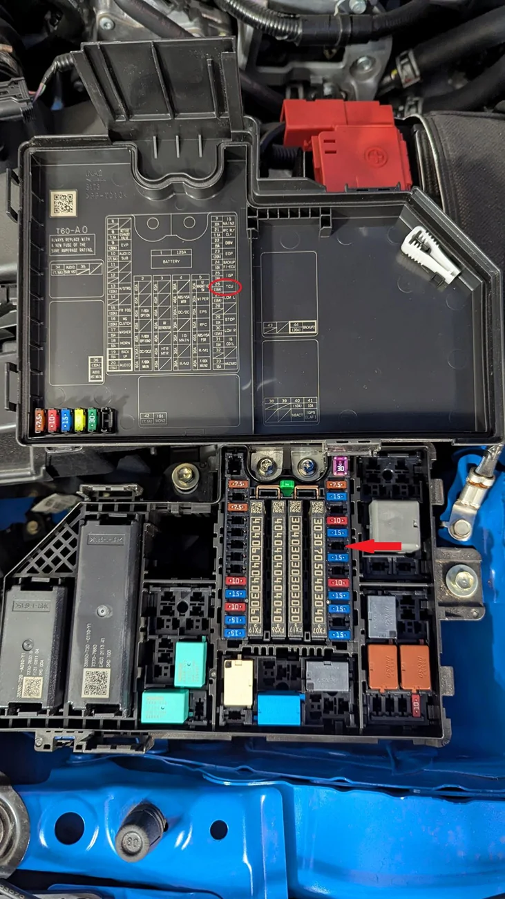

I found a fuse (#26) called TCU in the engine bay fuse box. However, it's uninstalled from the factory. If so, why is my TCU still working perfectly fine?
Probably a generic fuse box and the TCU in this car doesn't have a dedicated fuse.
