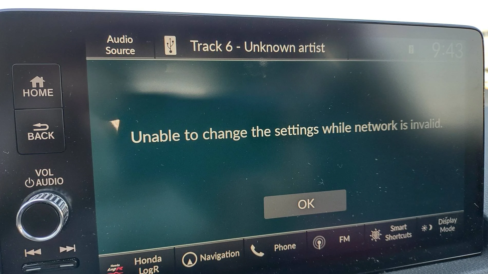

Something I found out the hard way.
If you remove your TCU, make sure your sharing data is set to off, and then don't touch the darn thing ever again! If you turn it back on, you won't be able to turn it off again. It will give you a message: "Unable to change the settings because the network is invalid" I was toggling around and accidently turned it back on for a second, then I couldn't turn it back off until I plugged the TCU back in and browsed out to settings where it allowed me to turn it off again.
