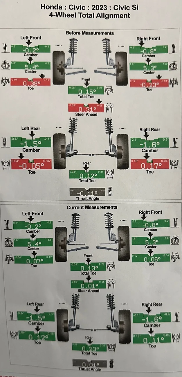

How does my alignment look?
11th Gen Honda Civic Steering not returning to center smoothly, notchy- long sweeping turns alignmentcivic2026

just got my car back with the updated rack. A15. Steering feels MUCH tighter. Feels brand new again and all the slop is gone. Real glad I had it replaced.
and the issue with the steering tugging on long sweeping turns is gone as well.
That’s great news, man! Happy for you!
