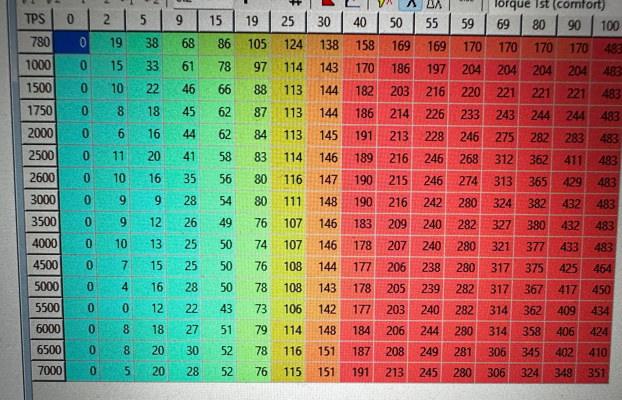

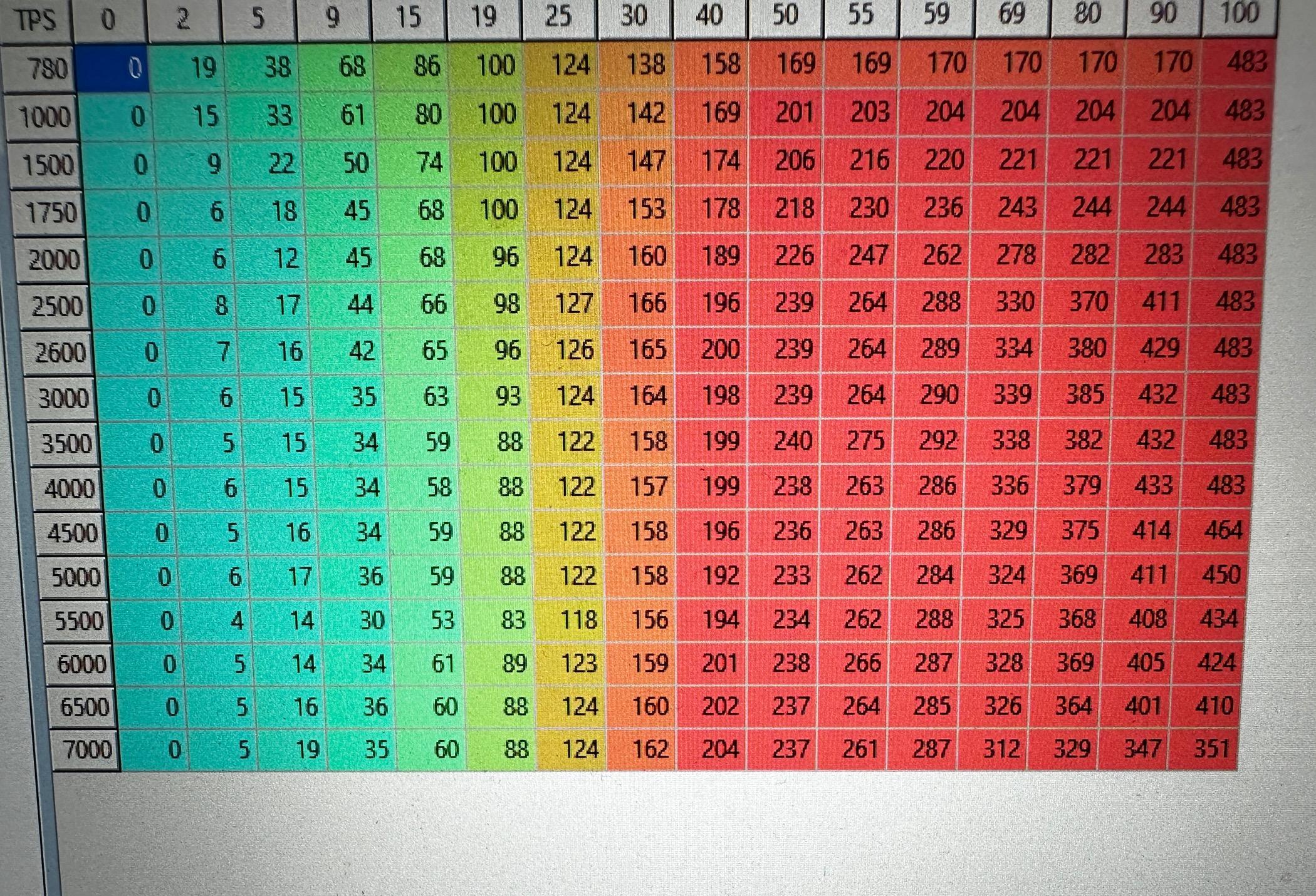

Here are the torque throttle tables for a stock car.
Comfort
Sport
R+
Comfort
Sport
R+
Wow thanks. I used picture to text to convert the tables to spreadsheet so I could plot them - surprisingly little difference between the modes and quite linear.
Ideally I would make a gif of the 3 images looping so you could see the differences but maybe someone else could do that.
