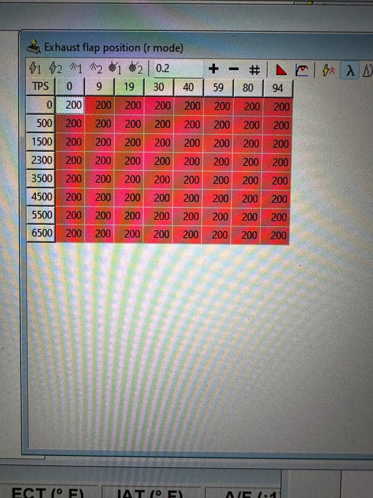

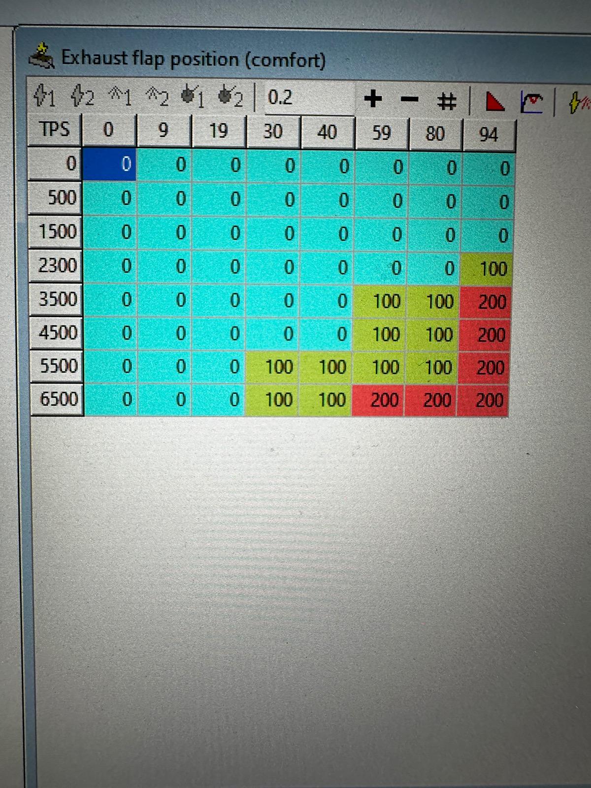

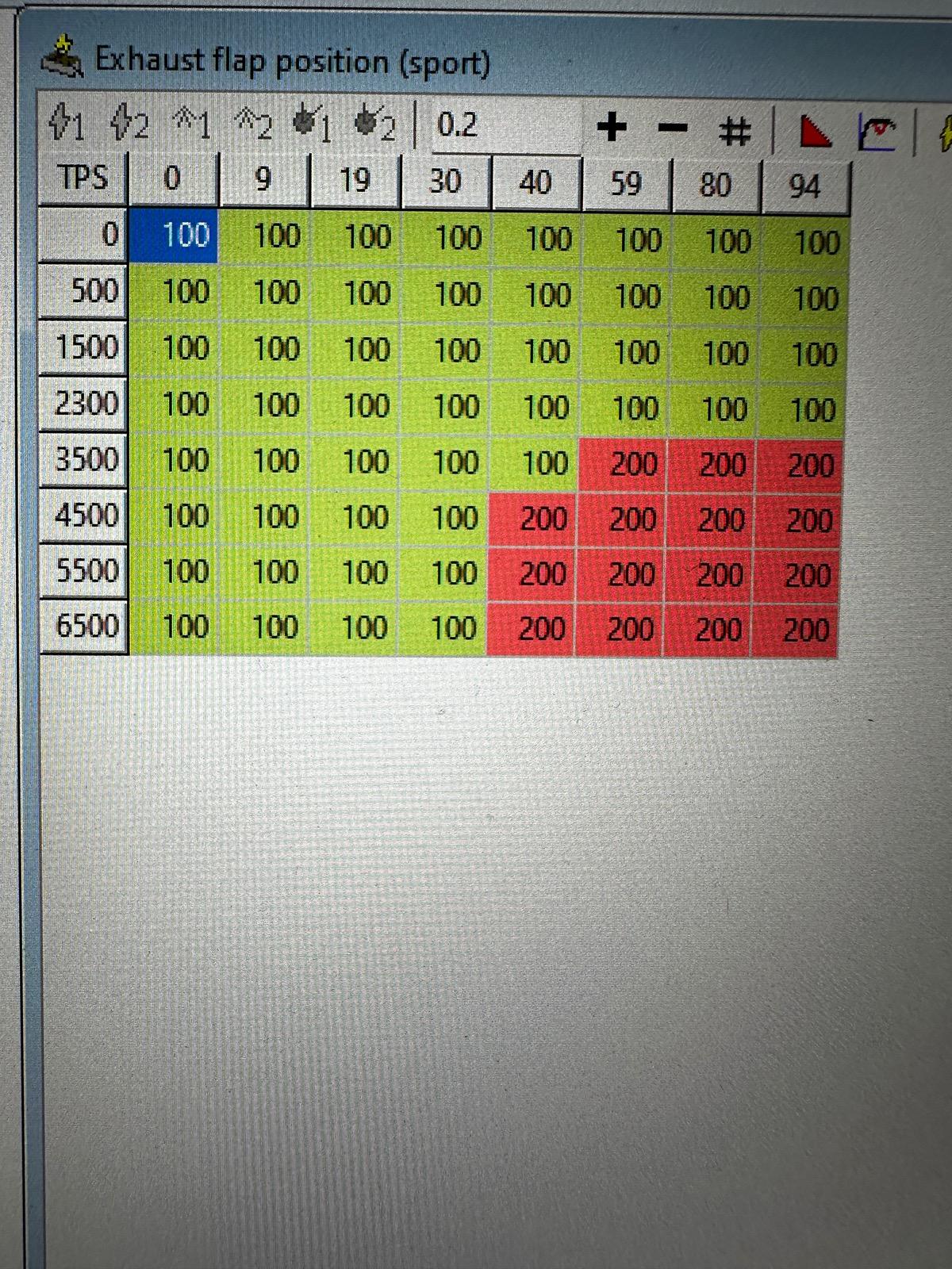

Here are the factory Integra type S settings.
They are even more aggressive than the type R.
11th Gen Honda Civic There’s a Reason Honda Made Active Exhaust, Don’t Disable IMG_3558
11th Gen Honda Civic There’s a Reason Honda Made Active Exhaust, Don’t Disable IMG_3557
11th Gen Honda Civic There’s a Reason Honda Made Active Exhaust, Don’t Disable IMG_3556

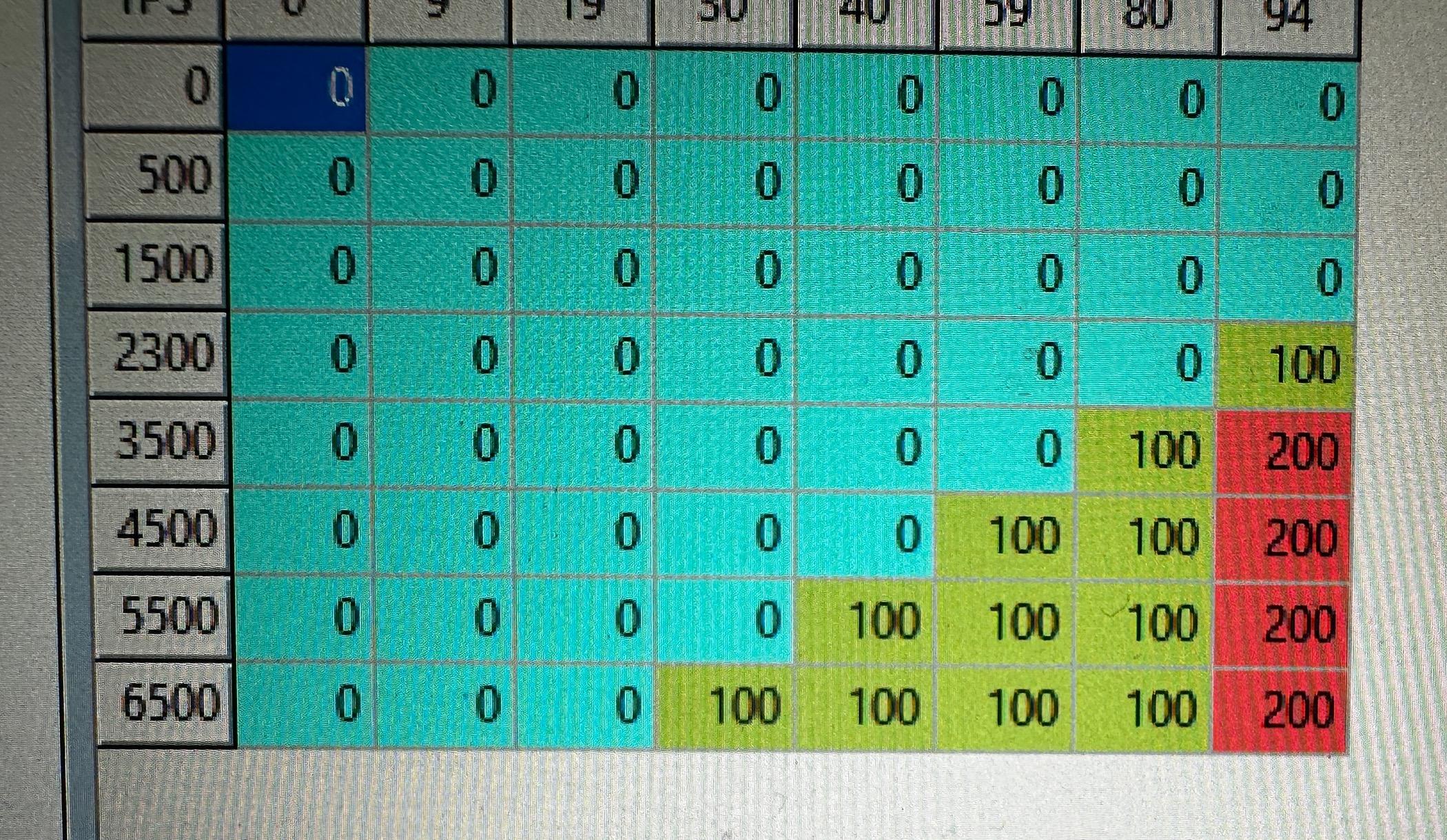

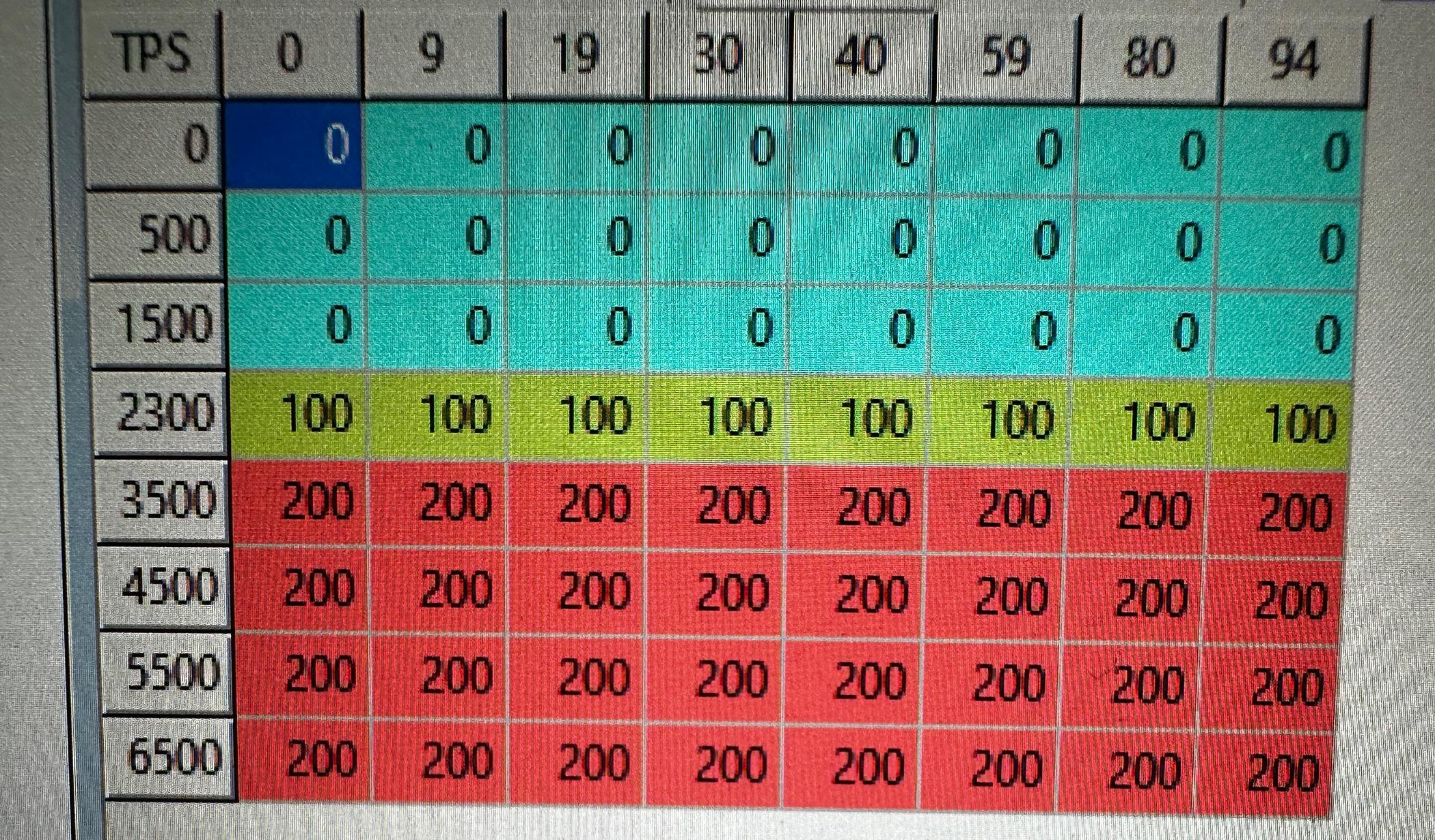

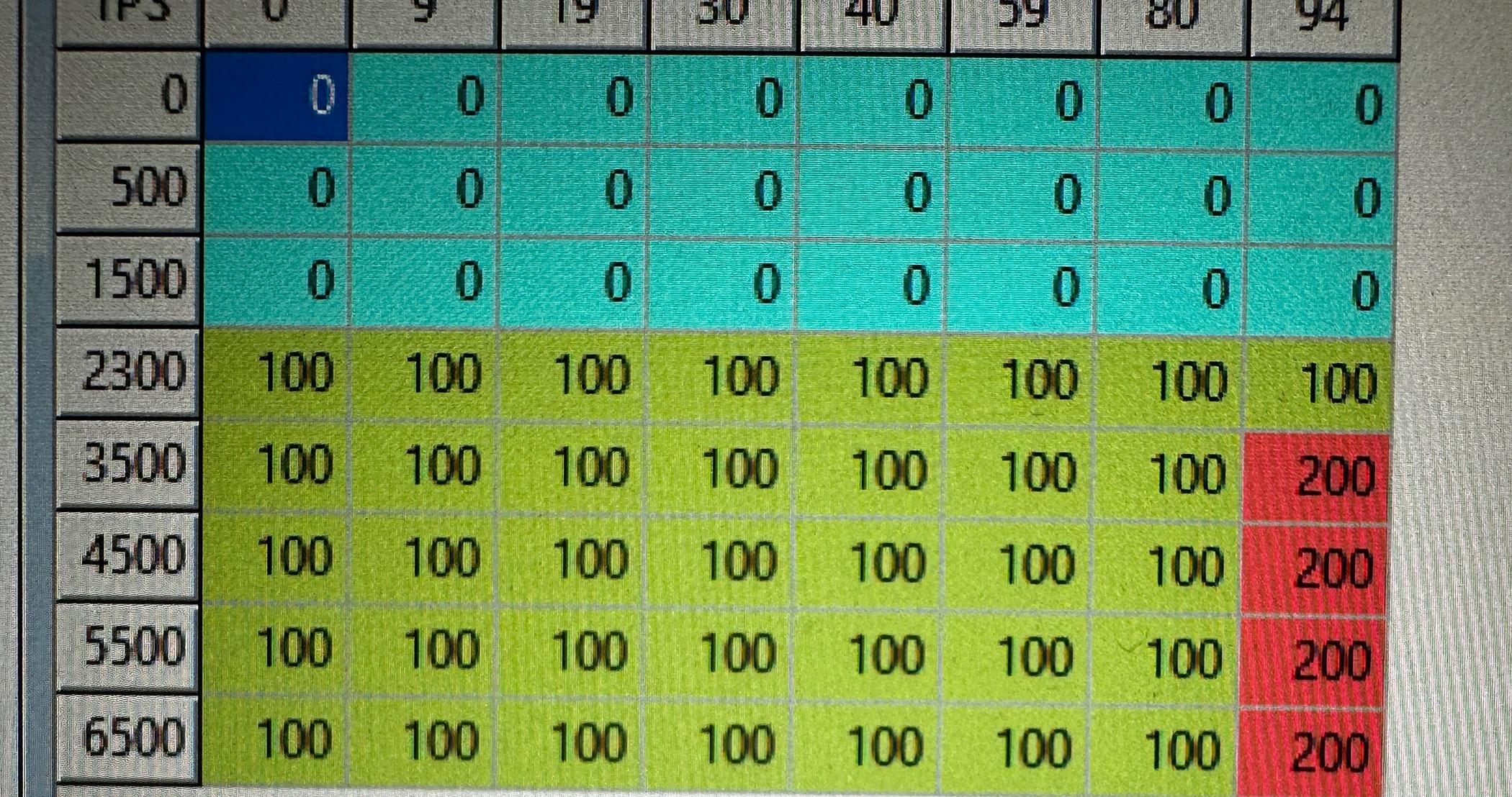

Sorry forgot to post about it.
Stock exhaust valve values respectively for
Comfort
Sport
R+
Dyno testing on my stock car with just an intercooler and valve completely open showed peak torque at around 3,300-3600 rpms starting the pulls at around 2,200 rpms. The valve opens half way at 2300rpms in R+ and shortly after it opens up completely.
So there is literally no way the valve is closed during spool up unless you are lugging the engine in 6th gear at like 1500rpms.

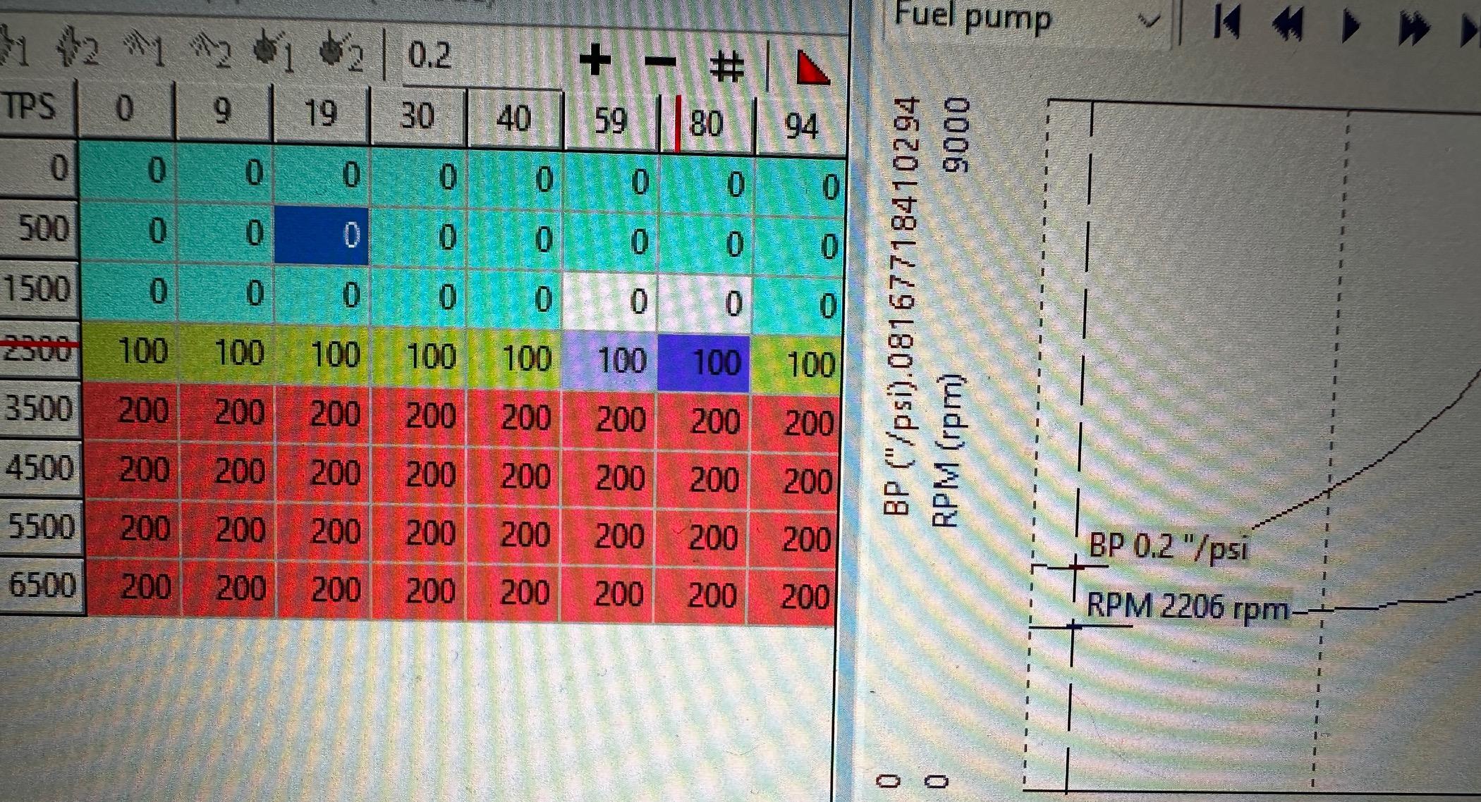

I will gladly give a discounted tuning price for whoever has a stock turbo car that is willing to dyno the car. To test this theory out, I can no longer try it out since I don’t have a stock turbo anymore.
I will close your valve on a pull and then one with fully open.
Here is the log for the dyno on my car on stock turbo with no mods aside from intercooler. The valve is already halfway open already in the programming and it still has not built boost. Even though I had my valve open it still applies that the valve is already bypassing most of the exhaust gas through the center section.
Thanks for the charts. Do these correlate to the "Engine" setting or the "Engine Sound" setting? I haven't found a definitive answer on which setting changes the valve behavior
