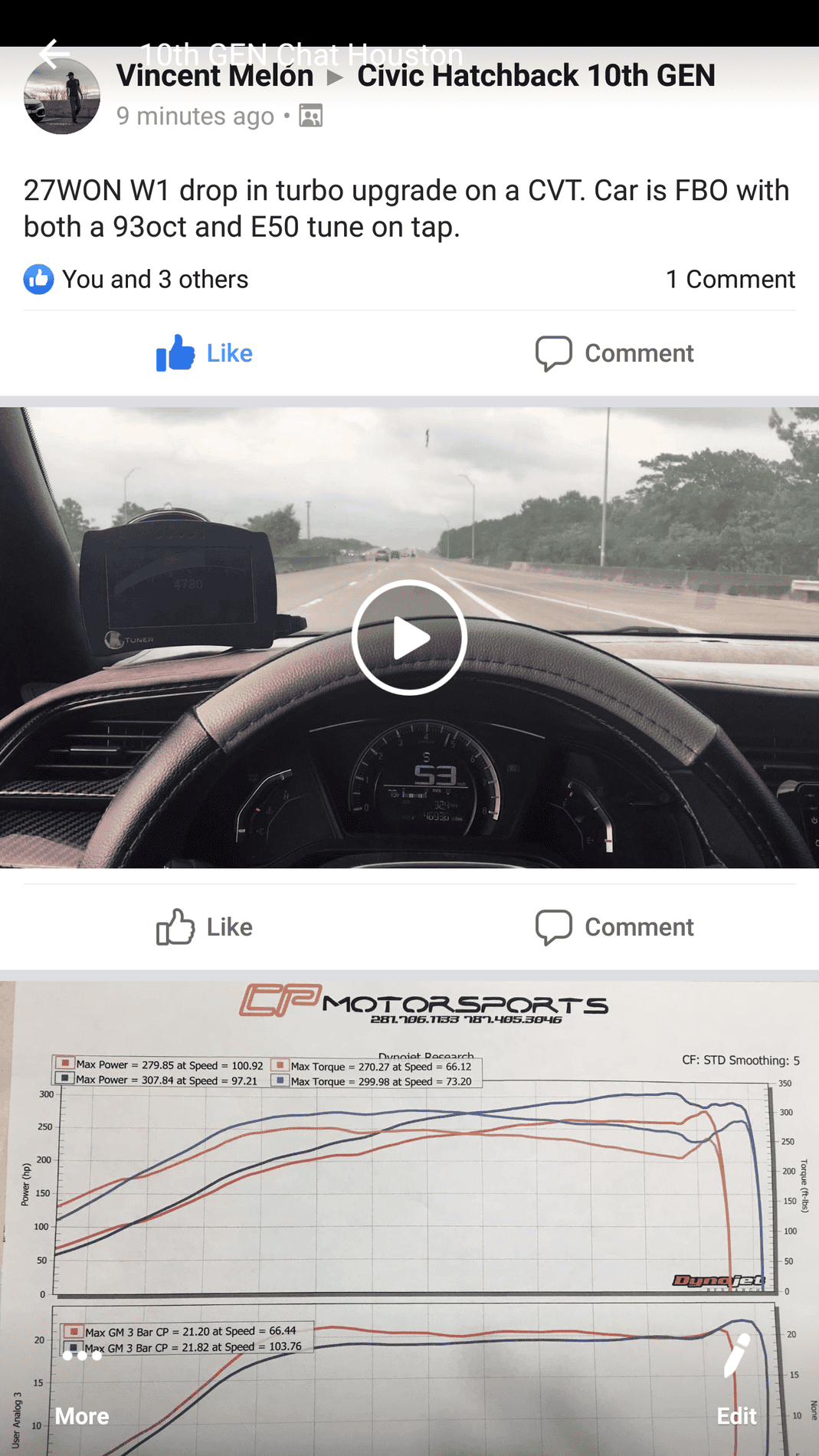

So the 907 torque is just number um ok
If you are making 907lb-ft of torque on the street (On street tires) in your Civic Si (FWD), then yes, it's just a number. How are you going to be able to put that power down? You'd just roast your tires at any and all gears and it'd be undrivable. I'd be happy to race you with that much torque. I'm always down to learn something new.

Unfortunately I don't know how to read that..can u say what your 0-60 was thanks
His fastest 1/4 mile time ticket is 13.34@107mph. On that run, he ran an [email protected]. Putting his 1/8th mile time and trap speed into the calculator on THIS link shows he had a 0-60mph time of 4.28.

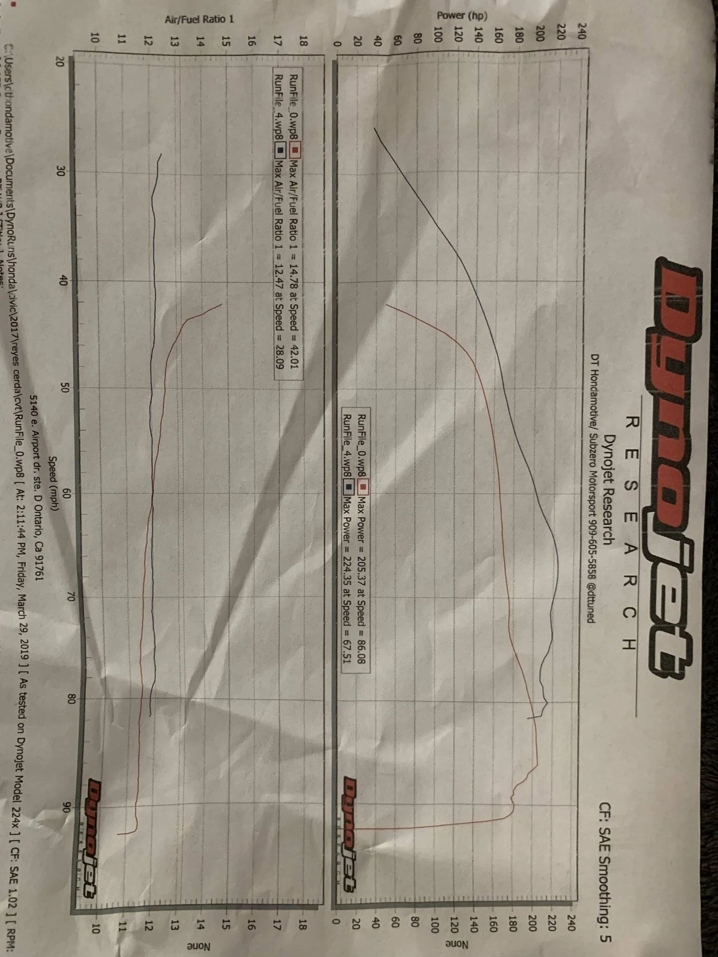

I am only seeing this thread for the first time. I have the turbo and the mods I have to accompany it are:
-27WON CAI
-27WON Turbo
-PRL Catless downpipe
-27Won exhaust
-E85 (didn't get tuned on it though)
Sorry about the crumpled paper, they had the tune dialed back for CVT safety so I haven't maxed out on power yet. Also I have no idea what the torque is I apologize I didn't ask any questions I just picked up my car and left as there was a family emergency that day.
Experience with the turbo and tune. I have had the turbo on my car for over a year now and about close to 15k miles. I have been on this tune since the end of March and the power delivery is just so smooth I love it. You can really feel the difference in power in the top range. I have raced a couple cars mostly Fiestas lol, I easily beat all the stock ones on rolling starts, and I barely edged out a guy from school that only had a downpipe in his. I have had exactly 0 problems so far, and eventually will try and get tuned for e85 to see what power I can really make.

Well CVT torque limit is around 250wtq
