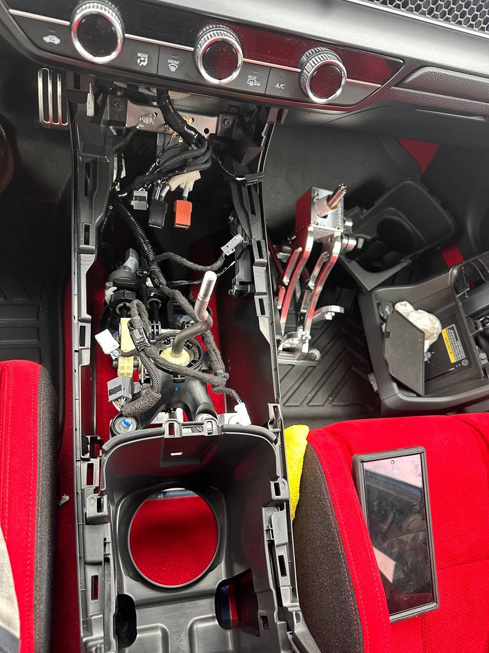

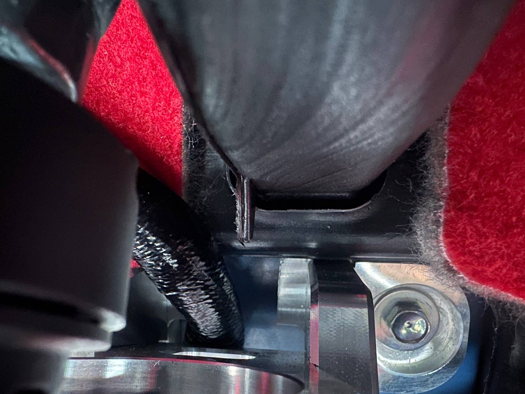

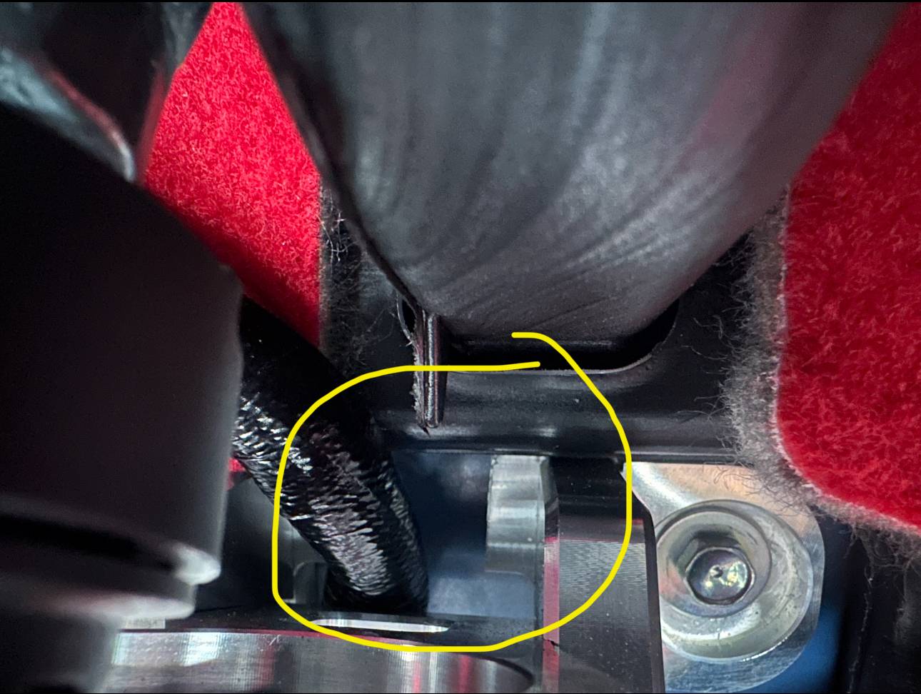

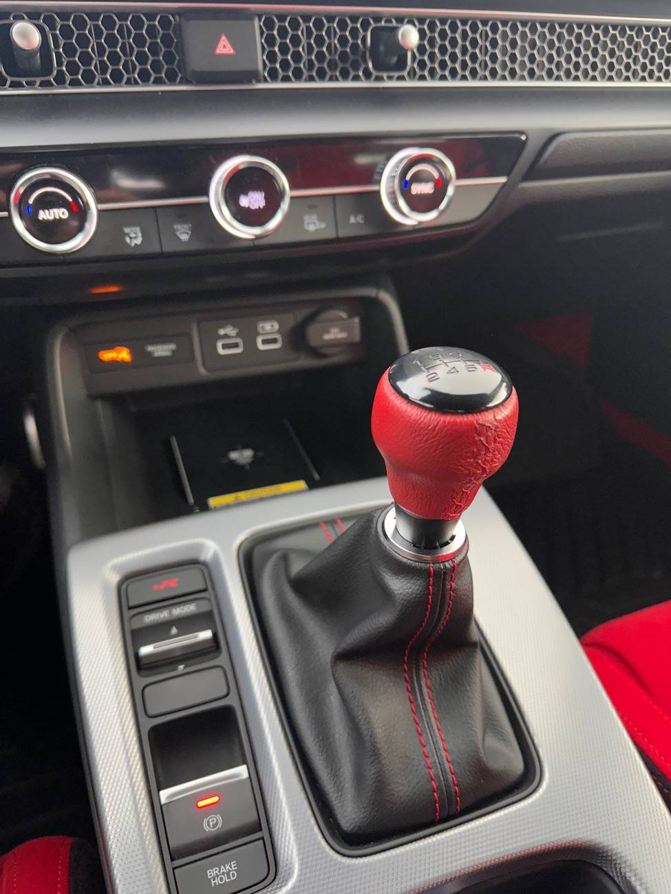

So I had a fun day yesterday installing the KTuned short shifter and rear vent and USB charging ports. Let me start off by saying this is not designed for the FL5 from the get. Unless they messed up somewhere with the description and pictures. But i had to cut 1.5” from the front mount plate so the communication cable can go under the shifter body. This shifter also sits higher than oem on its lowest setting, which is kinda frustrating because i wanted the shifter to sit lower than the oem one. I’ve reached out to Ktuned to see what they say and sent them pictures. On the plus side the gate and throw feels short and solid. With smooth engagement.
