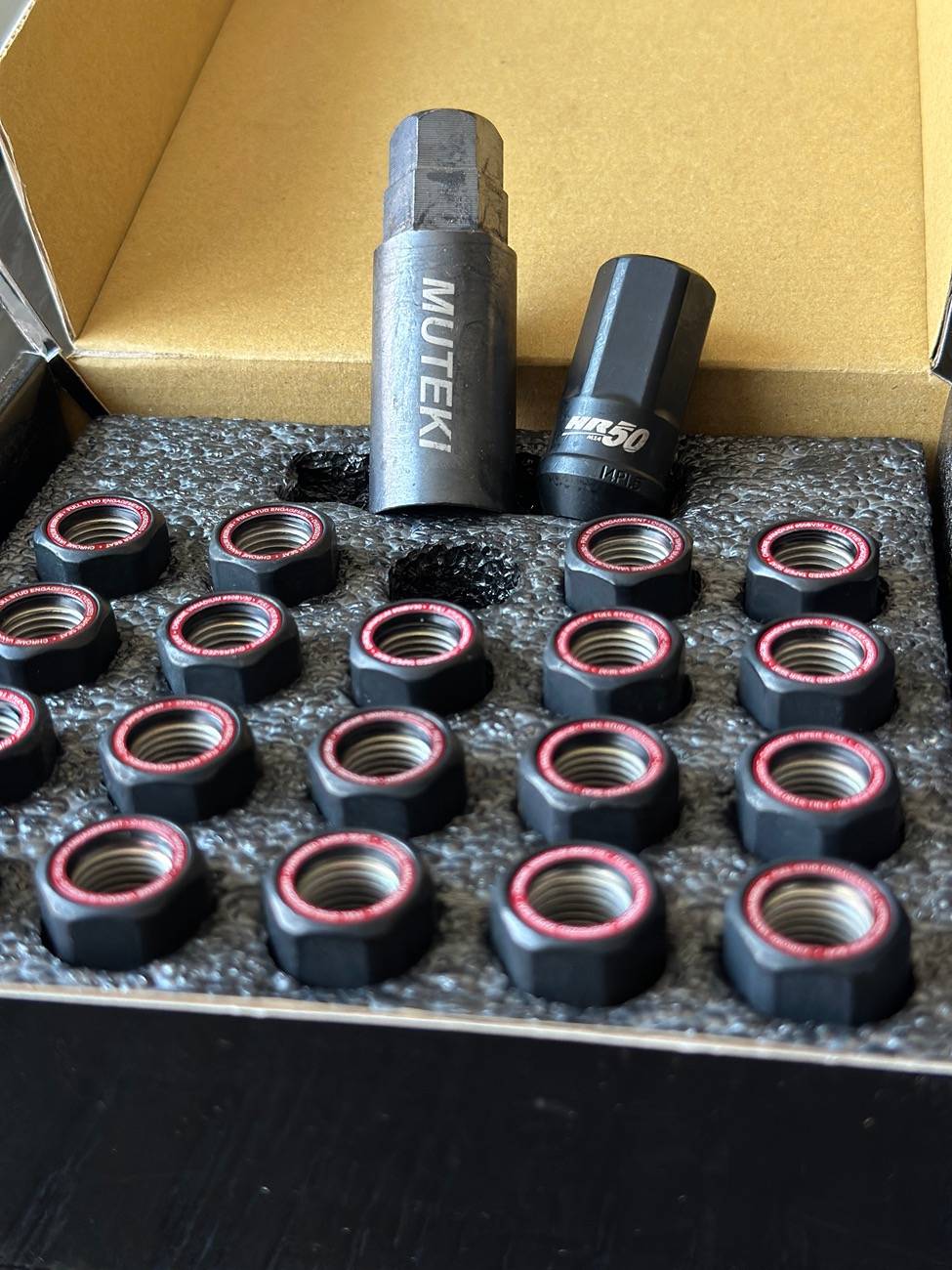

bought some lug nuts...

Any pics, I was wondering how they'd look? I was feeling the design and figured it'd be perfect.

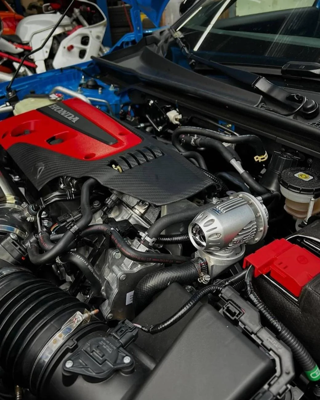

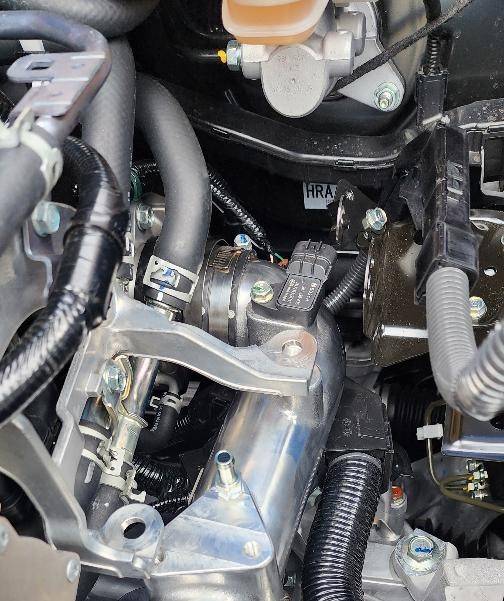

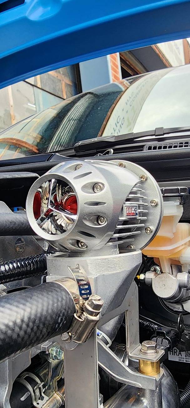

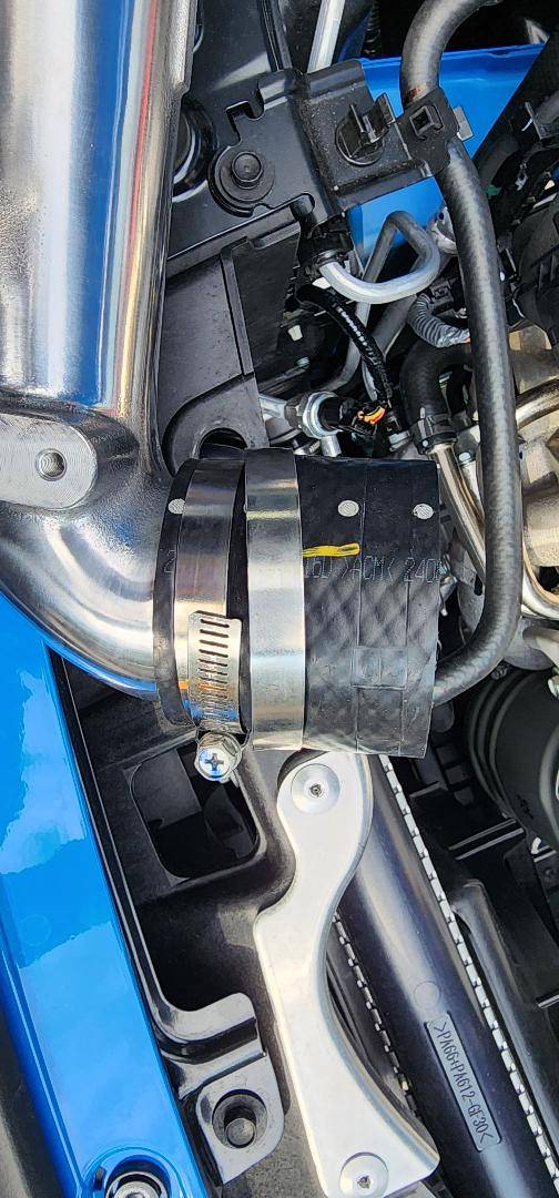

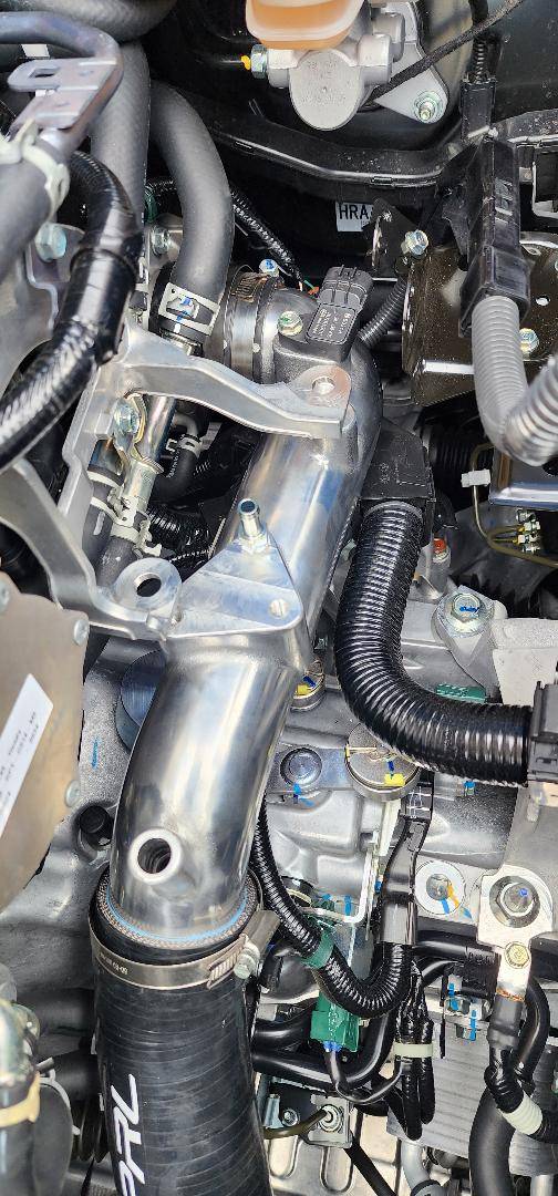

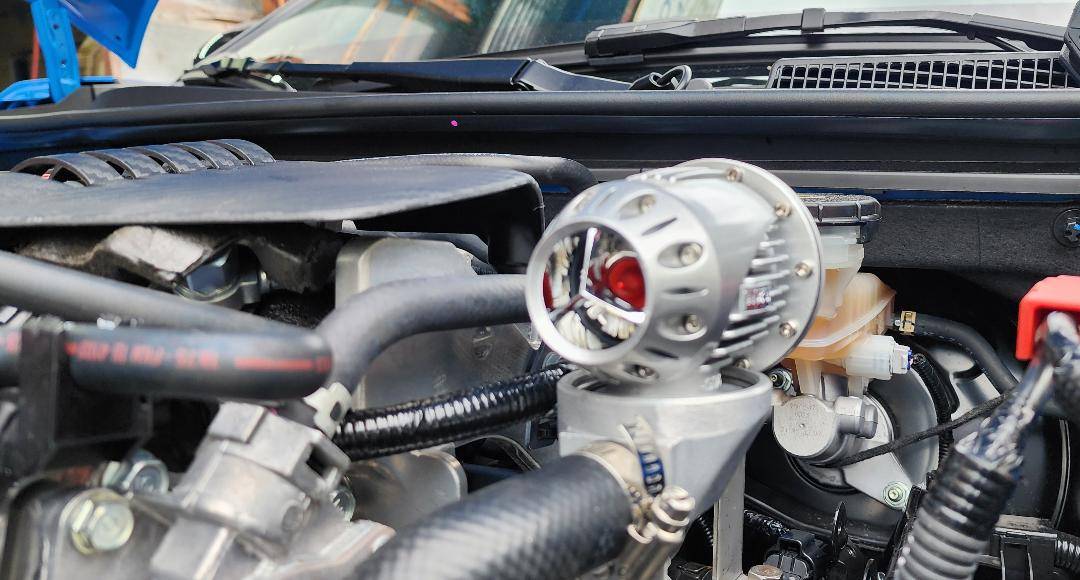

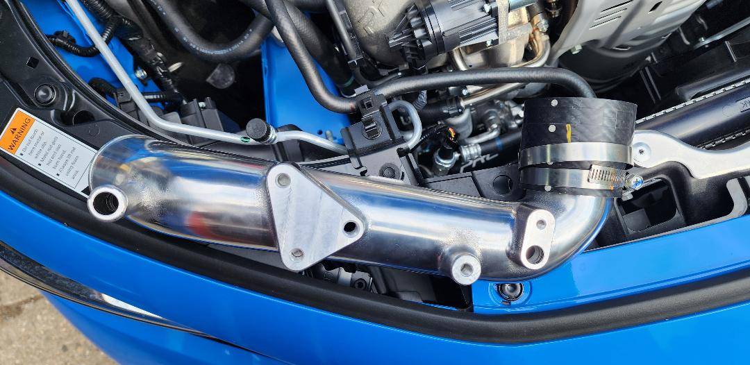

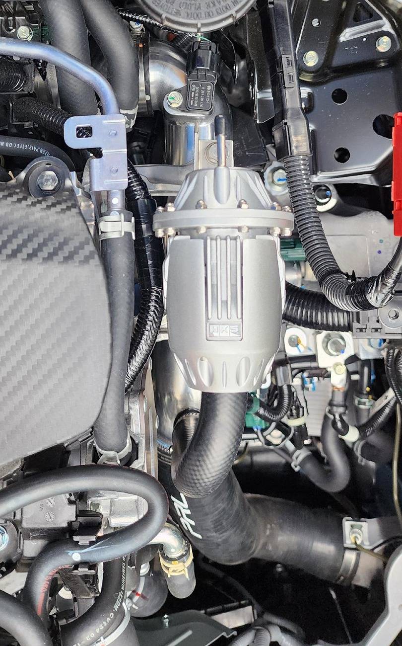

I installed the FK8 HKS Super SQV4 onto my FL5. I am confirming that it works mounts perfectly. Didn't have to buy any extra silicone hoses. The kit did not cause a check engine light. The HKS install instructions worked great (there's pictures hahaha).
The kit was ordered from Two Step Performance, great customer service and shipping. Part # HKS71008-AH009, link https://www.twostepperformance.com/products/hks-super-sqv-4-honda-civic-type-r-fk8
I had to remove the PRL intercooler charge pipe upgrade kit to install the HKS FK8 charge pipe. There is no need to buy a different silicone for the HKS FK8 charge pipe to go onto the throttle body. you can use the OEM silicone.
The sound is amazing, I highly recommend it :)
