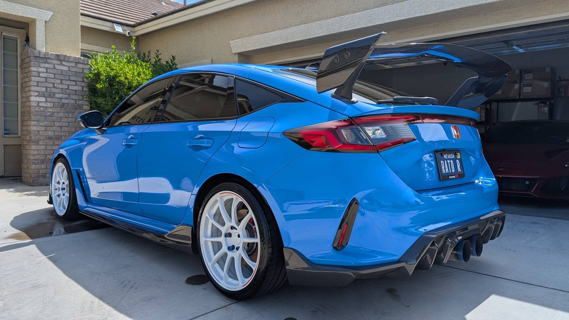

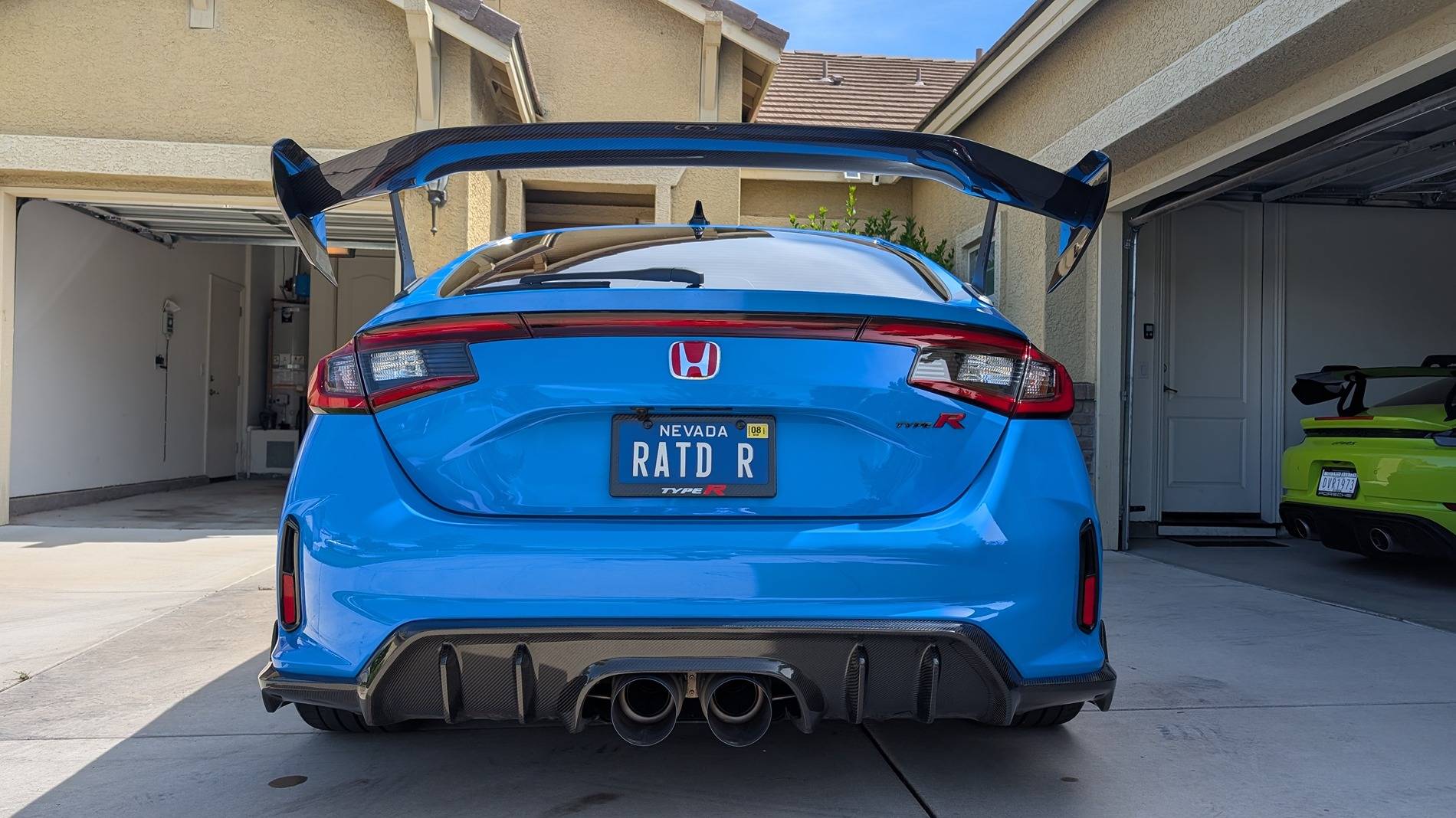

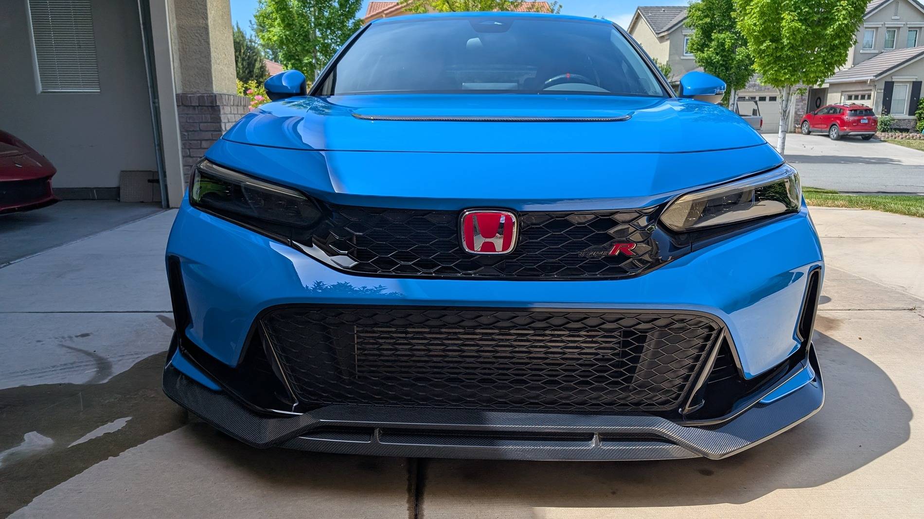

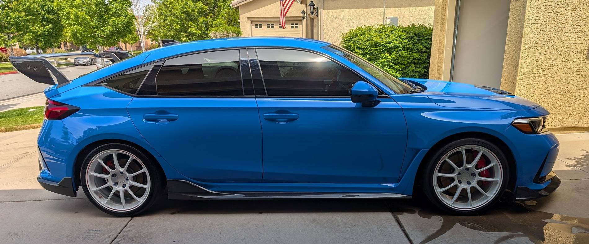

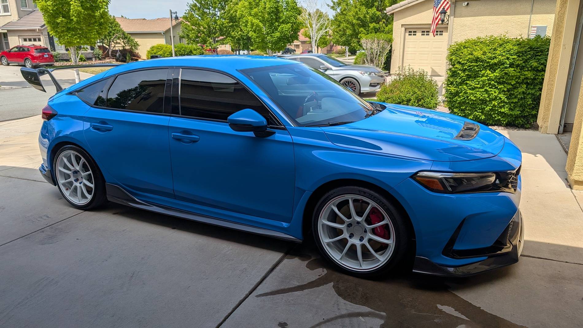

Man, Post more pics! Not a lot with the full kit out there. Looks great. How was the wing installation?
Sure thing! Wing install wasn't too bad. As mentioned in a different thread you do have to take a file to the inside of the mounting holes to clean them up a bit but not a big deal. I also didn't use their incorrectly cut tape on the wing end plates. I just went to Home Depot and got some foam rubber weather seal for the end plates and the wing mounts.

What exhaust is that? Car looks great!

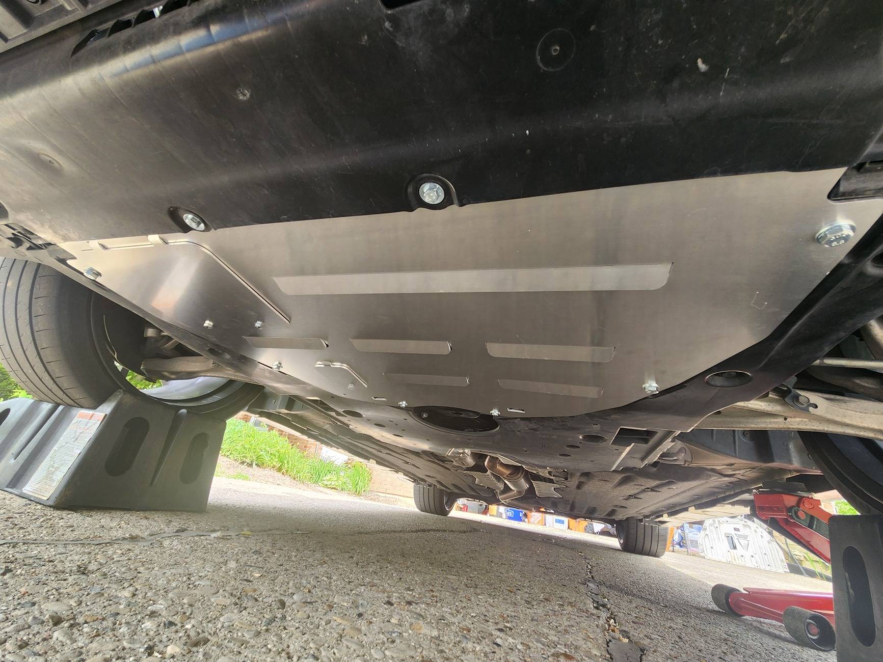

I installed a Bash (belly) Plate from Project Aero. It is much more robust than the OEM belly pan and it has access panels for the oil drain bolt & oil filter.

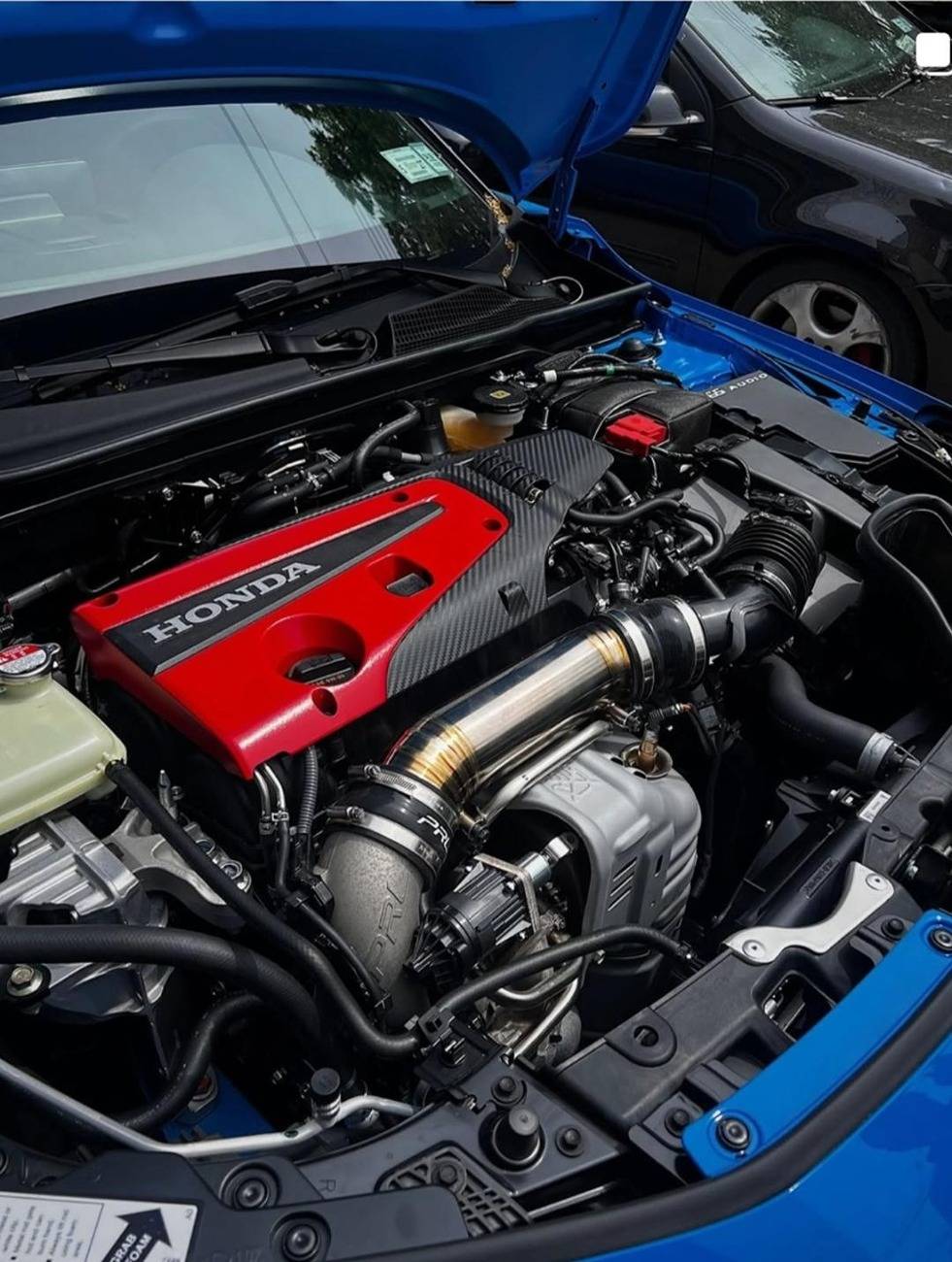

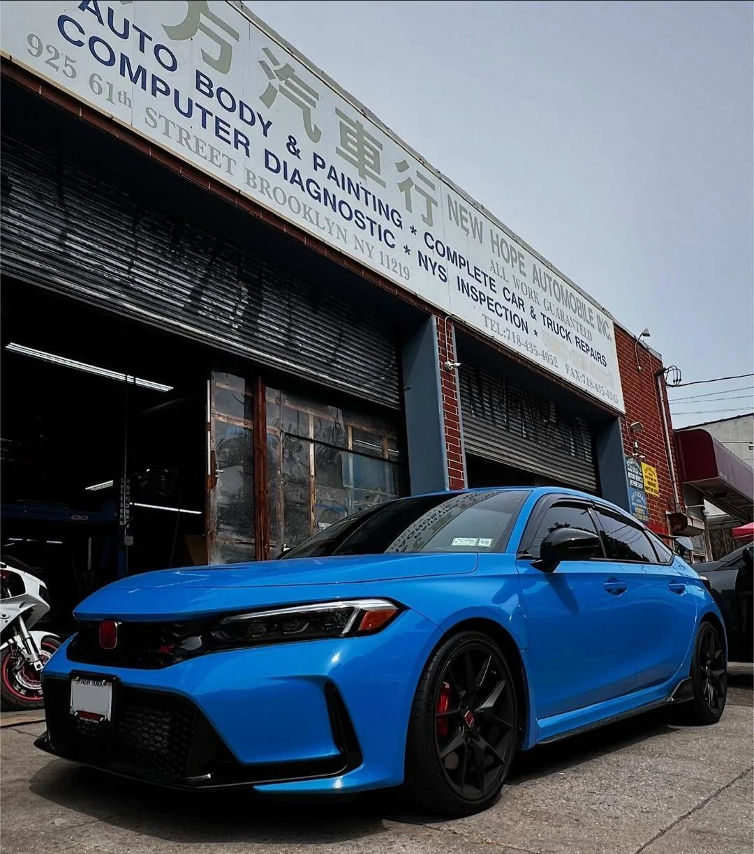

Installed PRL goodies... titanium inlet pipe, intercooler and charge pipe upgrade kit. The inlet pipe kit fits perfectly on the factory intake despite what it says on the PRL website. A cool turbo is a happy turbo :) Parts were installed at New Hope Auto in Brooklyn, NY. Great bunch of guys and highly recommend!
