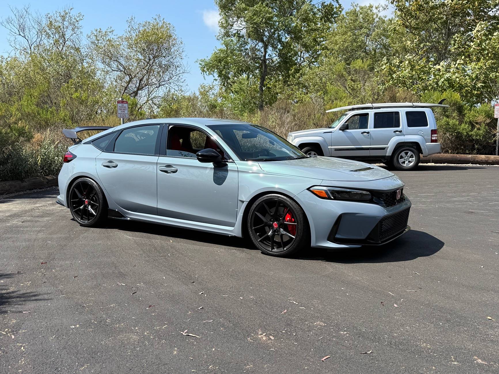

11th Gen Honda Civic What did you do to your FL5 today? IMG_6867
who says you go off roading in the R? ?

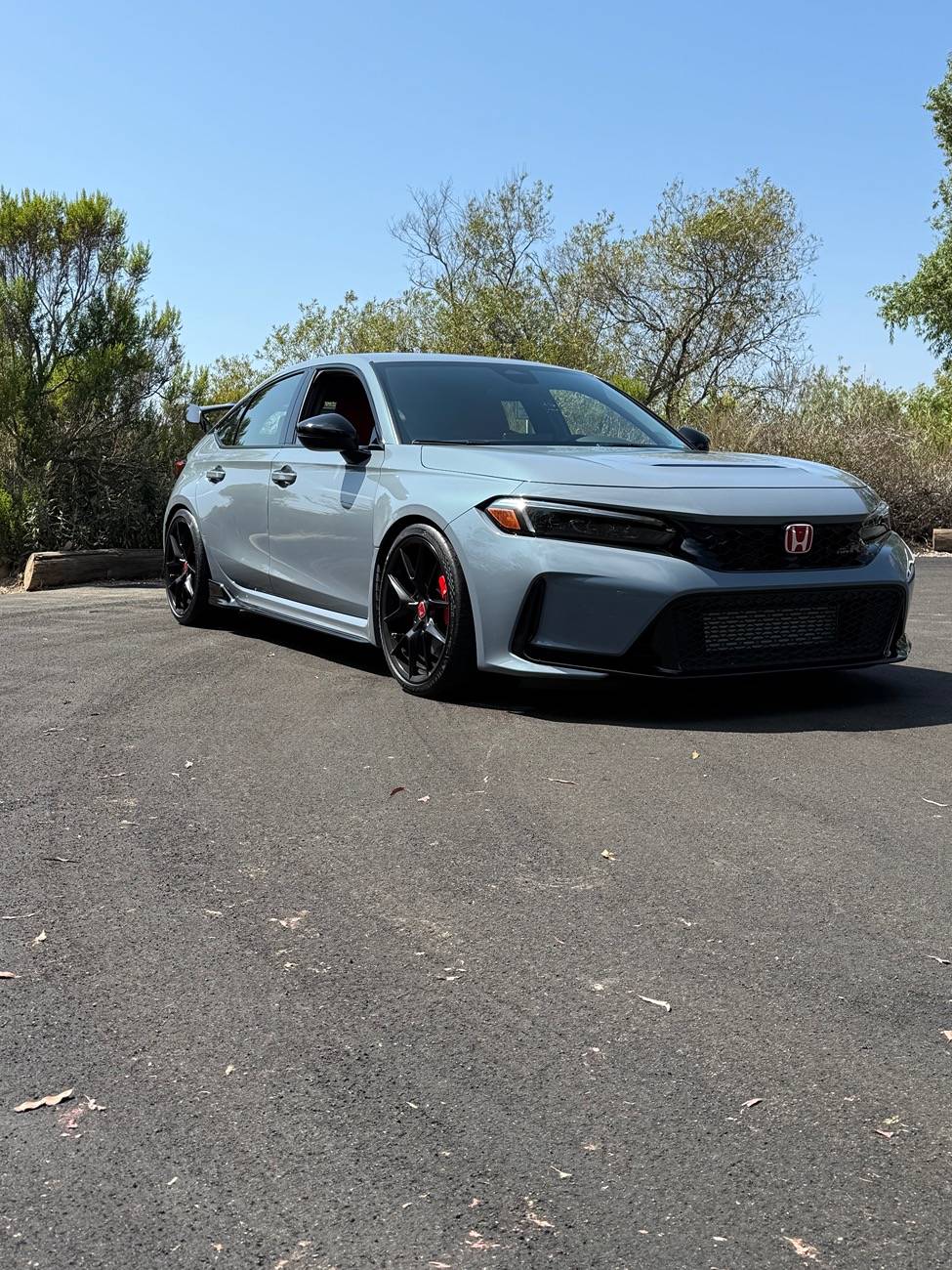

@NeRO_CTR Here you go buddy ??
This was just after about one day and I was really surprised how close the numbers were.
FL 25 1/2
FR 25 9/16
RL 25 9/16
RR 25 1/2
? Measured the best I could after a long night lol

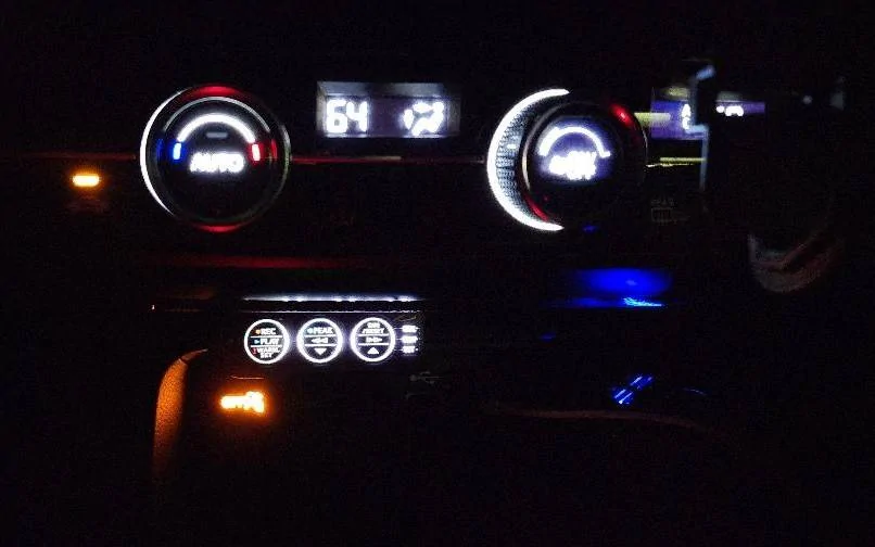

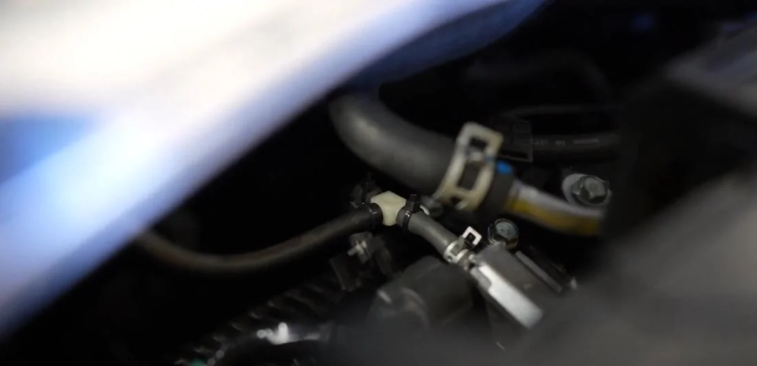

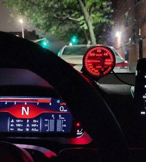

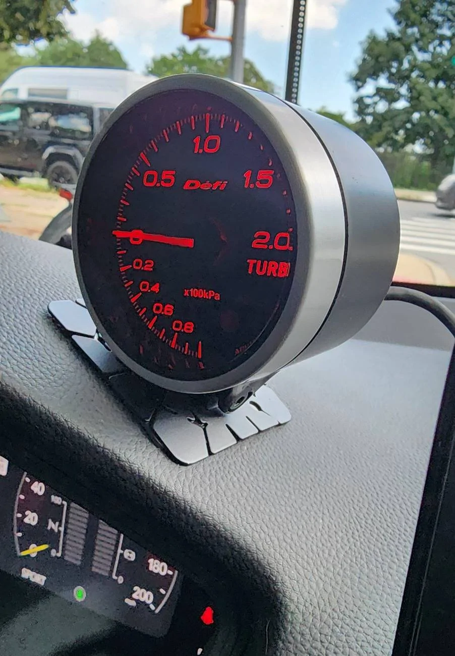

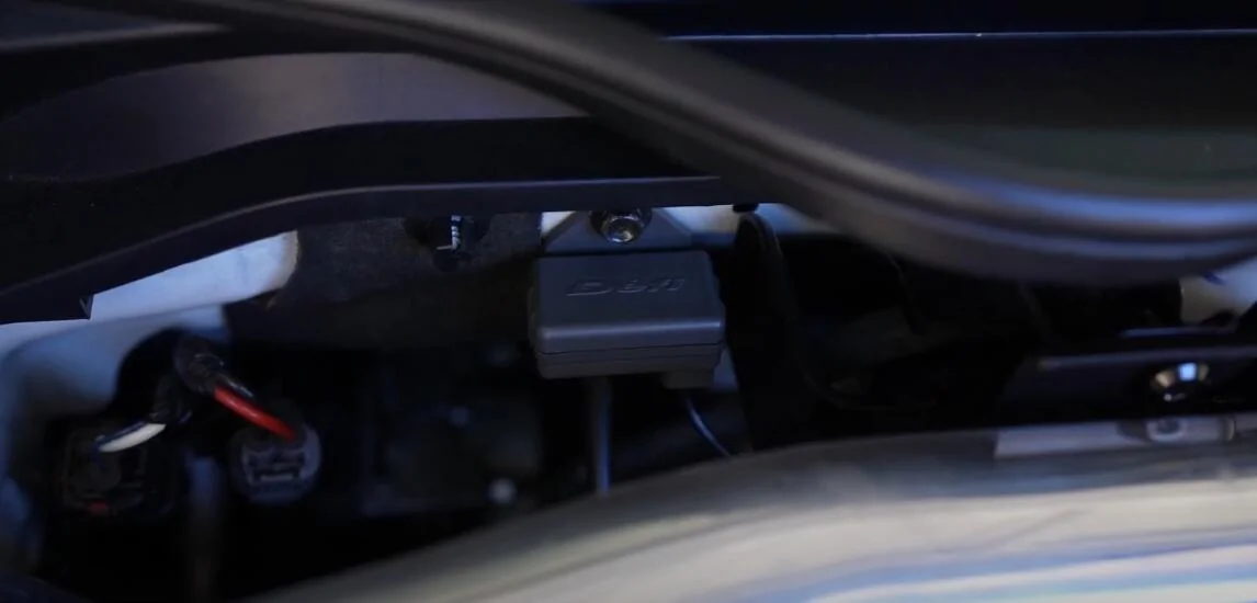

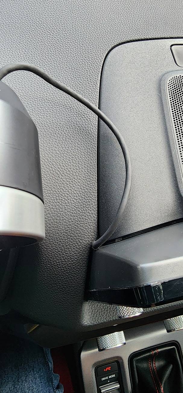

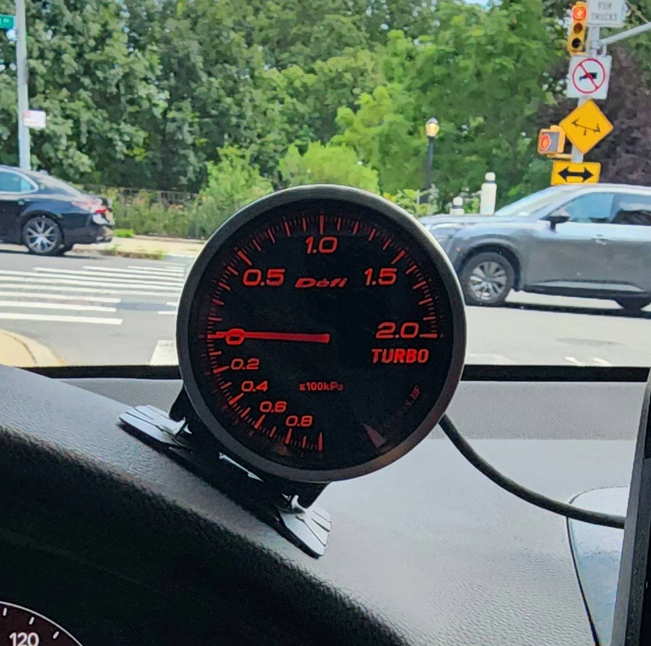

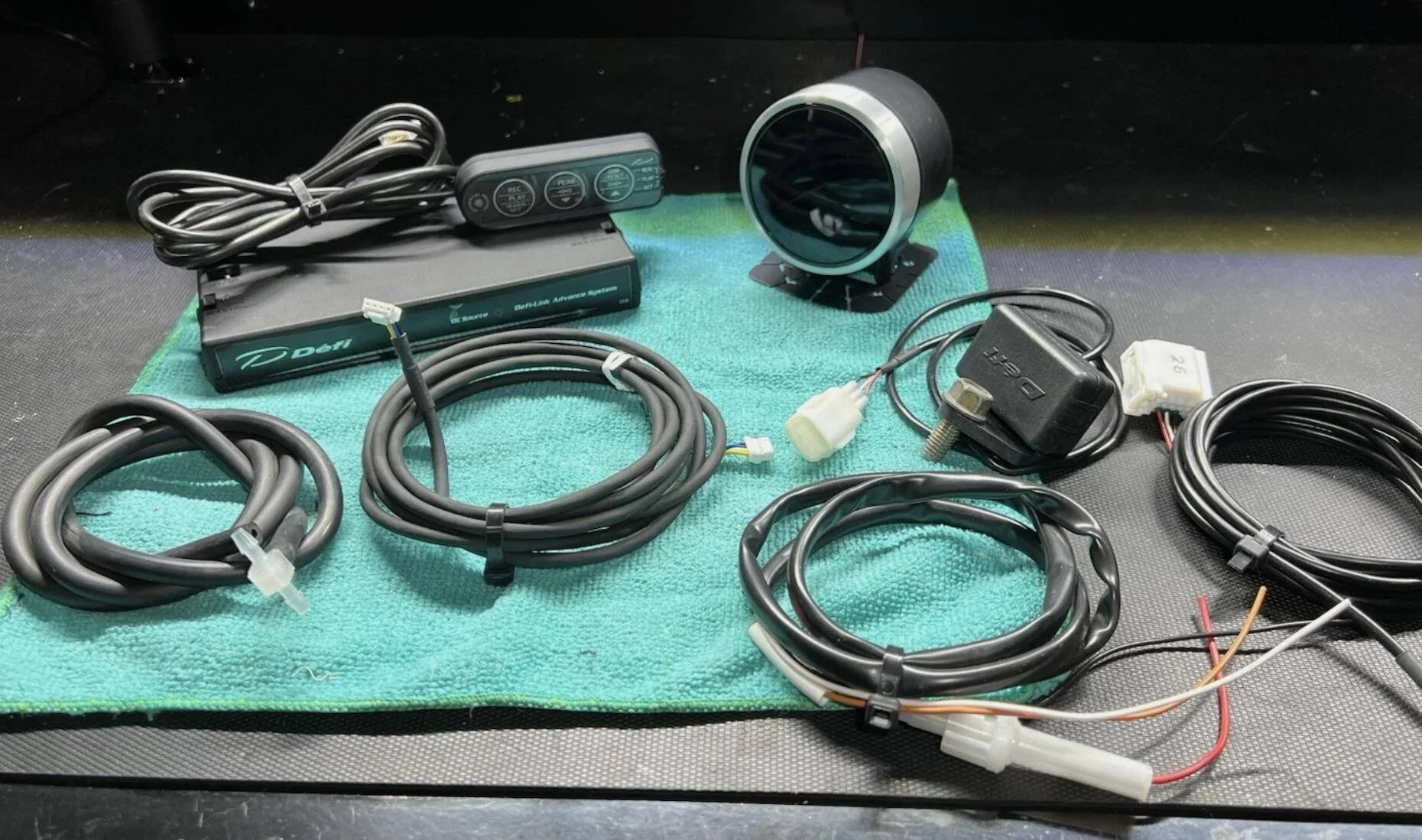

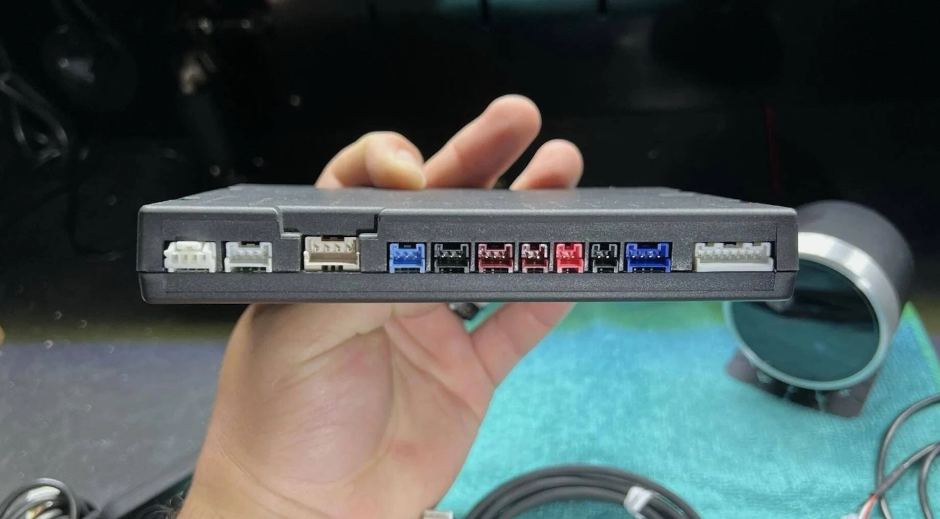

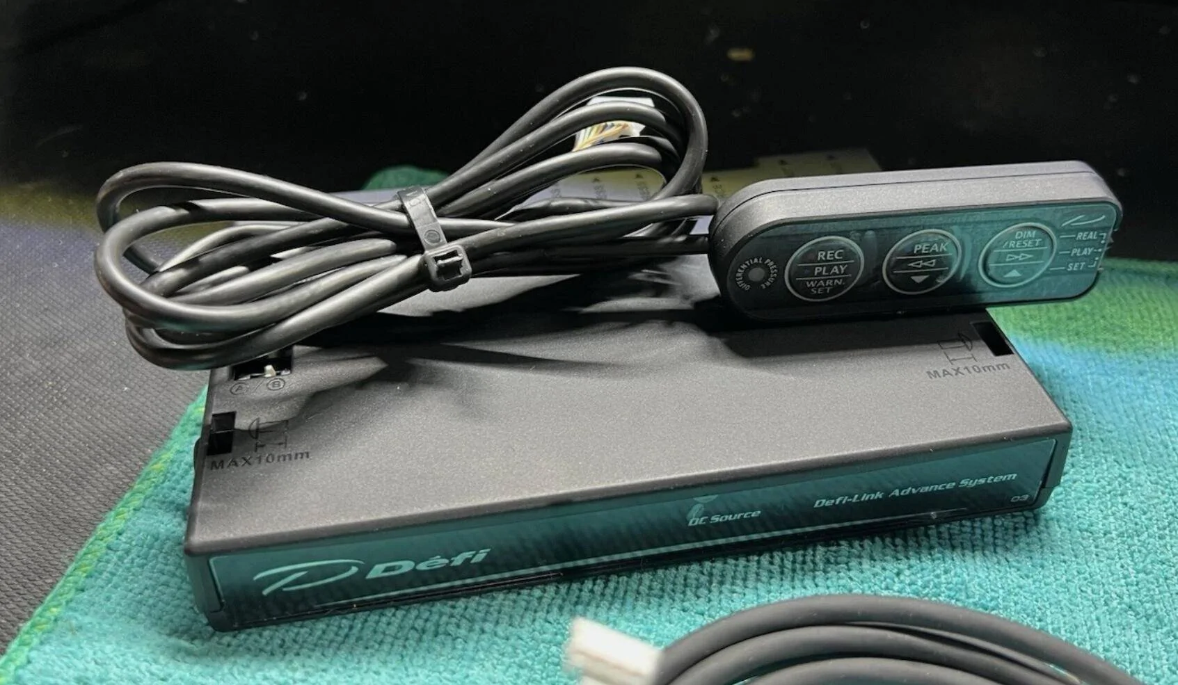

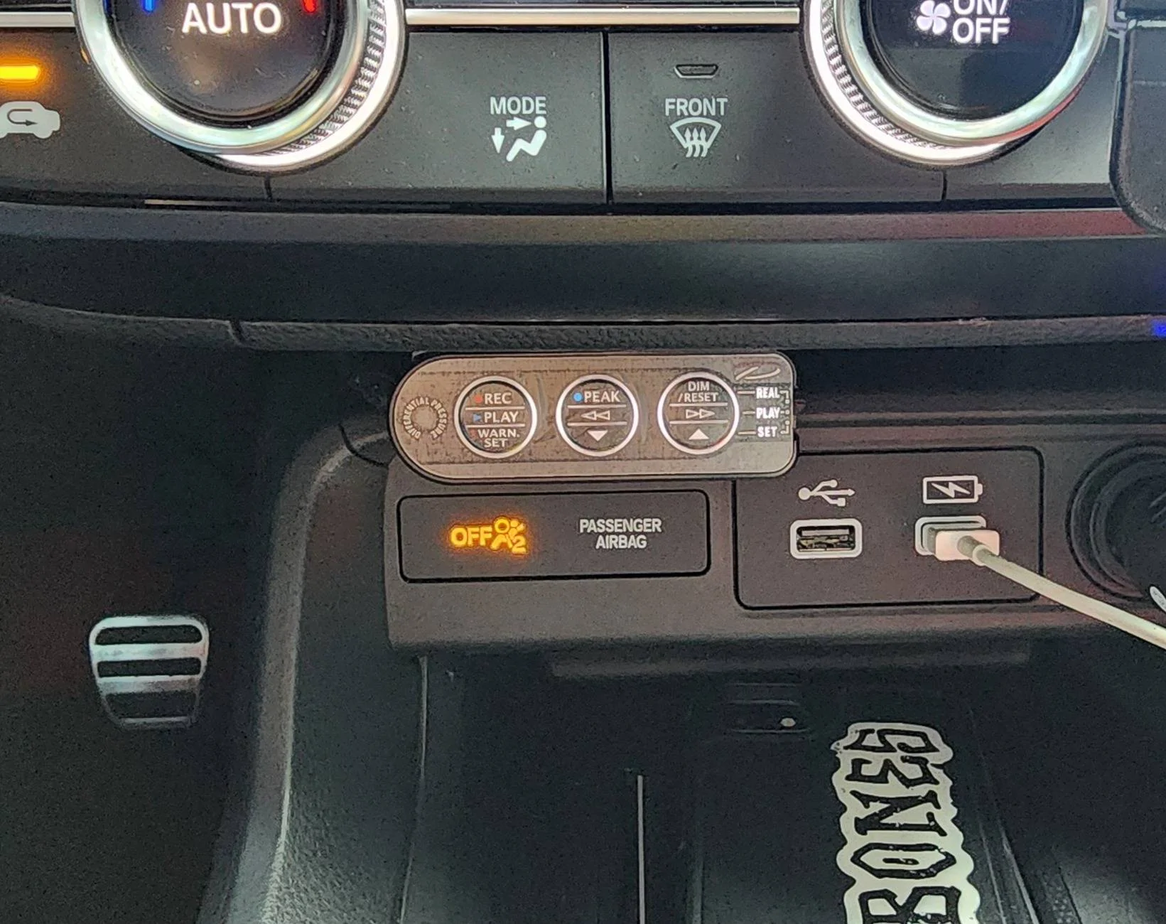

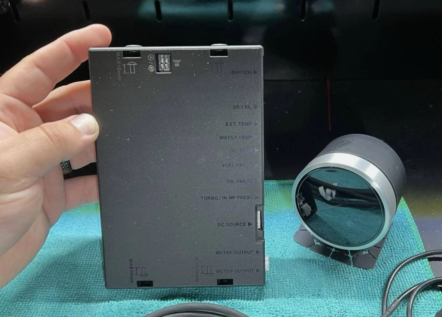

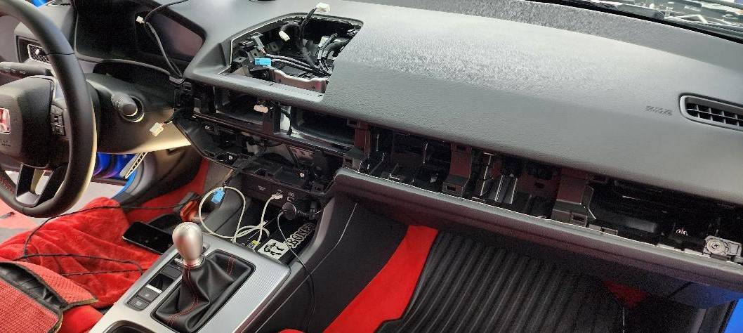

Because........... RACECAR spelled backwards is still spelled RACECAR!!! Installed a Defi-Link Advance control unit and turbo gauge. Ripped off the dash to wire the system for a clean install. I connected the Defi boost sensor onto the firewall inside the engine bay, on the passenger side. Wired the red power wire, the black ground wire, the orange ignition wire and the white illumination to the infotainment wires (that's the reason why the dash was removed). The wire that goes to the turbo gauge is on the Defi boost sensor, it was ran through the firewall and up behind the dash to the Defi control unit. The vacuum hose from the Defi boost sensor comes with a supplied T fitting. The T fitting is split from the manifold, one way goes to the boost sensor, the other way goes to the HKS BOV. Seeker cluster meter pods and hopefully more gauges in the future. Much of the install and inspiration goes to Kodawari.FK8's YouTube channel - ... because his gauge setup is so badass!!!

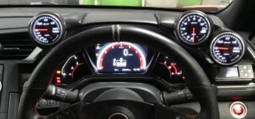

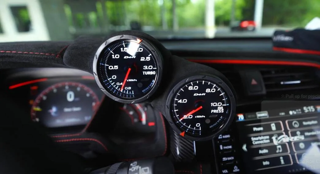

Reference pic of the what the Seeker pods look like........ RACECAR!!!! :)
11th Gen Honda Civic What did you do to your FL5 today? scrnli_29PPyM9HN4ThYU

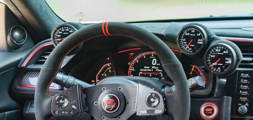

These pics are from Kodawari.FK8's YouTube video, he wrapped his interior in Alcantara fabric - :

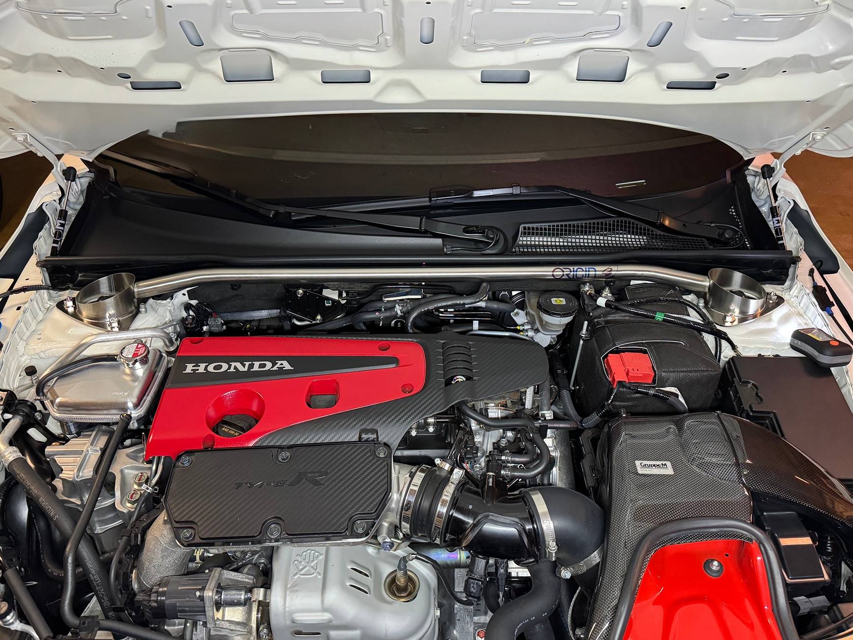

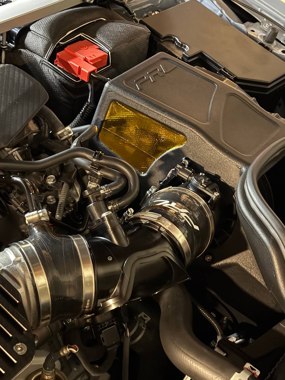

One Horsepower per Square inch claimed ? I just can’t do it to much bling ? Thought I’d make a little insert on the Air box ?
11th Gen Honda Civic What did you do to your FL5 today? IMG_1651
I’m afraid in time I’ll end up like him ?

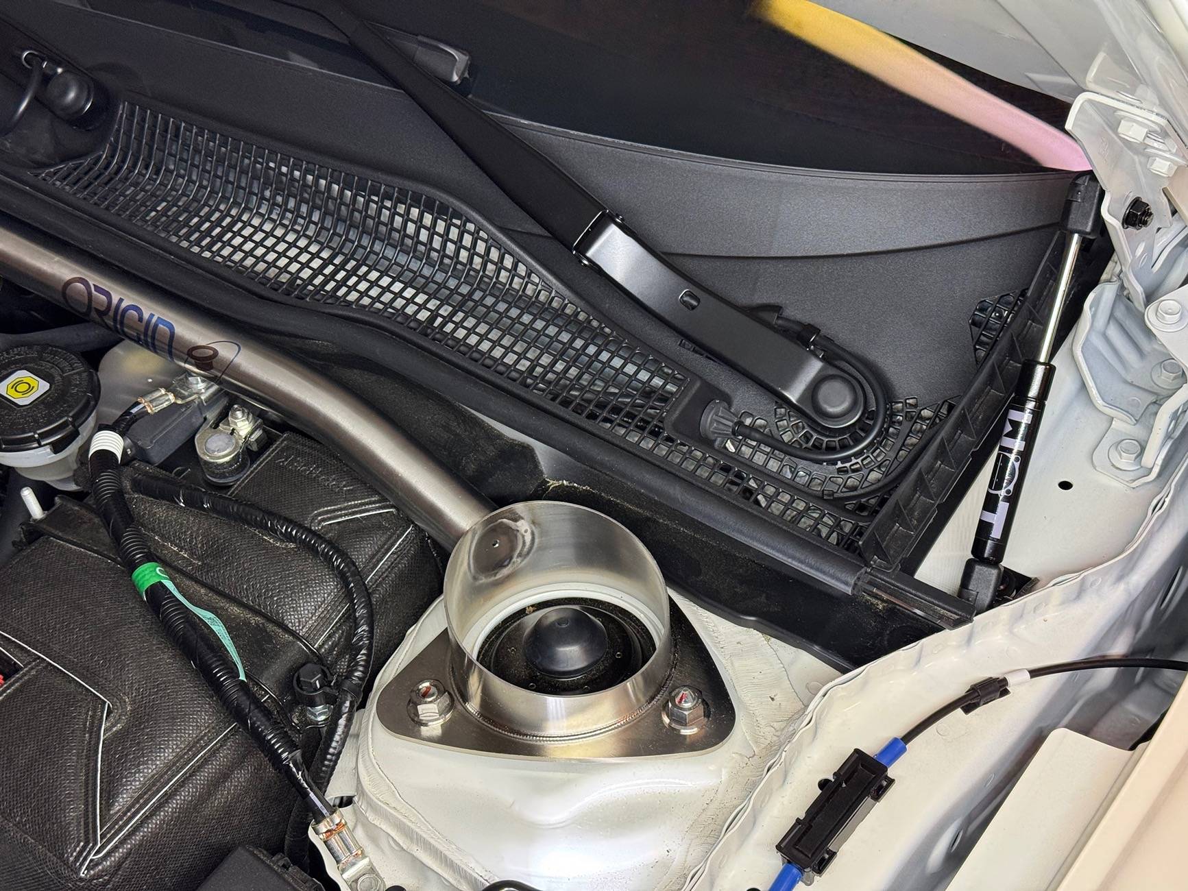

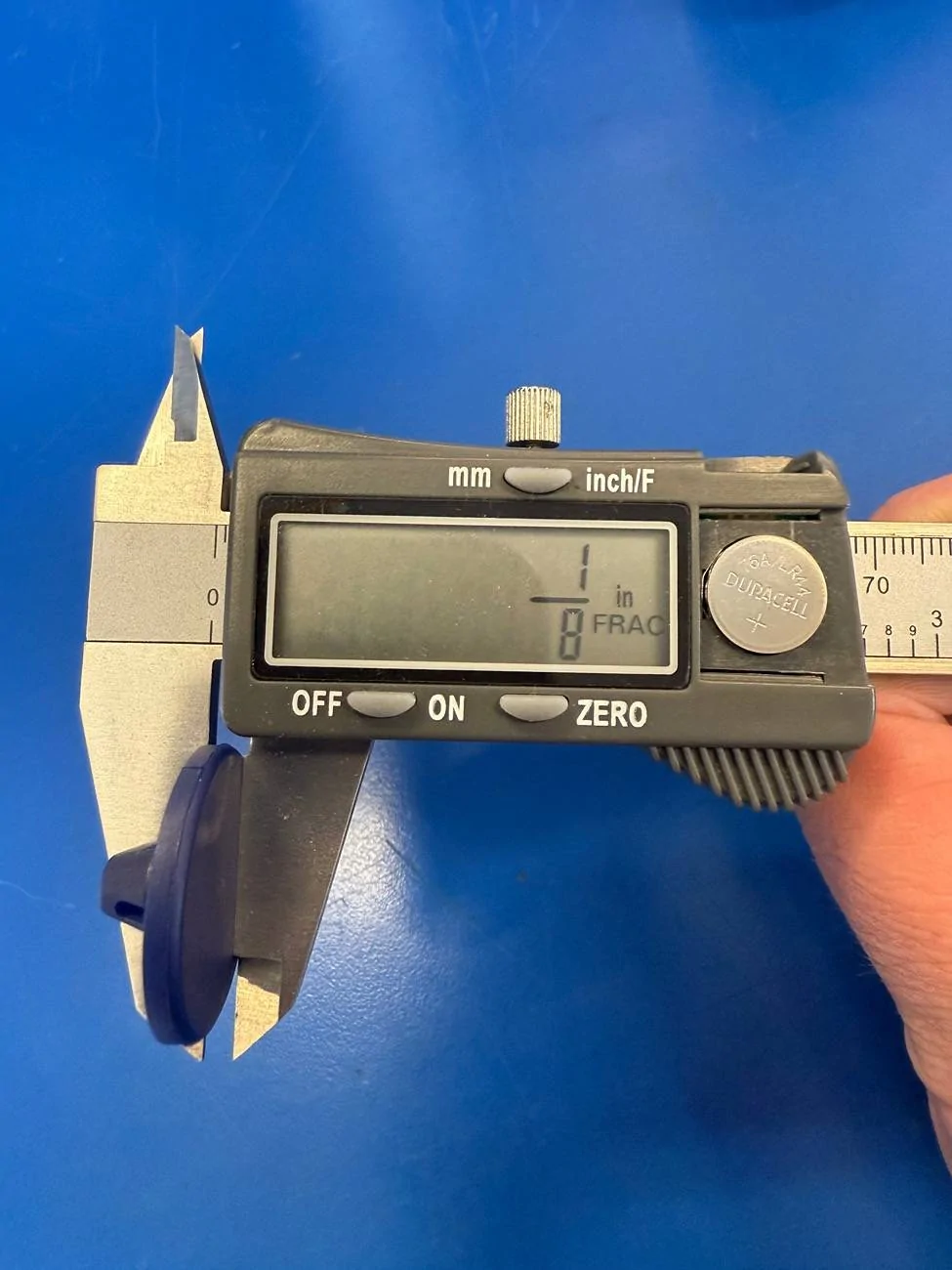

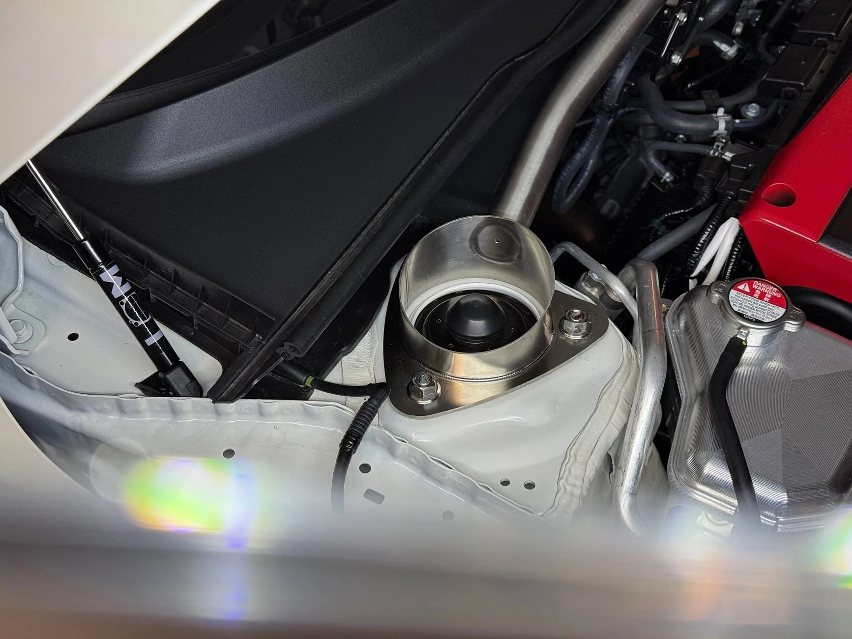

Cool , do you have the revised with the blue collar’s?
Settling in nicely
11th Gen Honda Civic What did you do to your FL5 today? IMG_1661
Settling in nicely
yes, they are the updated version with black insulators.
