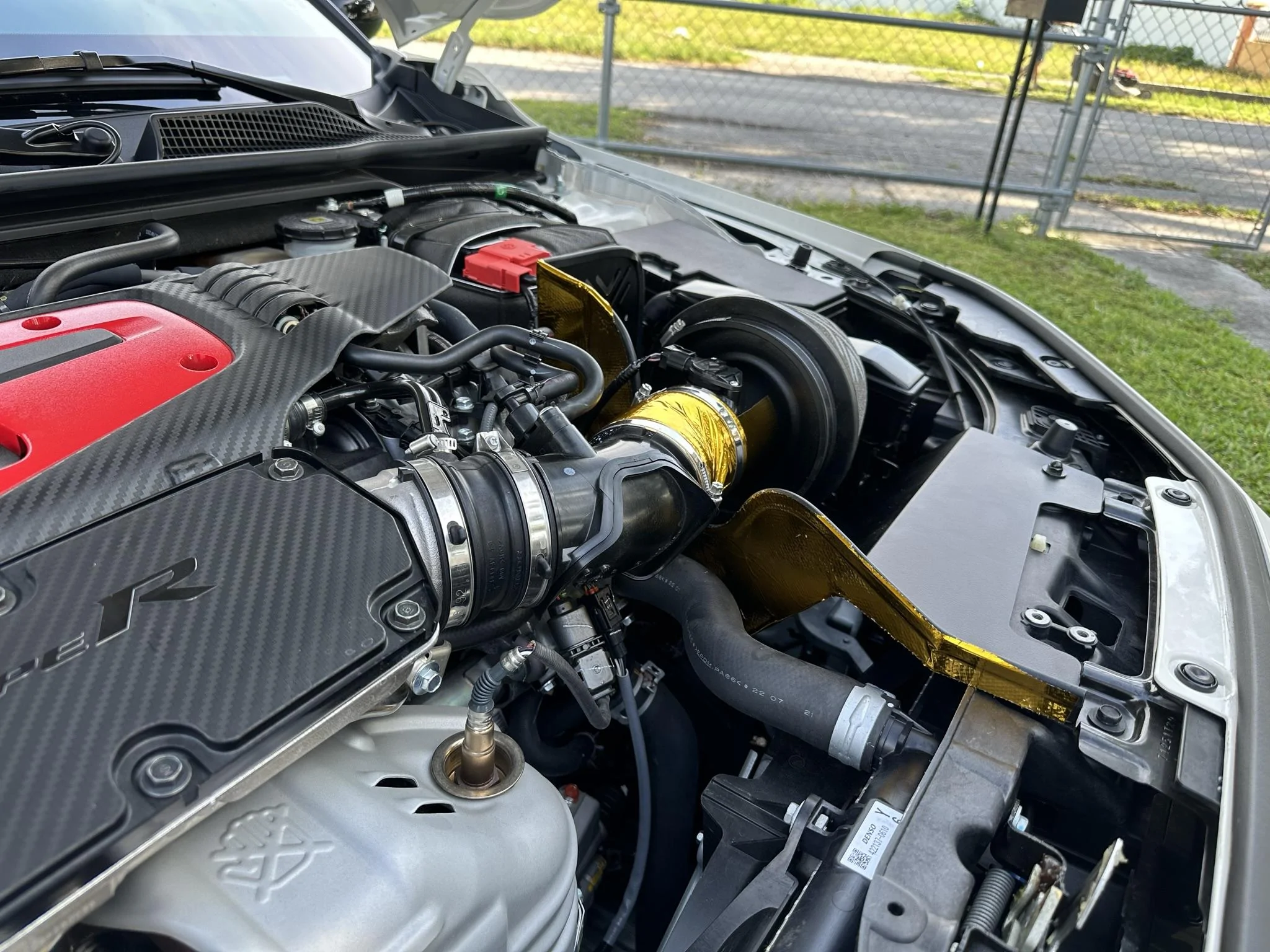

Not sure this heat tape does much because its pre-turbo. Would be cool if you are seeing lower intake temps after this though.
Is the charge pipe between the intercooler and throttle body wrapped too?
Just the short connecting tube is wrapped. Not sure how much it can do either but figured it couldn't hurt.

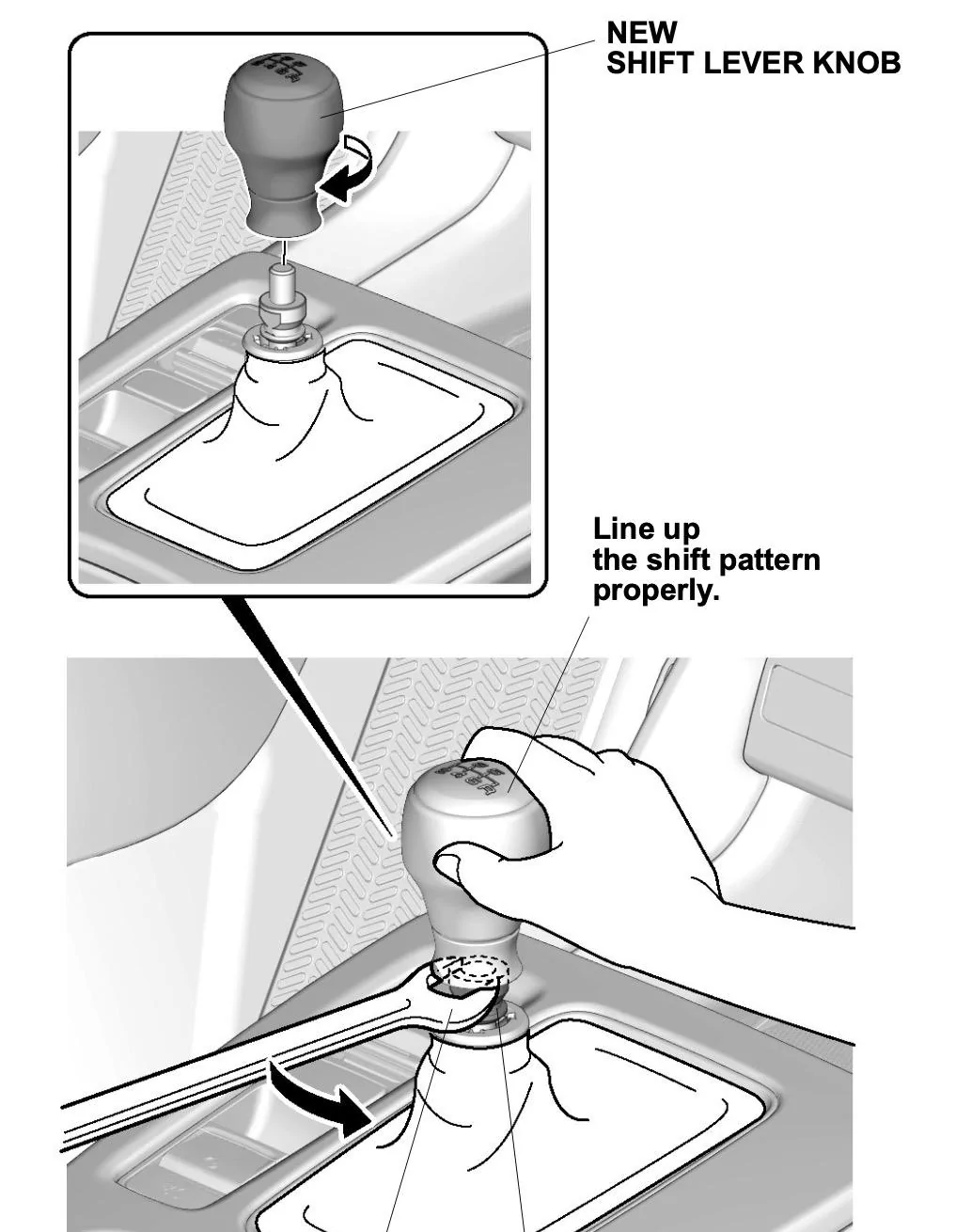

urbo73
Apr 7, 2023
253
346
I'm also doing the same install, and am at the final step.
Does the nut have to line up in a certain position before pulling up the boot and collar on it? See attached. Not sure if it needs to align with the collar. If it does, it's hard to get it aligned and also have the knob straight. What did you do?

urbo73
Apr 7, 2023
253
346
My thinking is to put the nut in the lowest position, then install the knob, line it up straight, tighten the nut, and then pull the collar/boot up on it. Just want to be sure the nut doesn't have to align with the collar.

Miami
2023 CTR #3177
This is correct, orientation of the nut doesn't matter - you adjust its height to snug the knob in the position you want.
