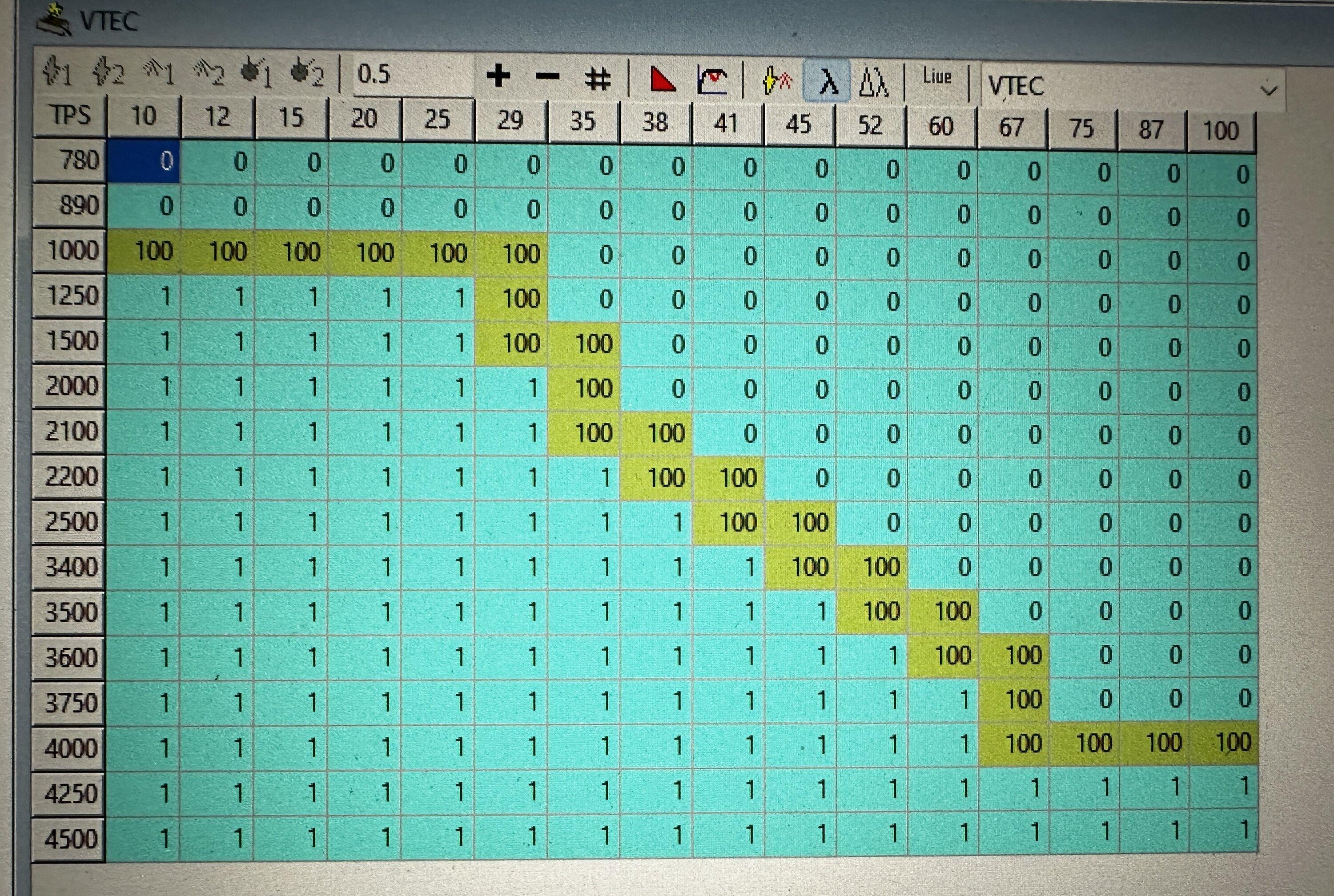

Here it is!
11th Gen Honda Civic What is the K20C1’s VTEC switchover point IMG_3241

Awesome, can I assume the 0 is the low lift cam and 1 is the high lift?

When I'm at 60% throttle and cross 3700ish rpms, I feel the motor increase in power. Kind of like old school vtec kicking in, yo!

And on this car you can’t really feel it change over but it helps with the breathing of the engine.
