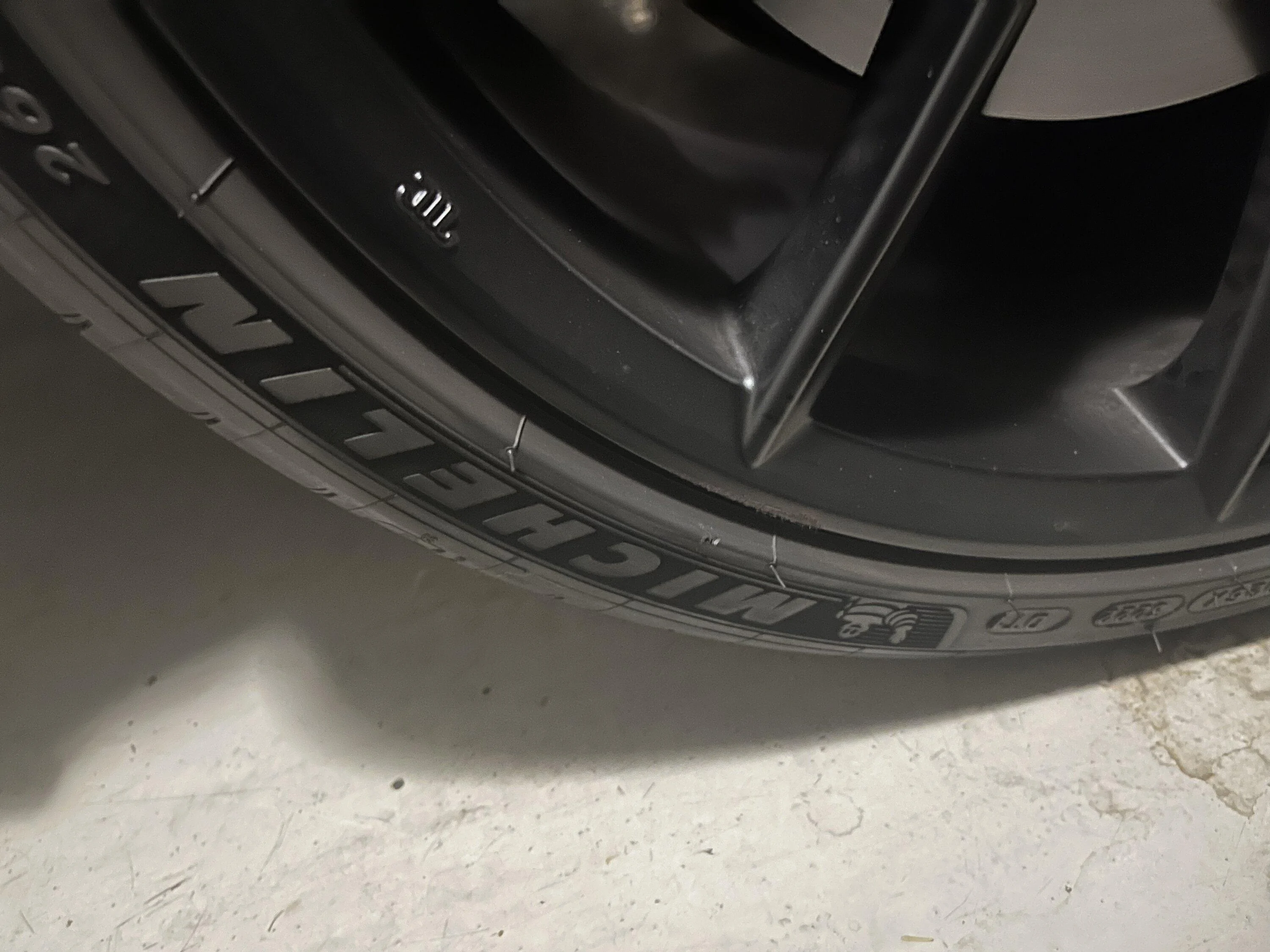

eh c’mon. Thats tongue in cheek no doubt. Thats like if you ask the doctor your diagnosis and he says ‘google it’. Or for that matter if anyone asks anything here, whats the point if we have google? If im wrong then i apologize to TypeRD, limitstions of text/internet. Any ways not gonna argue, took a sharpie to it for now until some paint comes out, definitely takes the anger away for now ?? . Thanks all

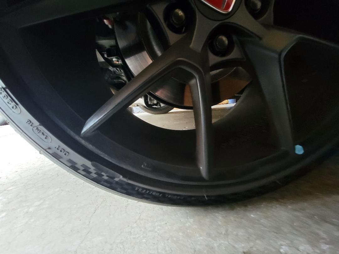

i had tried it once on a different car and found it hard to use normal sandpaper without scuffing up the surrounding area. where did you find fk8 touch up paint?
I did it too -- actually zapped the tire edge as well :oops:
but, i went to a repair guy who was recommended to me and he wasn't that helpful -- said he couldn't do it better than i would be able to -- that i should be able to easily do it myself. He warned that it would take a long time to get through the metal.
So, when i did the sandpaper thing, on the larger gouge, i ended up doing exactly what you did -- i scuffed a much larger area *ugh!* What i found was that these wheels are really soft aluminum -- i had posted about this earlier that i ended up going much deeper as well, since i had given it more muscle than needed. And, i had to use normal or fine sandpaper with either a careful fold or wrap it onto a small rod and work it carefully. That worked much better on the smaller gouge.
As to color... i was told by 2 different people to just use black -- but to make sure it was ZINC-based so it would adhere to the metal better... so that's what i did. I got one of the canister applicators at a auto shop that had a brush applicator. it did work out.
Once i realized how soft the wheel metal was, it didn't take that long... maybe 10-15 min of being REALLY careful not to trash the area around it.
However, If i ever do it again, tho... i'm thinking i may just try the sharpie thing before going through all that :p
Here's what it looks like -- this is the part i did properly... the other part isn't as pretty...

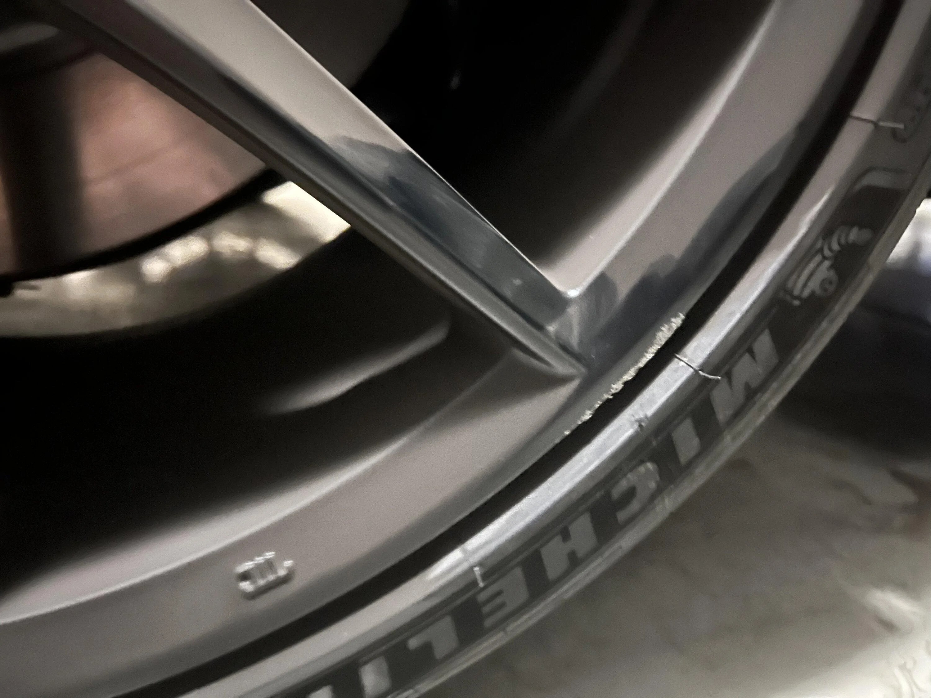

Well i did it. ??‍♂. Somebody tell me something good before i light it on fire and collect the insurance check. Luckily its not too deep so some touch up paint should make it tough to see. Called Honda and they dont sell touch up paint for the FL5 wheels. Somebody please give me another solution or i may just take a sharpie to it for the short term.
the color is satin black

Can confirm sharpie actually very close match. Since ive had the car a while now im pretty sure i rashed because the default view on the rear view camera i think is a little odd. Never had a prob backing around on my last car. Id fly into tight spots in reverse. This thing seems a little distorted. That second view option with the back up camera has been workinf a lot better for me since
