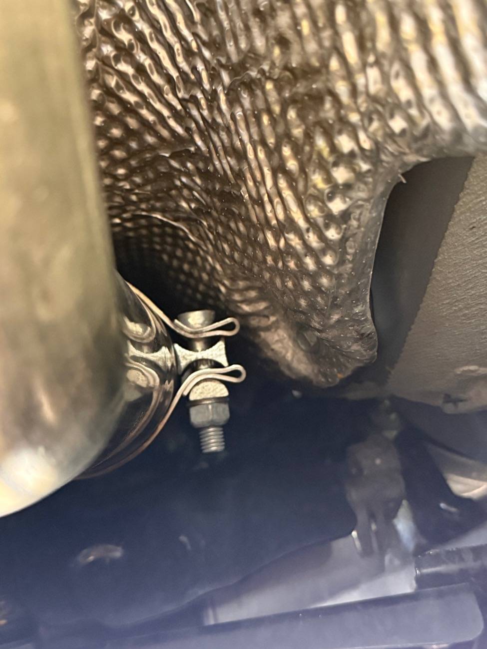

Hey good morning, just wanted to provide some info related to a horrid rattle I experienced with this exhaust (AWE Touring)
About a month ago, right below the driver/passenger area a noisy rattle began to occur once the car began to warm up (never went away. Upon investigation (assuming it was related to the exhaust clamp, I thought maybe it came loose) I discovered the exhaust clamp bolt bracket was literally touching the heat shield. This was 100% user install failure. I didn’t even think about it when I installed it but naturally I put it in this position because it is the easiest position to get a socket wrench in to tighten it when installing it on jack stands. If you have a lift I’m sure it’s easier or different feeling.
My reason for posting this is because I could see many people choosing to let this happen due to lack of forethought. I could be a singular outlier here, not saying this is everyone else’s problem on the exhaust. But I loosened the clamp and rotated the bracket down more and have driven it a little since then and my noise is gone. Picture attached for relevance.
I also want to point out I’m not attempting to defend any poor quality defects causing noise by AWE, but I want people to understand the failure that occurs needs to be understood before assuming a bad exhaust. This is a perfect example of failing to install it properly.
Hopefully it helps someone!
