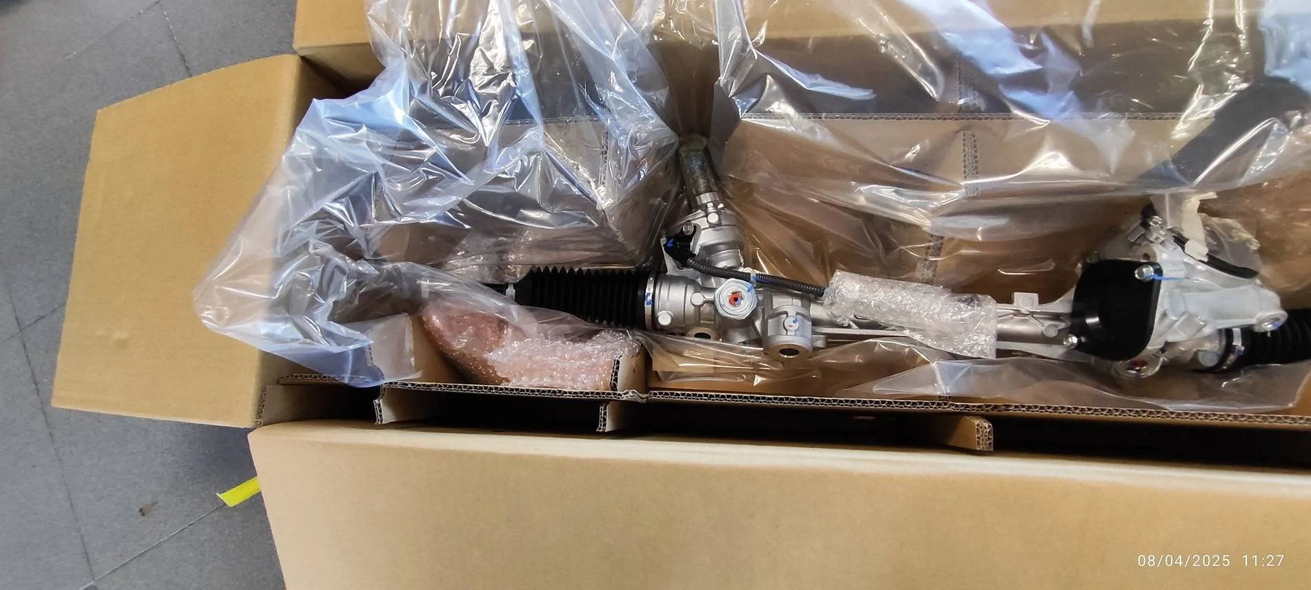

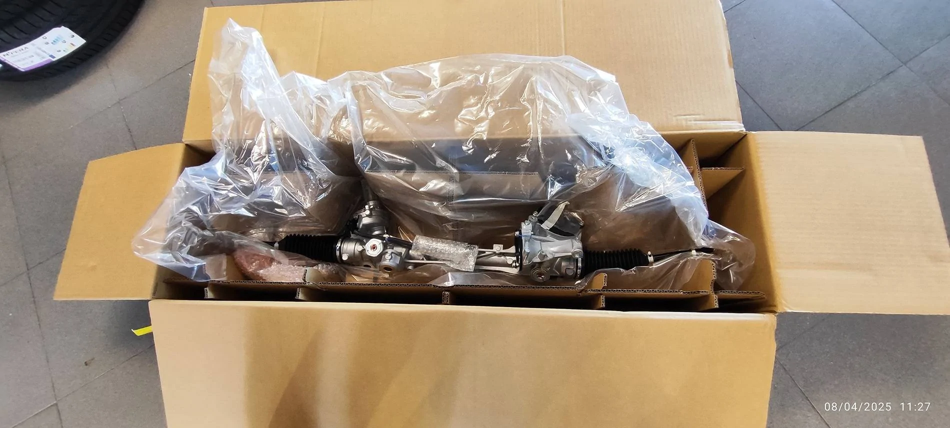

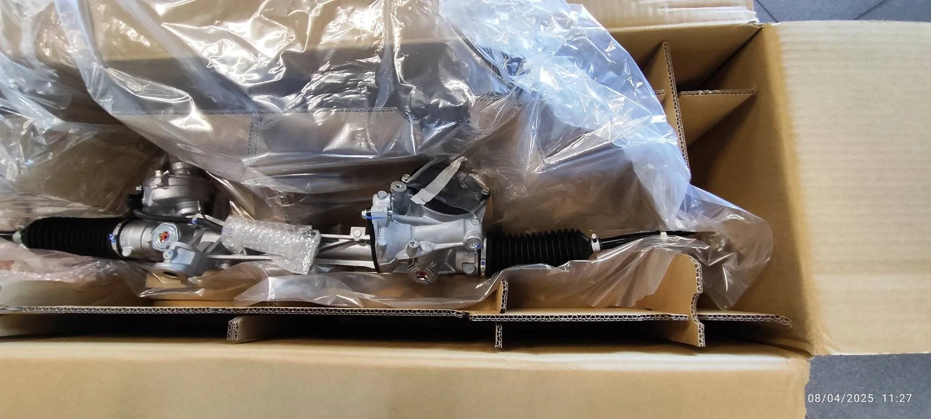

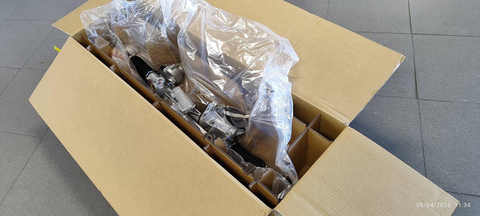

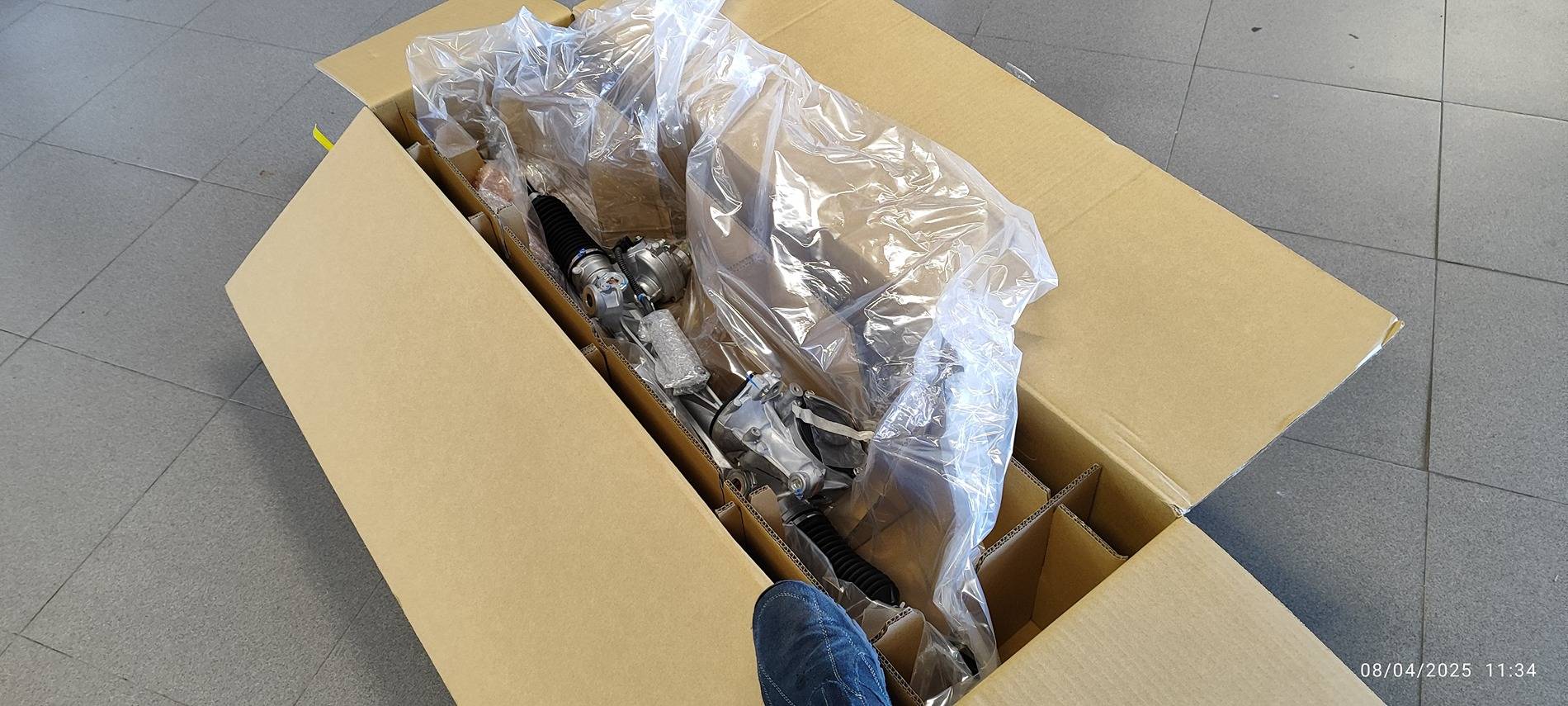

Greetings from Spain:
From what we've seen, the recall procedure for FL5s here is different from the one in the USA.
In our case, the entire steering box is being replaced. I'm uploading images of the part being replaced.
Naturally, this means removing the subframe and finally aligning the steering.
However, for FL4s (Hybrid), the procedure is the same as in the US.
Regards

For the FL4 hybrid, which is the only other model sold here, in Spain and rest EDM, the solution is the same as in the USA: inject more pink grease into the helical assembly and replace the small spring inserted into it.
