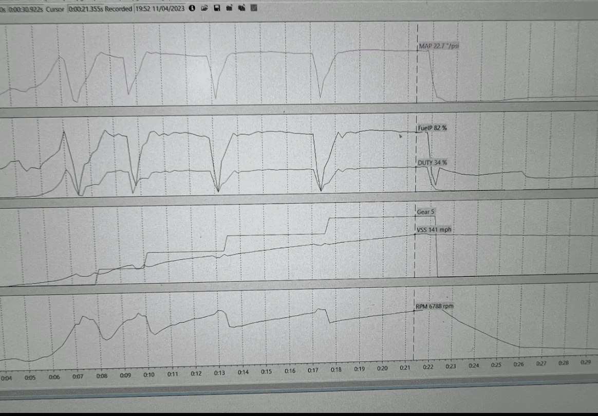

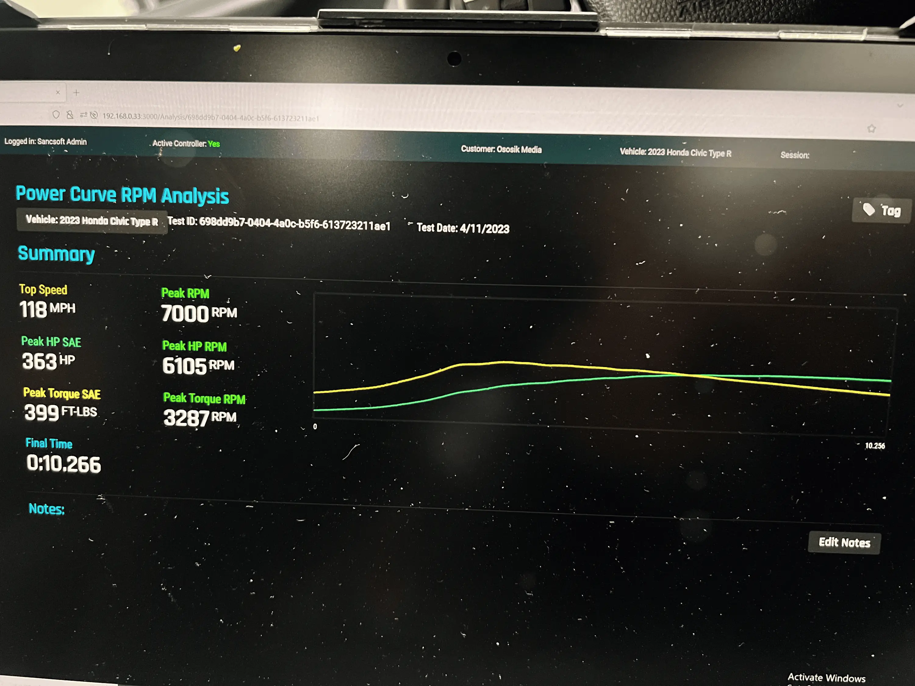

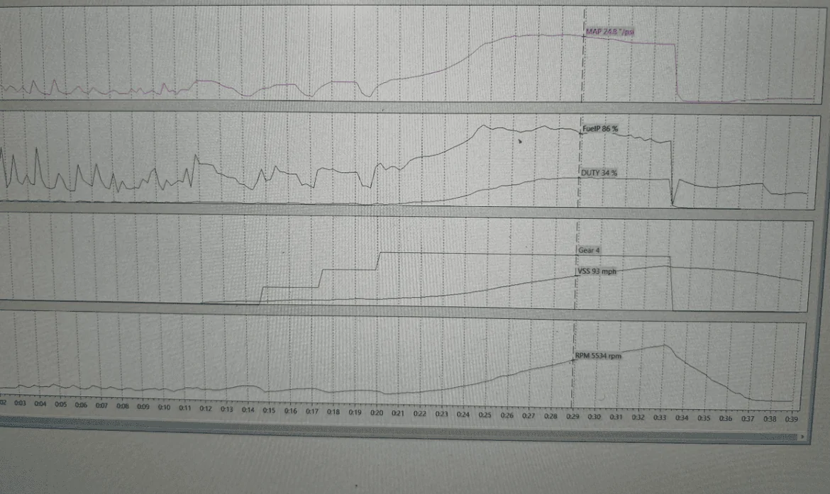

I've been driving the Civic Type R on ethanol for over a few months and as expected the stock Civic fuel system is still doing great. Over time pumps have been known to fail on FK8, so I assume the FL5 would be the same (I like pushing my luck though).
As of now the car is on a E50 ethanol blend, custom tuning done by Daniel at Powermetric. Currently the Hondata FlashPro does not support flex fuel tuning, but I read their post that it's coming soon! This is a cost effect (traditional) way of tuning with ethanol, without going the Flex Fuel Kit route, BUT I definitely recommend a flex fuel kit because of how much easier it is and well...flexible.
Below is a link of a Fuel write up I did if you're new to this:
https://www.civicxi.com/forum/threads/what-the-f.52111/#post-864077
For a stock Civic Type R fuel system an ethanol blend is the most optimal. You could tune for full Ethanol but I prefer getting the highest power output for the current state of the set-up. So until I have a fuel system that can support all the juice, blending it is. lol
During the initial test, the Civic Type R was stock except for Hondata FlashPro and custom tuning by PowerMetric.net on a E40 blend (ethanol & 91 octane).
PowerMetric Custom Tuning, Hondata 91 Map Results, Baseline on a Mustang Dyno (80+ degrees).
Dyno Pull (PowerMetric Custom Tuning):
11th Gen Honda Civic Civic Type R Ethanol Tuning & Dyno (Preliminary) Results - Ososik type-r-ethanol-dyno-results
11th Gen Honda Civic Civic Type R Ethanol Tuning & Dyno (Preliminary) Results - Ososik ethanol-vs-stock-civic-tun
11th Gen Honda Civic Civic Type R Ethanol Tuning & Dyno (Preliminary) Results - Ososik flashpro-type-r-datalog-002

On a serious note, I presume the 'SAE Historic' runs are stock baselines. Please confirm. Also, what are the mods and what is the ethanol content?

Aside from the custom tuning using Hondata FlashPro, the FL5 is stock (fresh out the show room floor).
And Daniel (Powermetric) knew it was time to work so he got comfortable with the slides aha. He’s tuned all my 10th & 11th gens.
