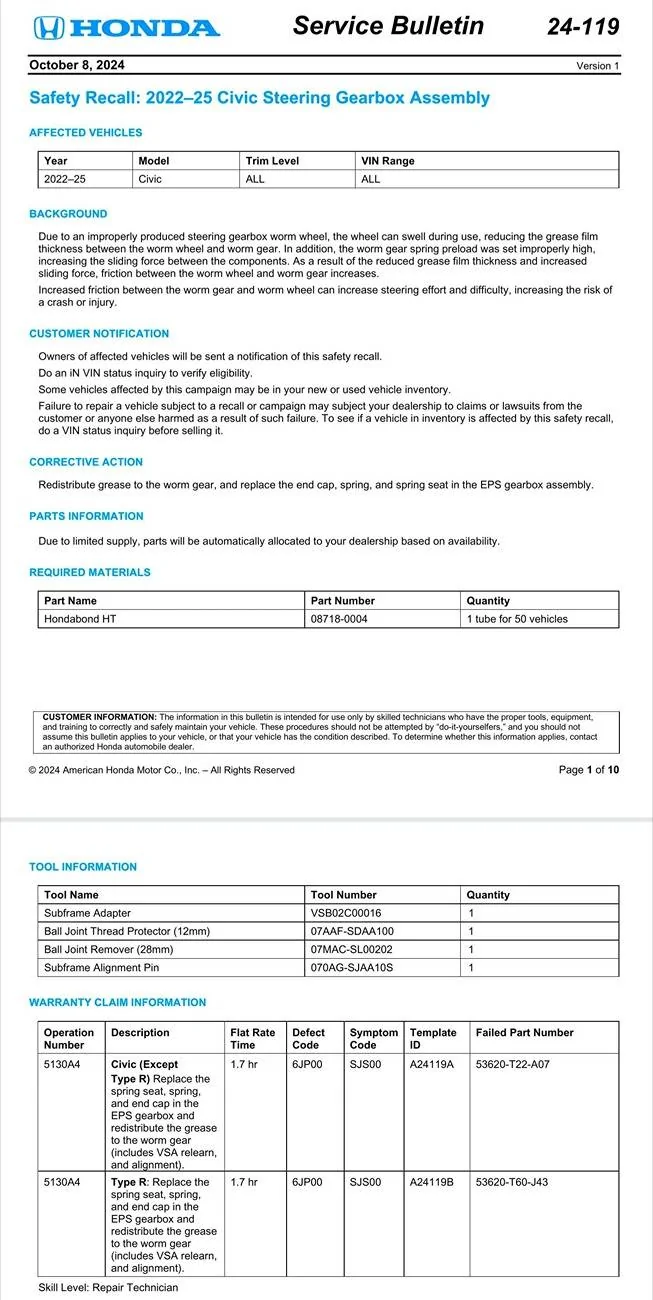

In addition to needing grease, I read that there may be a manufacturing issue with the worm gear spring. I suspect the grease issue is perhaps the more widespread problem and the worm gear spring only affects certain models built within a certain period…but that’s just a guess.

Read below. @DeVo posted the bulletin. We’re talking about the steering problem which has to do with the steering gear box (not the transmission).
