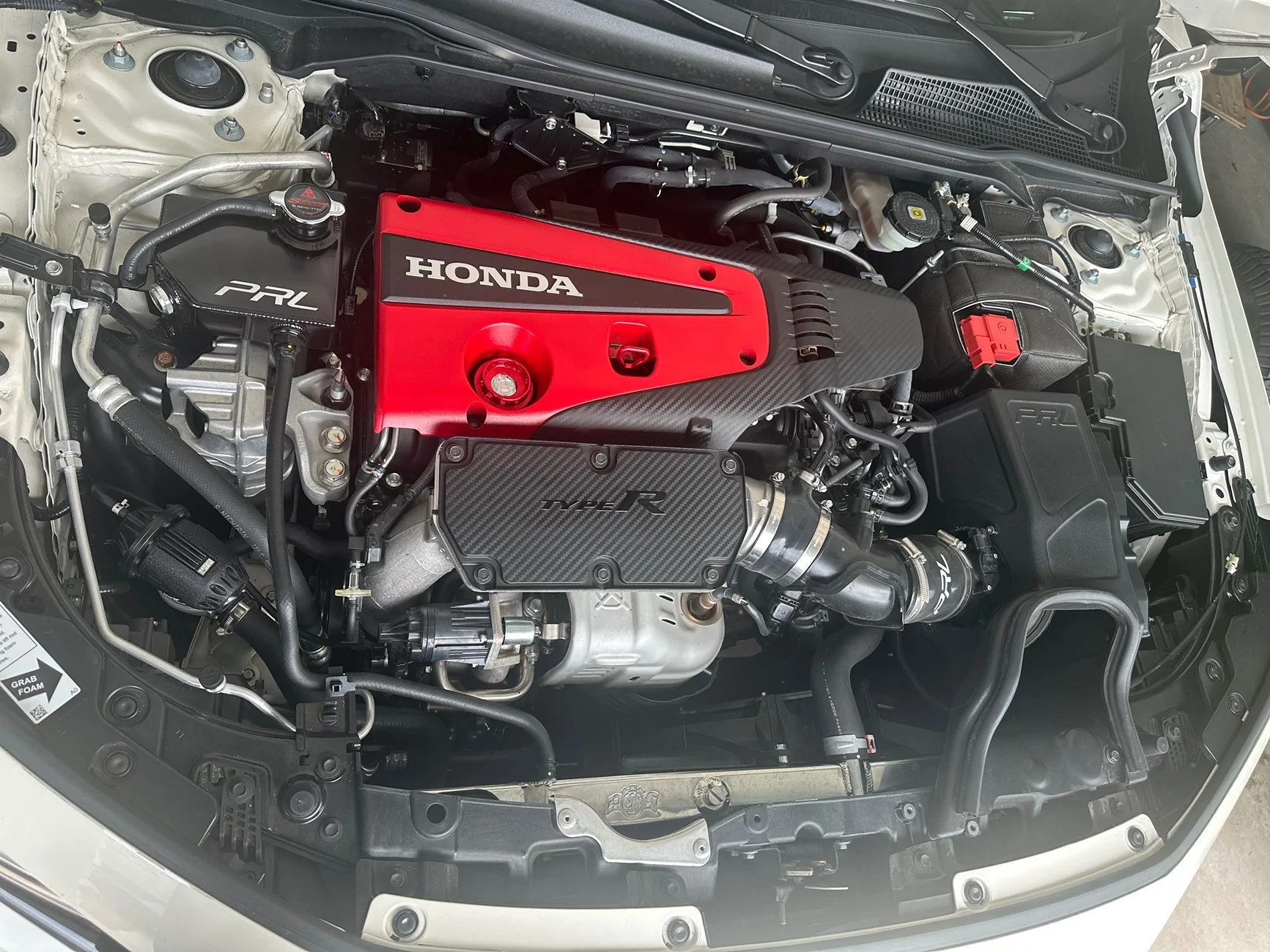

Last Thursday, I did a SCCA Track Nights at Sebring Raceway (in Florida) and the temperature was 86-87 degrees for both sessions.
Power mods:
PRL intake with AEM filter
TSP downpipe
Jester Tuned
Cooling mods:
HKS intercooler
HEL oil cooler
CSF radiator
WOT cooling plate
Removed rain guard from hood vent
Handling mods:
Rota slipstreams with Michelin Pilot Sports
OEM brakes/fluid, OEM oil, OEM coolant. (I felt ZERO brake fade)
The first session I stayed between 211 degrees coolant temps and 221 degrees until the last lap of the 20 minute session. I eclipsed 231 degrees briefly until coasted the last third of the straight away and low RPMed it around a curve which caused coolant temps to drop to 214 degrees as I passed the checkered flag! (Dropped 17 degrees in about 12 seconds)
A new BMW M2 started behind me and I pulled away. I passed a Porsche 718 and was about to pass a CT4-V Blackwing but the session was ending.
Session two i never went above 221 degees for whatever reason, I think I was just driving smoother and used less engine braking.
A new Chevy Corvette Stingray started behind me this round but I pulled away from him and ended up passing a Mustang GT350 before catching up to an old Corvette at the end of the session.
I am pretty much done with the car other then I have Hondata Canflex and Spoon Springs to be installed. But kinda iffy on keeping or selling. So my questions:
Do springs make a big difference with handling?
Would 5W30 oil help at all?
Would running E30 help lower temps as all?
