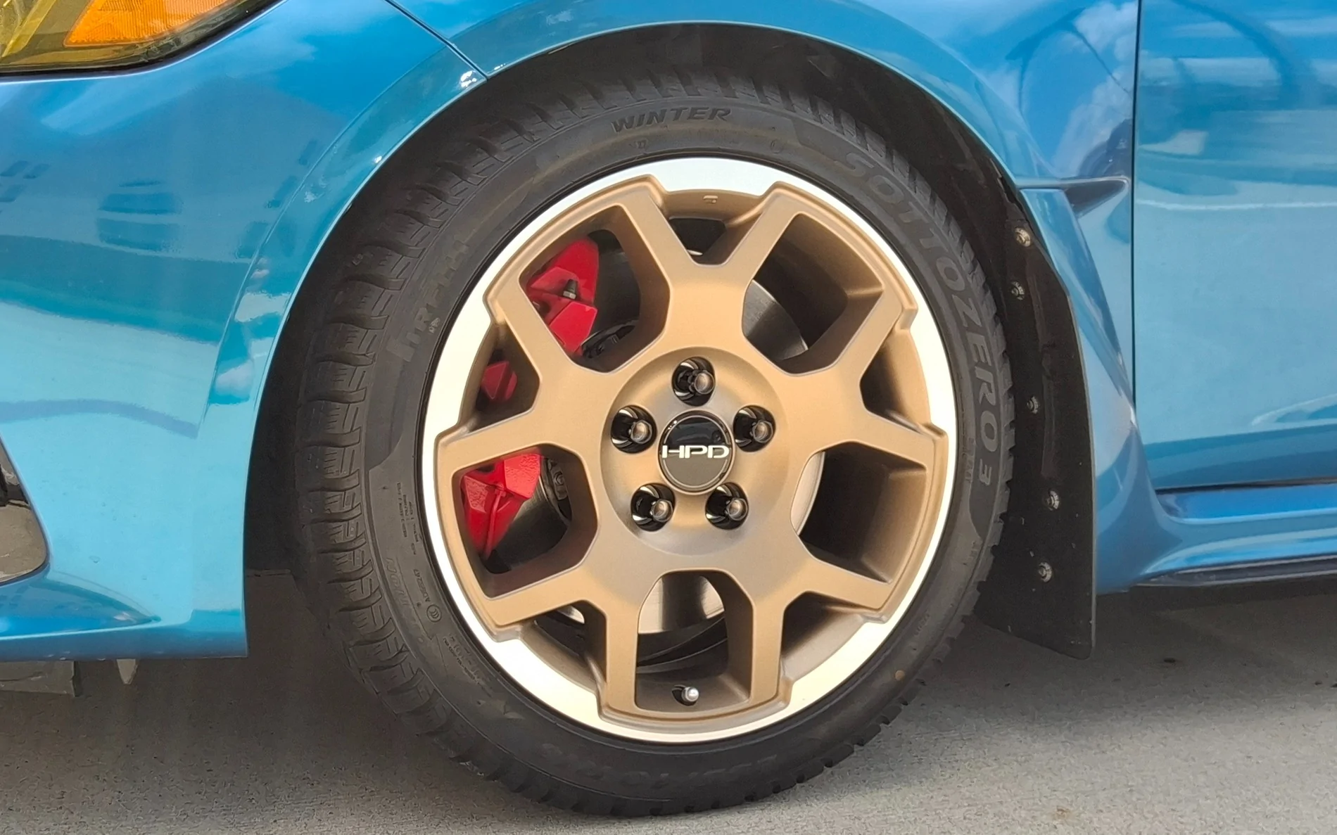

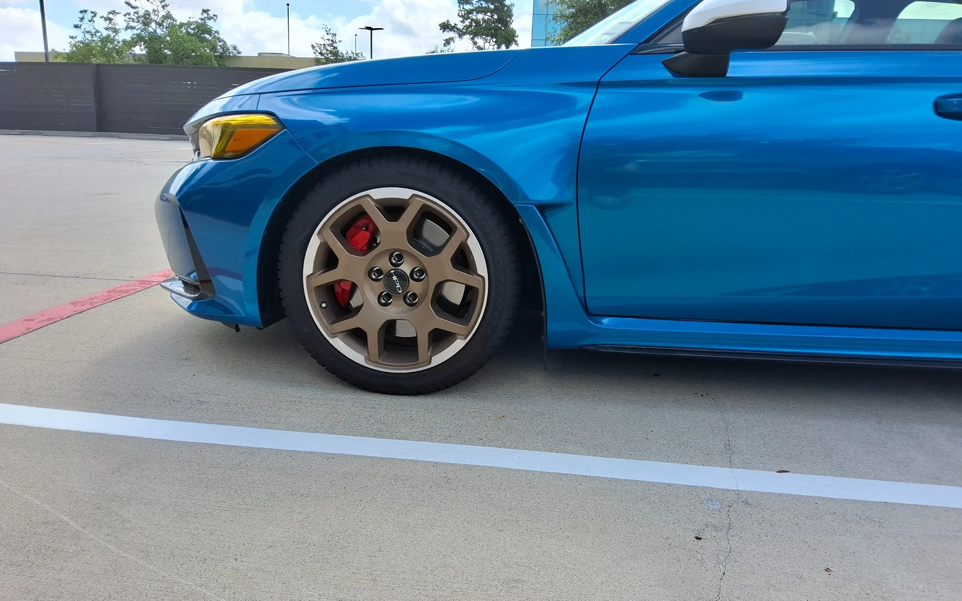

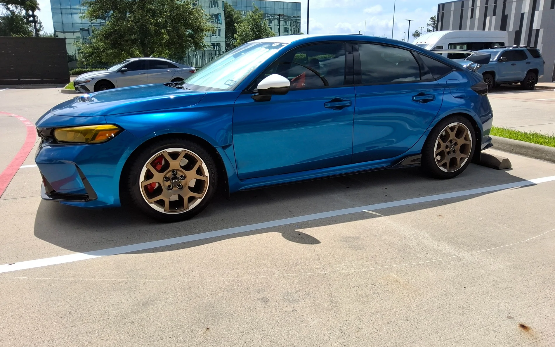

My FL5 is still on my Winter Setup, which is Honda Pilot HPD Bronze 18 X 8.0 SUV wheels, plus 20mm Eibach spacers, on Pirelli Winter Sottozero 255/40 R18 RF tires. The RF stands for Run Flat.

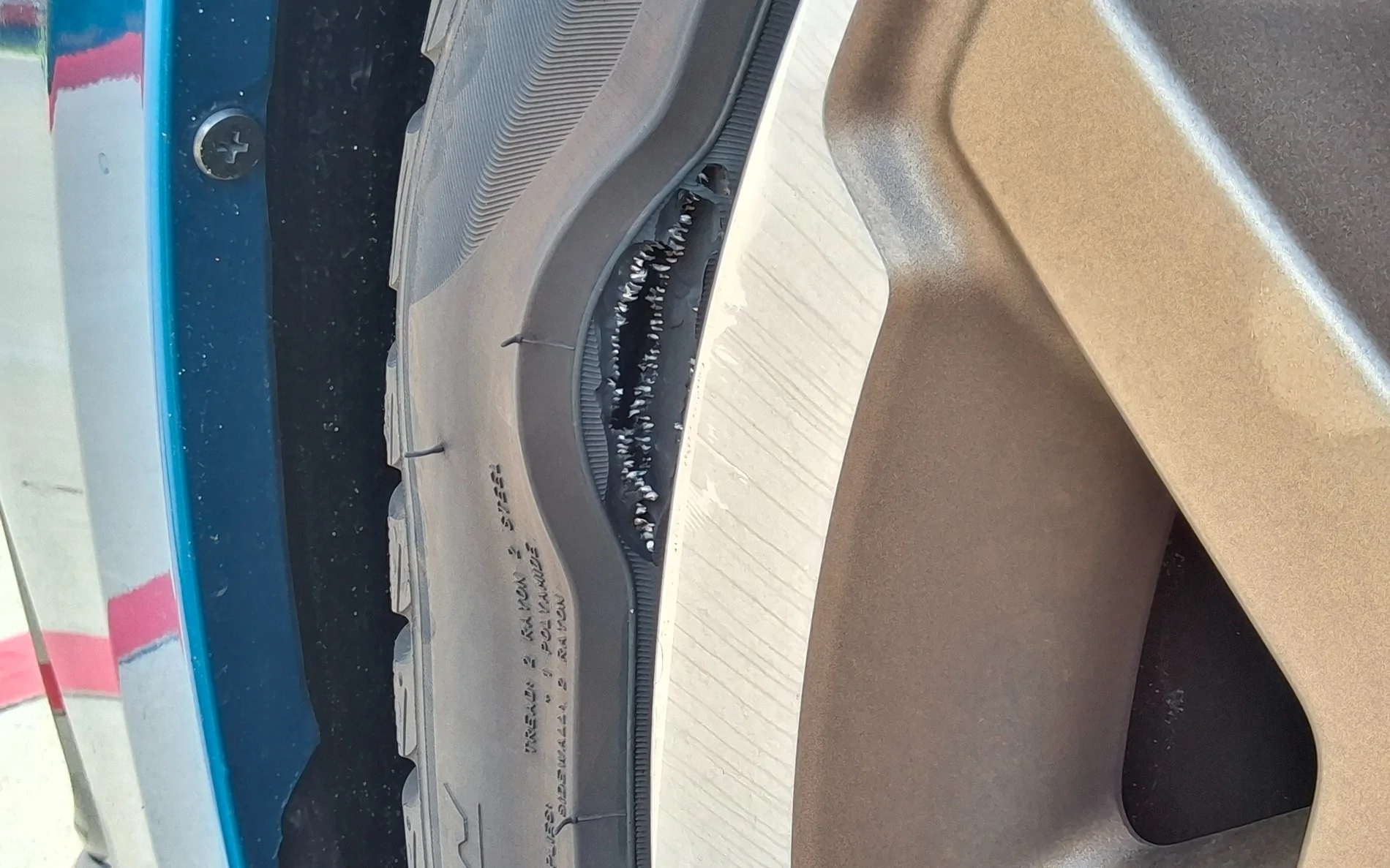

Yesterday, Saturday, May 23rd, 2026, I drove my FL5 up to Kingwood (I-59 N) with a buddy of mine for a day trip to see another friend. Around 7:00 P.M. we were heading back to my hotel, which is in the West Houston / Bunker Hill area on I-10 W.
While driving about 63 or 64 MPH in the far left lane on 610 North Loop, Westbound, as I was passing the I-45 interchange, I saw a wide pothole up ahead in my lane and braced for impact. I let off the accelerator but I did not brake. Speed was about 61 MPH when the tire hit the pothole.
BOOOOM! It was LOUD.

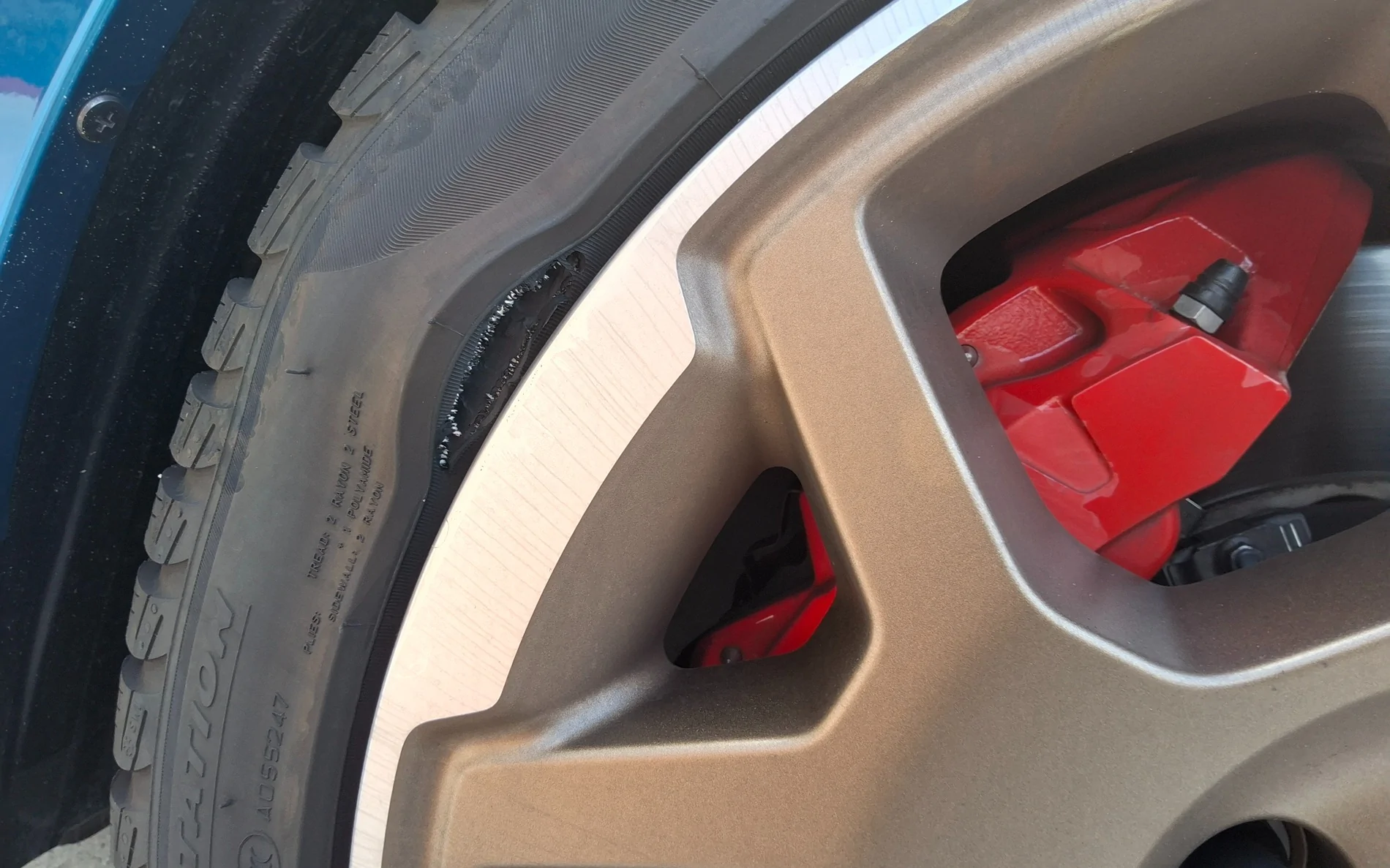

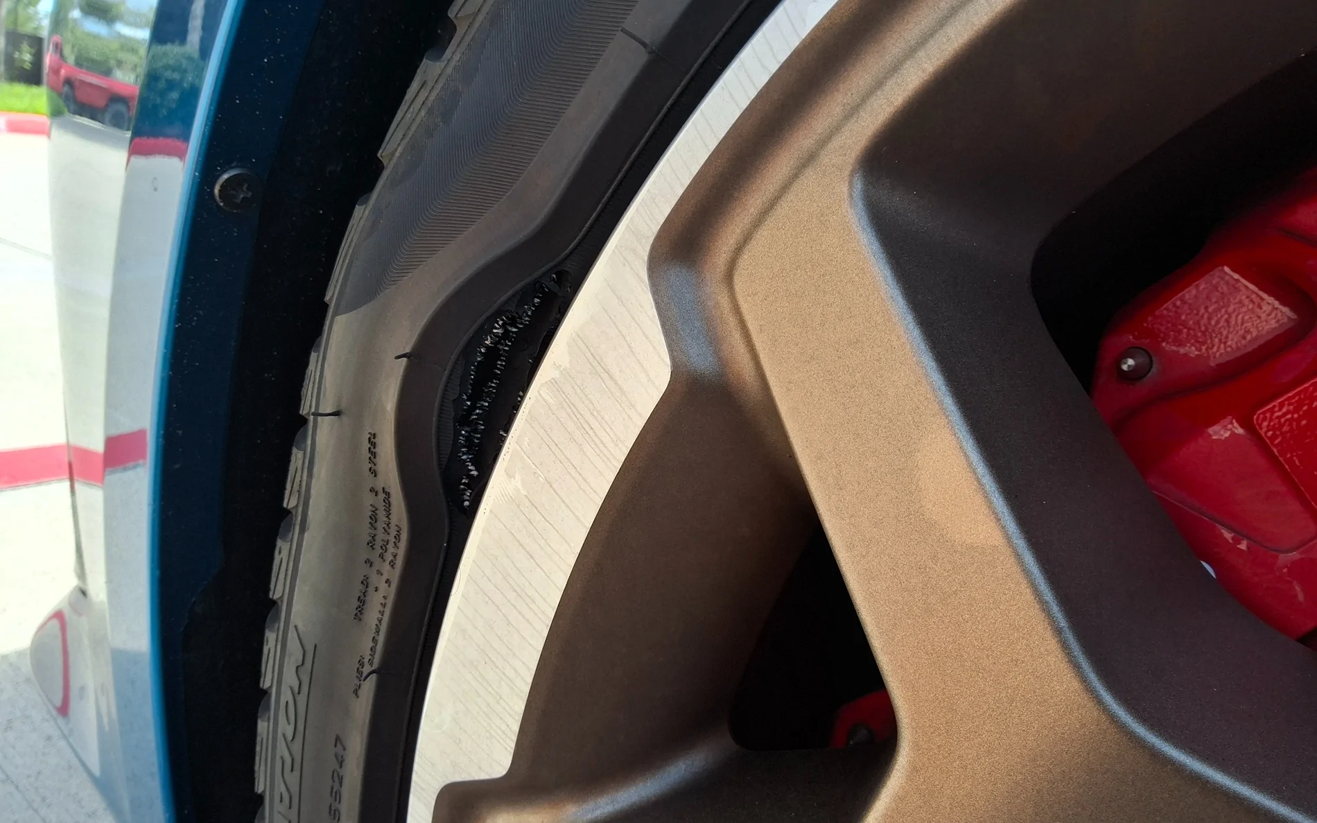

The pothole was really deep, probably at least 3 inches. The impact was so loud that I thought the frame of the car scraped the edge of the pothole. My FL5 is still stock height and stock camber.
I didn't consider the possibility of a blowout, which is really the first thing that should have come to mind, because I thought the car may have bottomed out on the asphalt. I still need to get that checked once I get back to San Antonio.
The drive after hitting the pothole was not noticably different than before impact, so I kept on truckin'.
We made it the rest of the way back to the hotel just fine. After I parked, we checked for damage.
There is a big ass tear in the sidewall of the tire, but somehow, no major visible damage (so far) to the wheel.

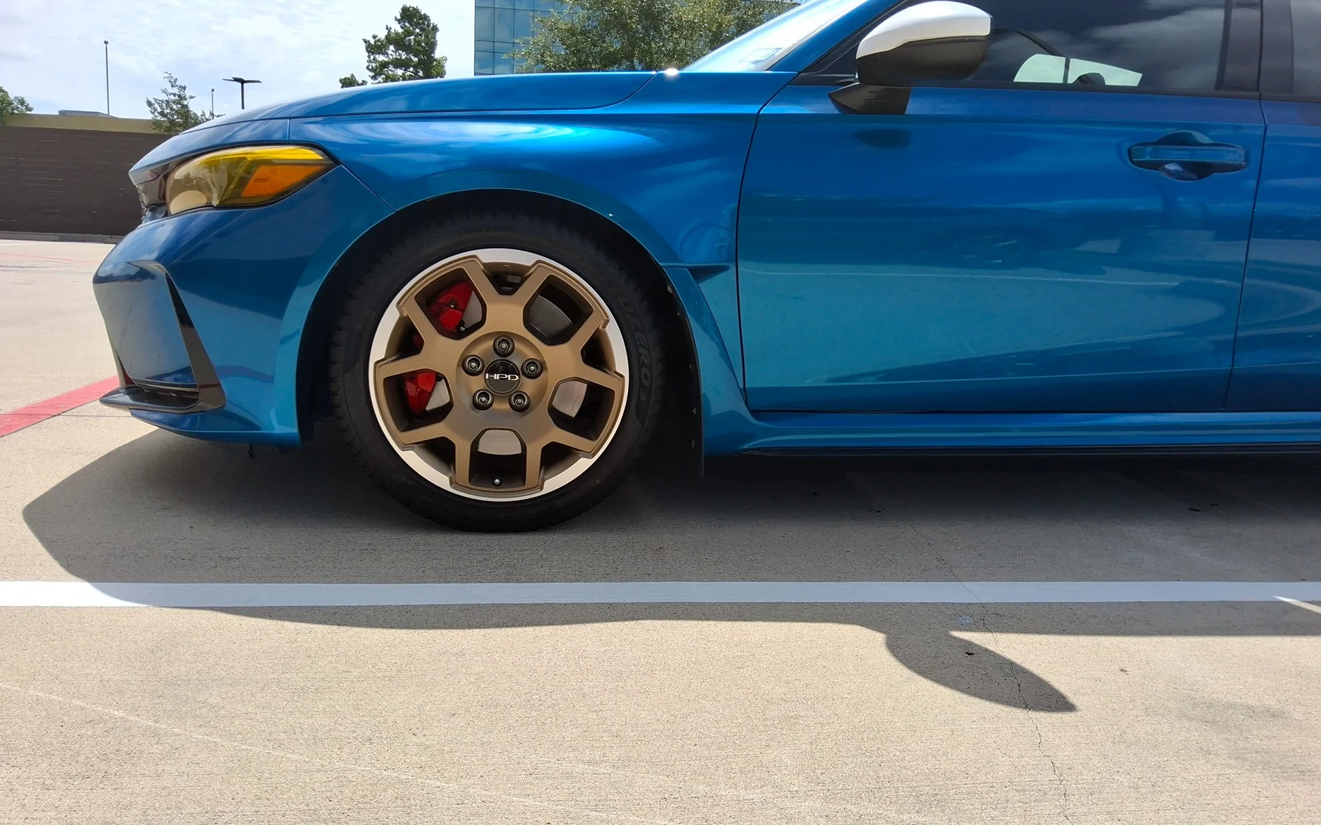

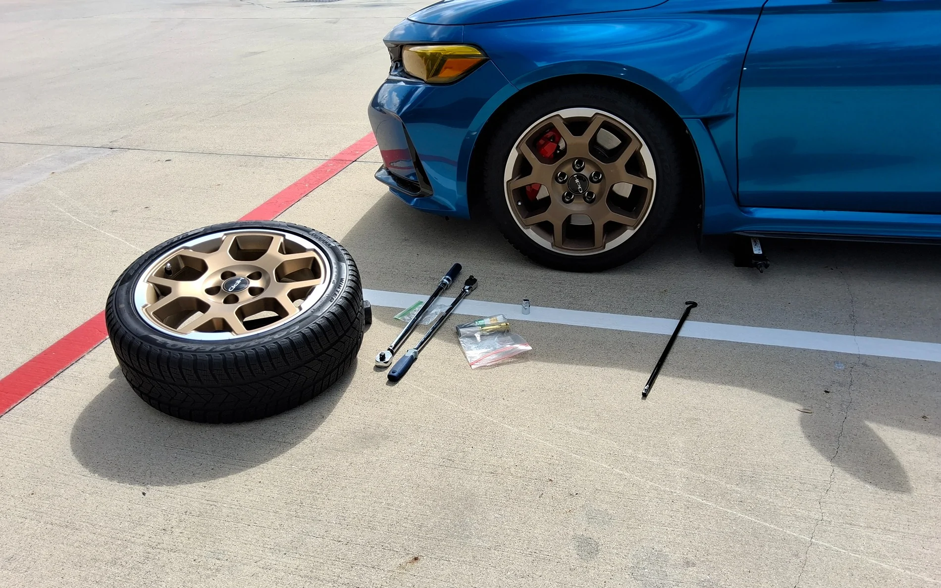

After ordering the Honda scissor jack kit, I went out to the parking lot and changed out my wheel.
I got lucky, too, because the spare tire has the V tread facing the same direction as the busted tire!
11th Gen Honda Civic The Importance of Carrying a Full Size Matching Spare Wheel & Tire 20260524_102914
Wheel swapped. Good to go.

Yeah I'm still not sure whether having thiccc heavy SUV wheels and / or Run Flat tires may have saved me from a REALLY bad day...
The combination of the two, maybe ???, prevented potentially much worse damage.

I had a similar pothole experience.
The wheel survived, but the tire sidewall was pinched between the rim and the tread, just like yours. I only had the mini-spare and the blown tire was the right front.
So, I jacked the car until both right wheels were off the ground, took the right rear off, put it on the front, and put the mini on the rear.
I was only about 30 miles from home, so I drove home on some back roads rather than the highway.

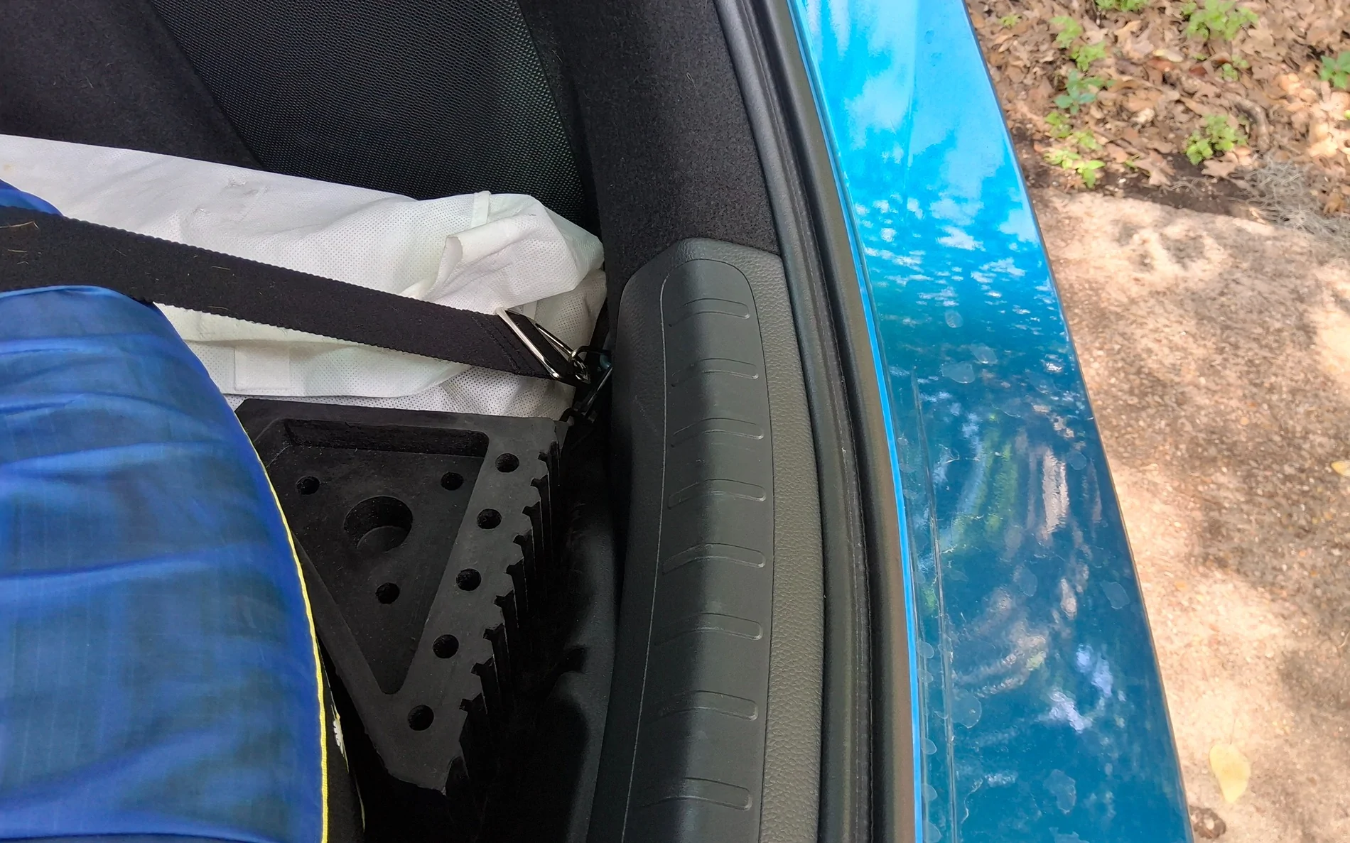

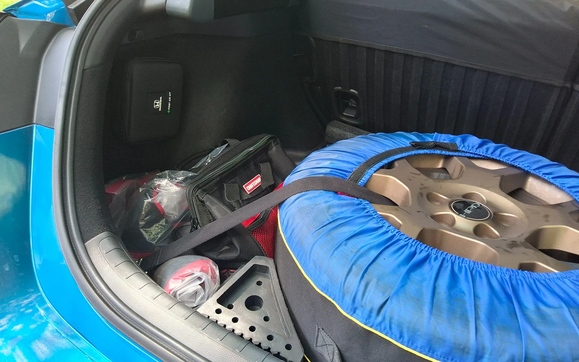

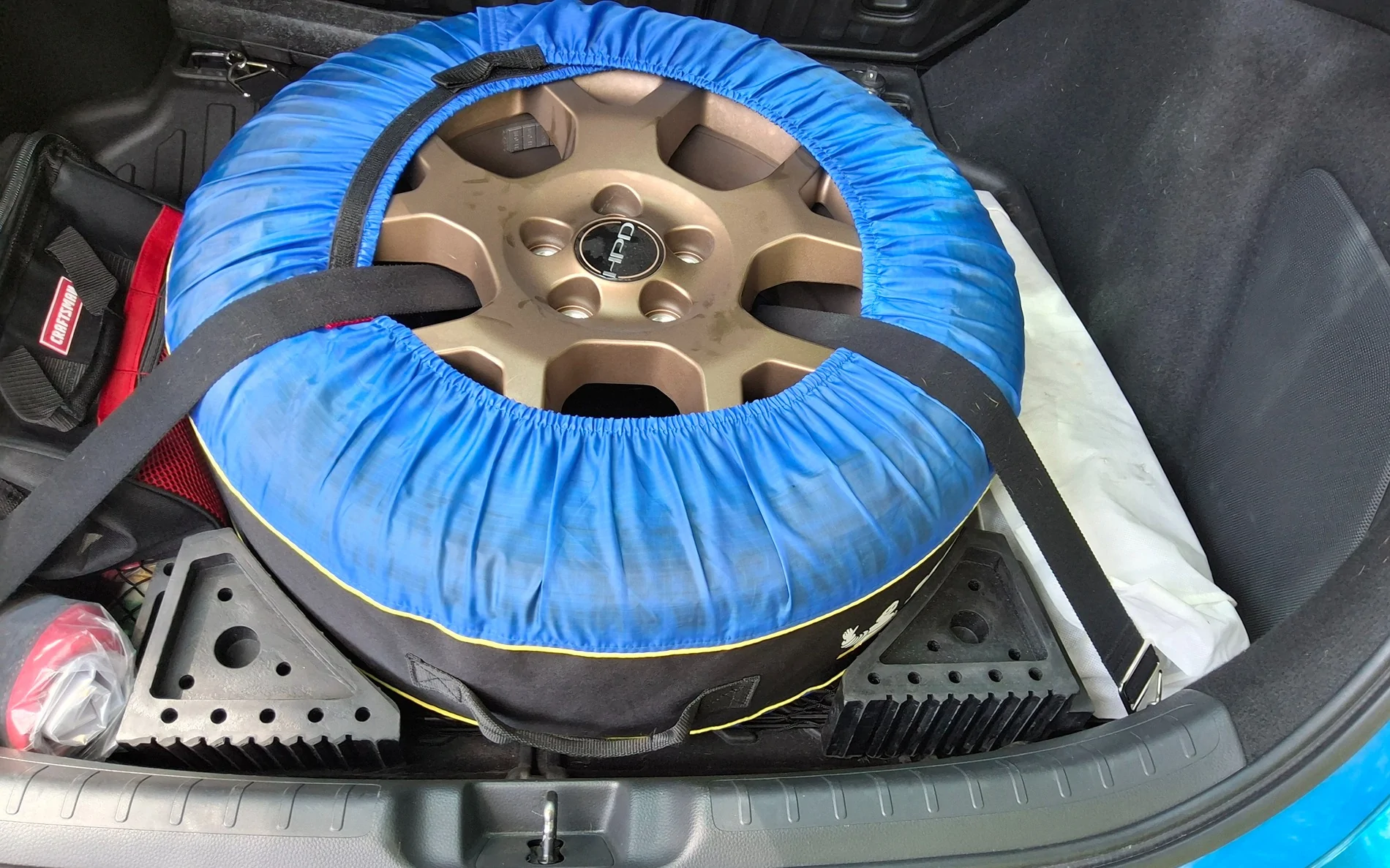

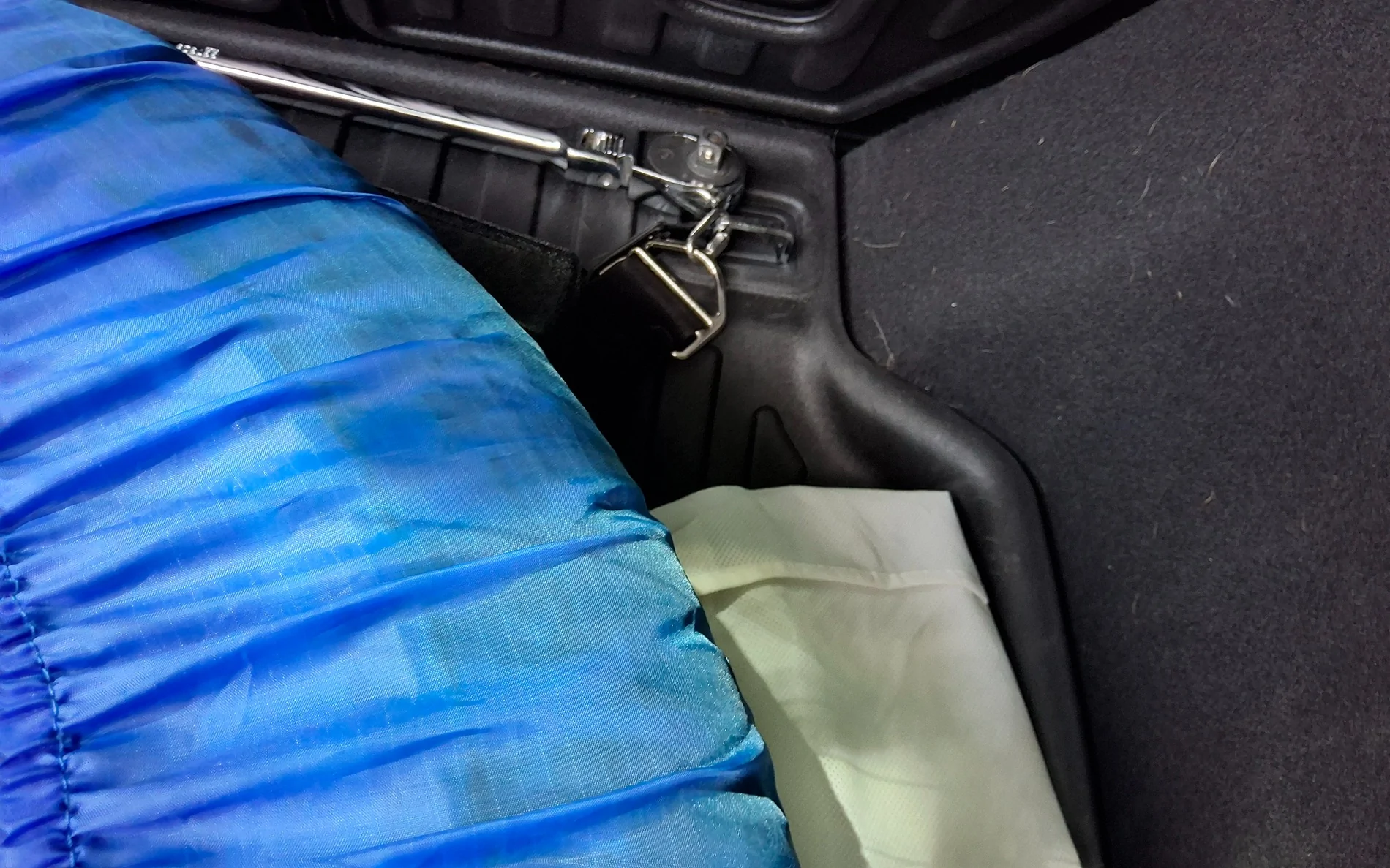

I just carry the wheel right in the center of the trunk, Velcroed down with elastic straps.
Went to Home Depot and bought some cheap locking oval rings and 4 elastic Velcro straps. The Velcro straps have built in loops. I cross the front straps underneath the wheel and Velcro them to the straps over the top of the wheel at the opposite corners.
The Tire Tote protects the wheel from getting scratched by the Velcro straps, hopefully.
This setup will keep the wheel at the back end of the trunk secure to the floor and keep the wheel from sliding side to side.
The red Craftsman bag holds a pair of jumper cables. In the white bag is the scissor jack kit for the Wrangler.
All the tools in the trunk, however...
I still need a good solution for that. Maybe a nice duffle bag.
11th Gen Honda Civic The Importance of Carrying a Full Size Matching Spare Wheel & Tire 20260524_153920
Oval locking ring.
11th Gen Honda Civic The Importance of Carrying a Full Size Matching Spare Wheel & Tire 20260524_153927
11th Gen Honda Civic The Importance of Carrying a Full Size Matching Spare Wheel & Tire 20260524_153947
11th Gen Honda Civic The Importance of Carrying a Full Size Matching Spare Wheel & Tire 20260524_153933
I keep a pair of wheel chocks behind the wheel.
11th Gen Honda Civic The Importance of Carrying a Full Size Matching Spare Wheel & Tire 20260524_153951
11th Gen Honda Civic The Importance of Carrying a Full Size Matching Spare Wheel & Tire 20260524_154007
Obviously, all this stuff in the trunk puts space at premium.
Most of the time it's just me and my dog, so I'm not too worried about the space saving right now.
Eventually I'll have to get some proper feng shui going in the trunk at some point.
