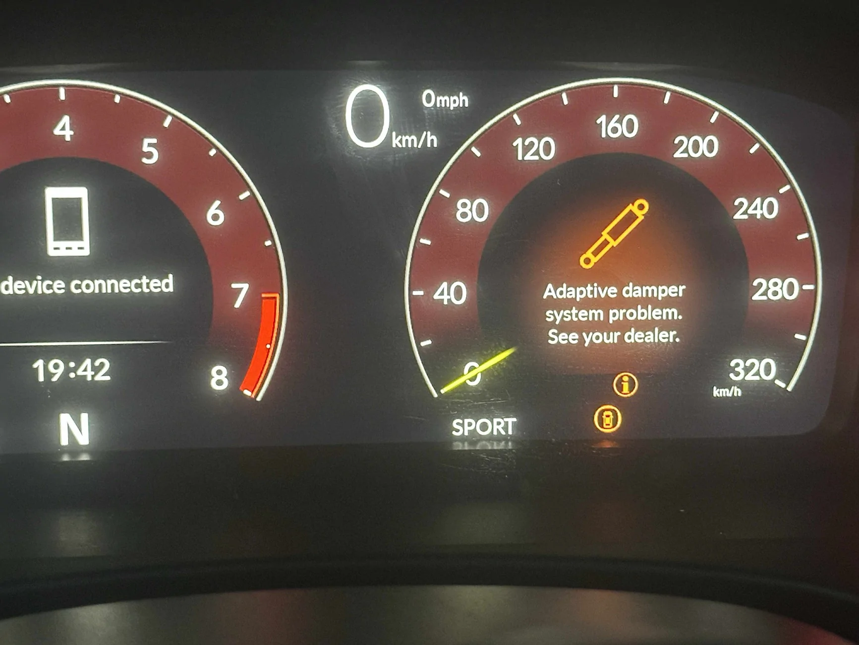

I'm in the final stages of rebuilding my Civic Type R FL5, and everything is nearly complete. However, I've encountered an issue: I'm getting an "Adaptive Damper System Error – See Your Dealer" message.
I've checked all four wiring harnesses, and they are fully intact. I was able to successfully clear the check engine light and collision history using a basic mobile OBD scanner.
My question is:
Does this Adaptive Damper System Error require a more advanced diagnostic tool (like a professional tablet-style OBD), or is there a way to reset or clear this error through hidden steps or procedures?
Any advice or shared experience would be greatly appreciated.
Thanks in advance!

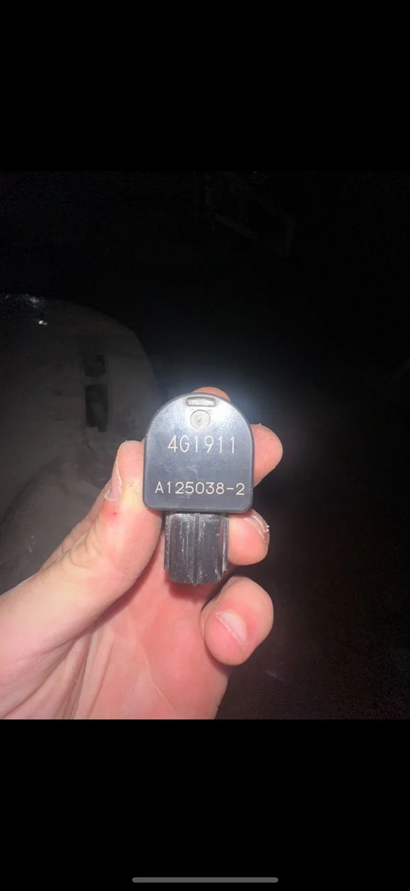

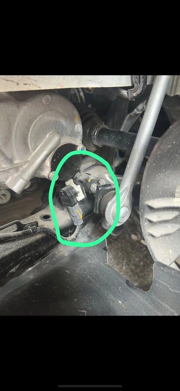

Fixed!!! “adaptive damper system see your dealer problem” it was headlight right sensor. I had spare sensor from back suspension, transferred to the front iron body plugged in and instantly error is gone

I scanned with launch obd scanner , error was lost communication to the right sensor (i thought it was only for headlight), every wiring seemed fine so i just plugged headlight sensor wiring (even damaged sensor fixed it) and it worked.

I guess hanger just makes sure it is fixed positioned (i guess when cornering it should be levelled at the same height, as it has 4 of them on each wheel ) . there is no other use than that i can think of. its just a wire whicu should be plugged.

I cant find this sensor anywhere? Do you know what i need to look up
scottjua
Scott
Jan 4, 2019
143
65
Plano, TX
2025 CW FL5 Type R, 2019 SGP FK8 Type R
I think he meant “ride height” sensor???
