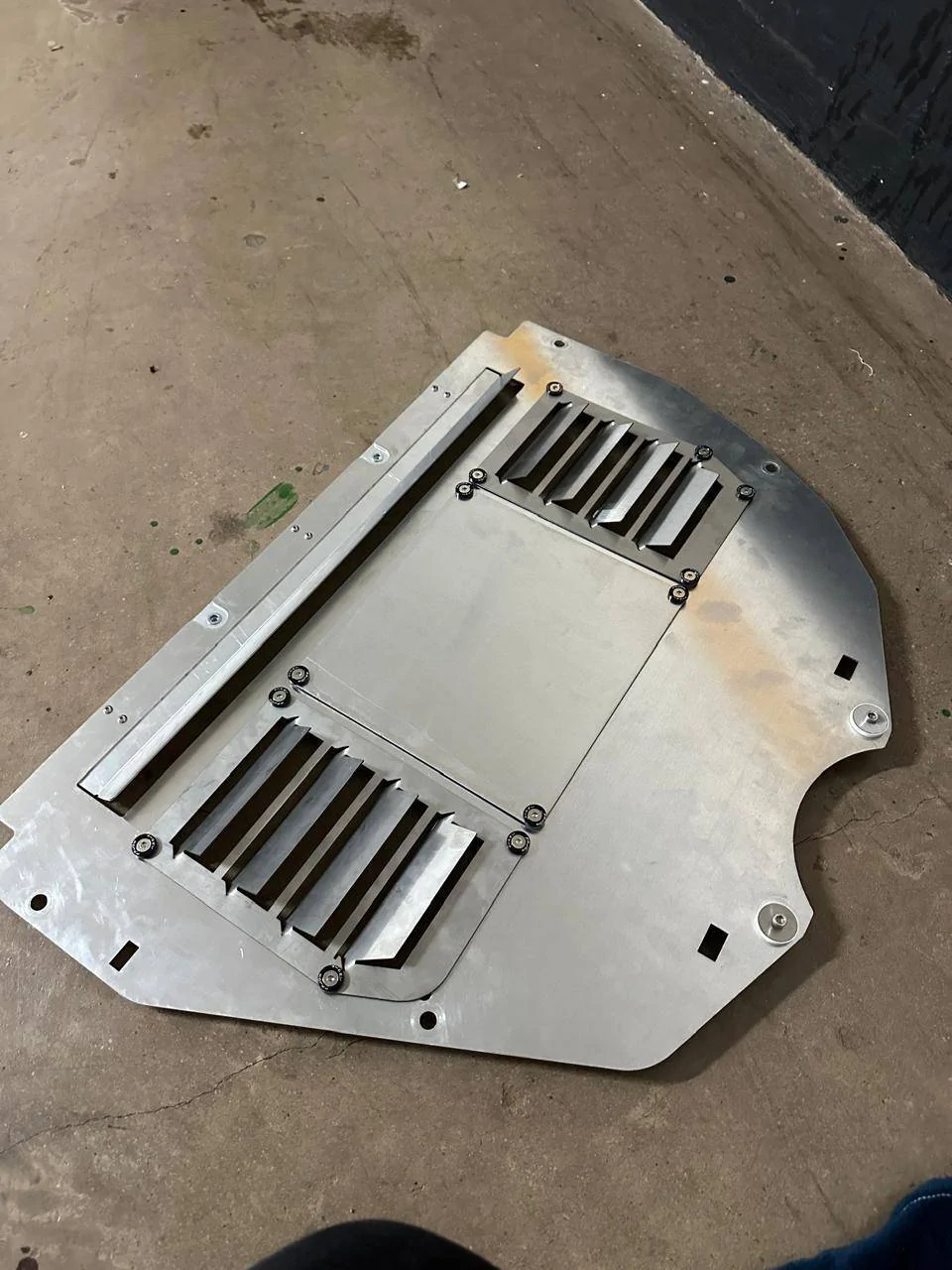

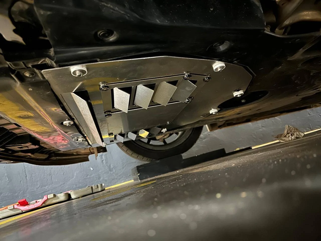

Did this fix the overheating issues?
along with a PWR radiator, an engine oil cooler, transmission oil cooler, low temp thermostat, lots of ethanol and many fueling mods to run a very rich tune and a catless downpipe, no.
lol.
But It's a lot better then stock and I put down over 500hp.
I can do like 1 lap with full power on a F1 level track and finish around 220F
2 laps at 400-420hp @ 225F
It would probably work well on 70F maybe enev 80F weather. Here is always over 90F
