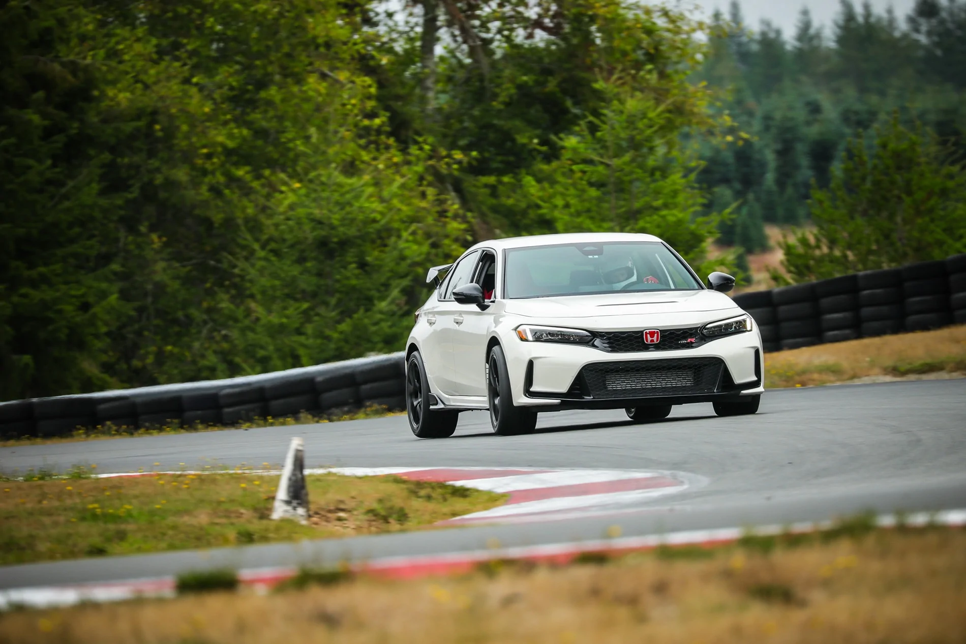

Hey everyone, dropping in to say hi before my first track day at The Ridge in my FL5. I have a good amount of track experience on my GR86 (and BRZ before it) but have never ventured into FWD territory.
I've got the car mostly prepped with CSG C1XB pads, fresh Endless RF650 and 5w30, and the WOT cooling plate. Then I splurged on the labor day sale for a set of Apex 18x9.5 VS-5RS. Just had 275/35R18 RE17RZ mounted.
Can't wait to see how this thing does!
For next time just get 265 if your running 9.5 wheels feels better on turning also for me just an opinion im running 275 on my 10.5 and they felt great. I tried them on the 10 car felt weird idk.

Agree - I have V730 275s on my 9.5s and it’s a bit of a bubble fitment. I told myself I would either get 265s next time or bump up to a wider wheel.
