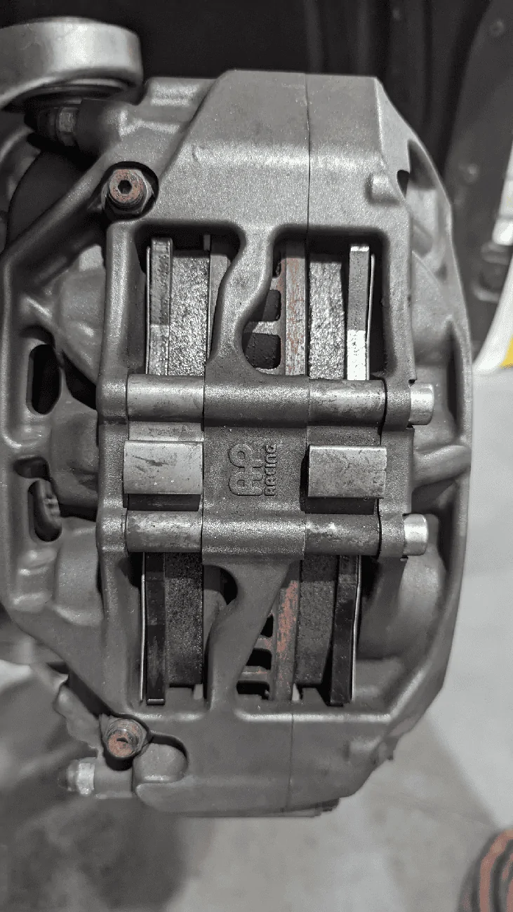

I see that your wheel is 18s. what is the offset size of those?
I seem to remember at one point when I was doing research on BBK's that I found that the Paragon kit was made in China. I could be wrong, and this may not be the case, but I know for sure that the rotors are based on previous research. I'm not a fan of Chinese quality control, and do my best to avoid products constructed in that country. (Just personal preference). AP/Essex is overpriced, and I'm sure they didn't start out that way, but proven products tend to increase in price as the years go on. They're tried and true, and track proven. The Essex rotors are made here in the United States (So is GiroDisc). The Paragon brake pads are made by Wimax in Japan (I'm very comfortable with Japanese quality). These were the reasons behind my decision.
I no longer use the Paragon pads for the front's (I use Ferodo DS3.12's), but I do use Paragon's in the rear, and they seem to stand up pretty well!

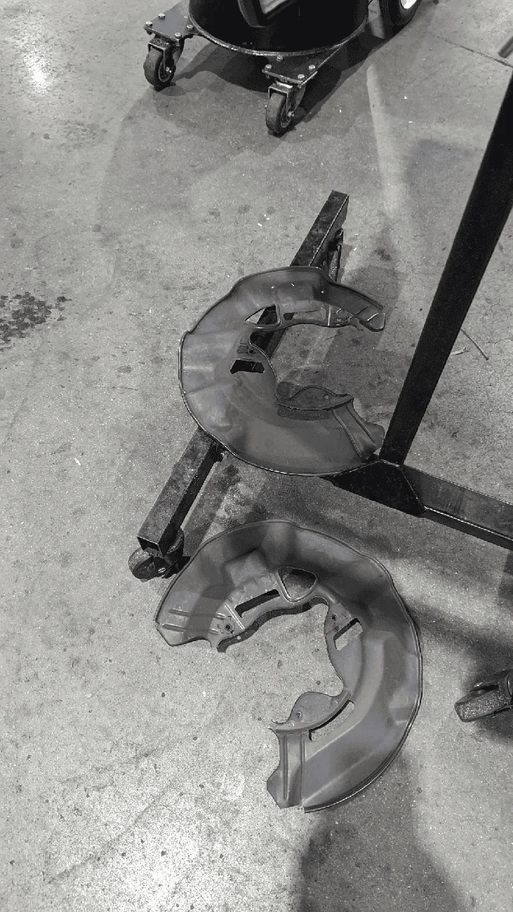

I'm doing a little track prep today myself! Removing the front brake backing plates, installing a new set of DS3.12's and tossing in a set of paragon titanium shims.

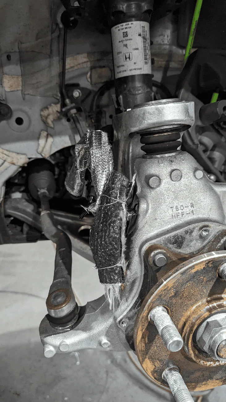

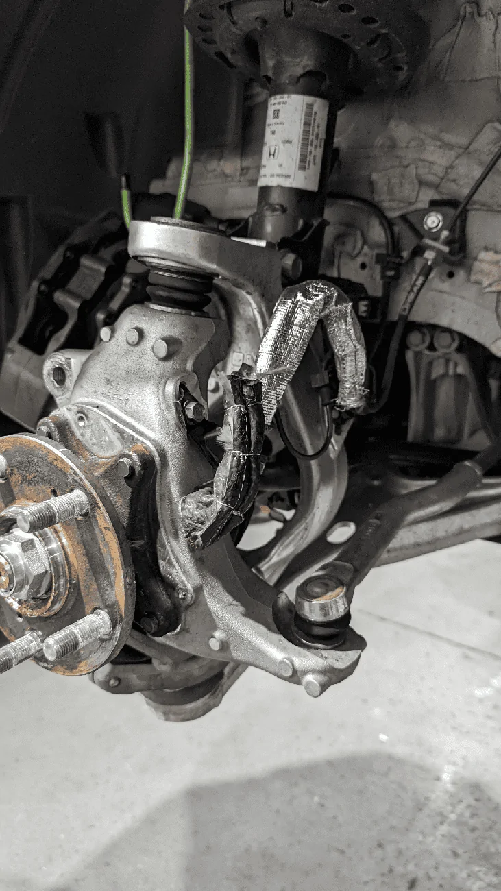

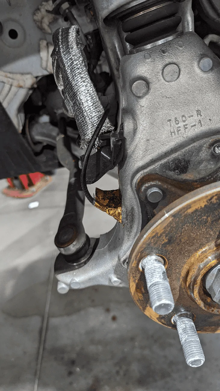

Track prep complete! Removed the backing plates and added thermal protection to the vehicle speed sensors and the part of the brake line closest to the rotors! Tossed in a set of brand new DS3.12's and Paragon titanium shims. Oh, and a quick toe n go!

Looking good. Do you think the tie rod and ball joint boots will need some heat protection?
They're tougher than they look, but yes, and developing a solution for that might be tricky.
I had a buddy who worked on my Evo 8 TT car, and after the 3rd set of Whiteline balljoint boots getting scorched, fabbed a nice little metal shield for them. Worked great from there on out.
