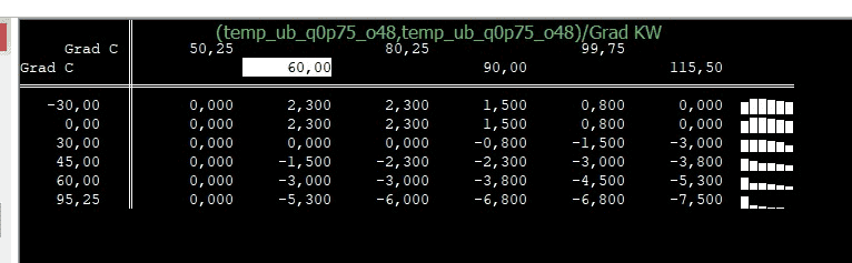

car limps over 120C, sometimes it goes all the way to 125 then limps.
but keep in mind, anything over 100 is bad. 110 is as far as I would consider acceptable.
These cars have many design flaws that lead to overheating. Keep in mind car manufacturers are more interested in making the engine warm up as fast as possible then making it cool under hard use.
And trust me, the car overheats stock, even with less than stock power it cant do a single lap on a Brazilian summer day.
X axis is ECT, Y axis is IAT. Both in Celsius.
11th Gen Honda Civic FL5 Overheated on Track 1713618095859-hw
Note that this is not for power reduction, this is for combustion correction. Side effect is higher and higher EGT and the car raising boost to keep up with the torque deliver and making the problem worse.

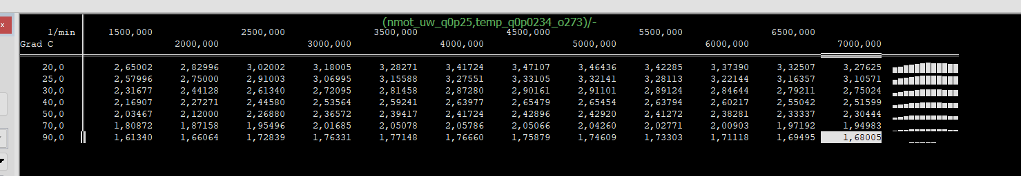

Also keep in mind this:
11th Gen Honda Civic FL5 Overheated on Track 1713618224308-1j
Torque reduction from too high temperature is NOT modeled, I´ve never seen a car tuned like that. Every single car I know has some sort of power reduction from ECT after a certain point.
I do model this very aggressively after 105 in my personal car and at 110C I have around 230-240whp and temps still climb.
The only sort of actual power reduction we have is this:
11th Gen Honda Civic FL5 Overheated on Track 1713618411416-be
But this is INTAKE TEMPS, not ECT, and this comes from a turbocharger compressor model provided by the turbo manufacturer. This is not intended to protect the engine, it´s there to protect the turbo instead.

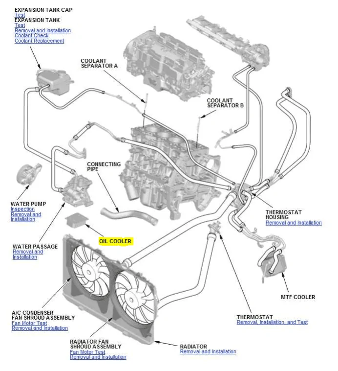

If you look closely to how the system is setup you can see part of the reason it overheats.
look close:
11th Gen Honda Civic FL5 Overheated on Track 1713618607541-j3
There are 4 parallel systems, a lot of the water is not flowing trough the radiator. This is bad.
Modern cars that have parallel systems use water pumps to control flow to this systems, and most of them have auxiliar radiators on the bumpers. Look at an RS3 for example. Or M-series BMW´s.

Sorry, not all of us are familiar with the internal passages of the thermostat housing. Can you explain the four parallel loops? I can see the heater core (although that takes in hot coolant so that probably doesn’t count), the engine block and head, oil cooler, and mtf cooler. Not sure if I’m correct.
Can you also explain in more detail what you mean by “a lot of the water is not flowing through the radiator”? It sounds like you’re saying, for example, water can go through the mtf cooler then go directly into the oil cooler loop without going through the radiator to cool down? Or does coolant somehow go through the engine, exits as hot water and skips the radiator, then goes into the oil cooler?
Vito.FL5
Victor
Sep 20, 2023
206
424
Brazil
2023 Civic Type R, 1997 civic Vti EK4, 1999 sedan
The hot water comes out of the head, then it has 5 possible paths:
To the radiator, then back to the engine
To the turbo, then back to the engine
To the transmission, then back to the engine
To the heater core, then back to the engine
To the throttle body then back to the engine.
See that a good amount of water is not being cooler on it cycle trough the engine. It´s either getting more energy from the turbo and transmission, or just circulating back to the engine without cooling at throtthe body and heater core (assuming you dont have hot air blowing out the vents).
I´m remodeling the whole system in my car so that all the waster has to pass either on the main radiator, or on a secondary one. Let´s see where that goes.
That’s very interesting!
The heater core usually has a valve so coolant doesn’t flow when there’s no hot air required, so that specific loop seems fine to me. I’ll be interested in seeing the result if you can remodel your cooling system—but I have doubts will make a huge difference. My guess is the large diameter tubing that leads to the radiator means most of the water volume is already going there anyway, so any improvement from redirecting the other smaller tubs will be incremental.
Edit: (I see from the other post the heater doesn’t have a valve in our cars.)
Yes. That's why people connect their secondary radiators in series with that branch. Even that mishimoto one taps in that path.
Tube diameters are a good indicator of expected flow rate for each branch. But tubes themselves aren't really a restriction compared to the heat exchanges on the same lines (or lack of!). For instance, we believe the coolant line inside the turbo to be pretty much restriction free. So it should present a high coolant flow even though the tubing diameter isn't large. And this coolant is going back into the engine hotter than when it left. A friend plugged this line and saw immediate improvements (I can't recall numbers). Was it because more water was redirected to the radiator? Or because that heat was being transferred to the oil instead?
