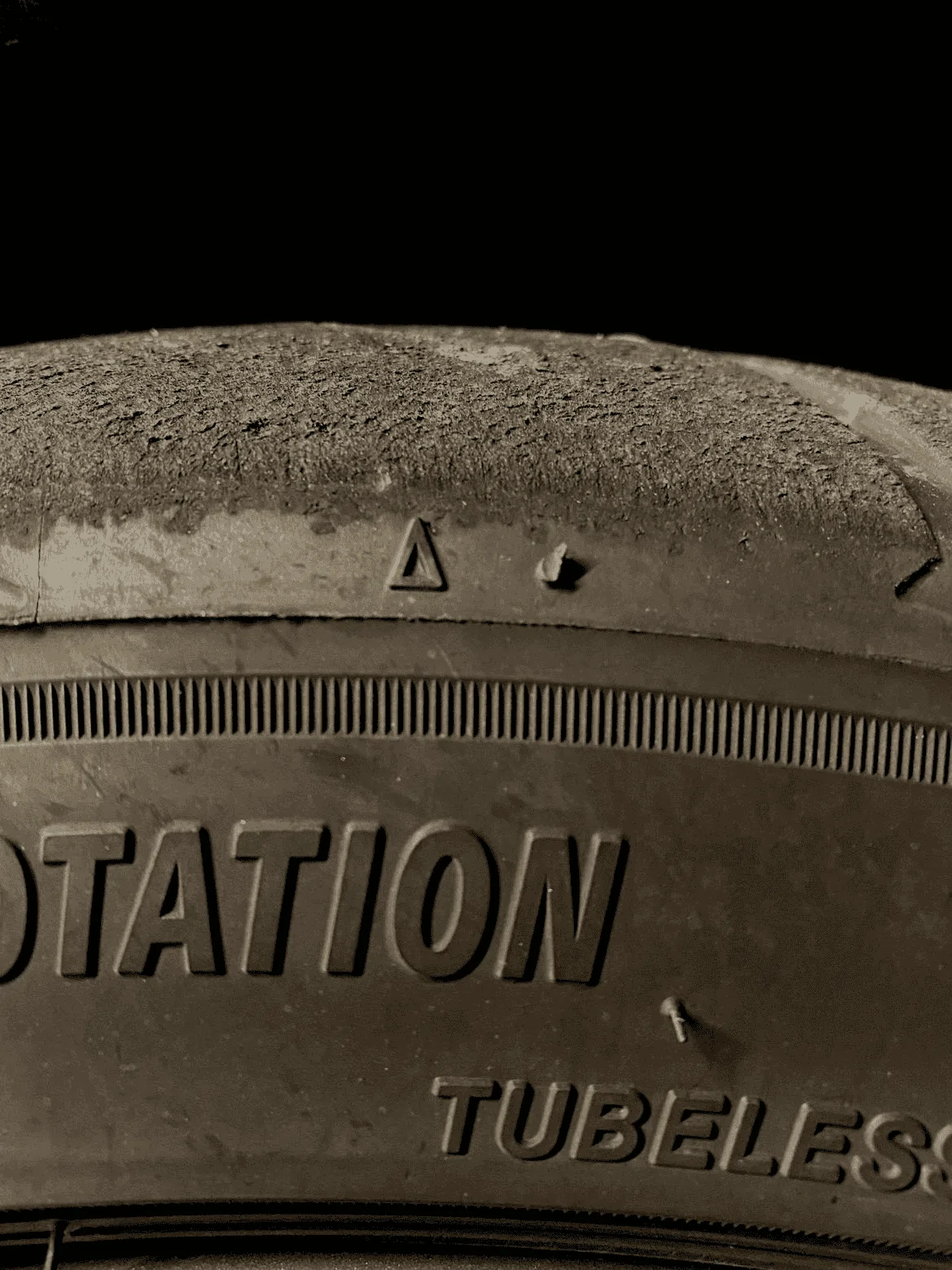

after each session, look at the triangle located on the sidewall. tire wear shouldn't go past the triangle. if it is, bump up the tire pressure. that will stiffen the sidewall. you may find that you may need go to as high as 40psi. with the stock 4s tires, i don't think you'll need more than 40psi to prevent extreme sidewall rollover.
I just read this and my jaw dropped a bit. DO NOT PUT 40PSI COLD INTO YOUR TIRES ON A RACE TRACK. I ran on my pilot sports. Cold pressure 26psi front and 27psi rear. After getting off the track they were 35 front and 33 rear.

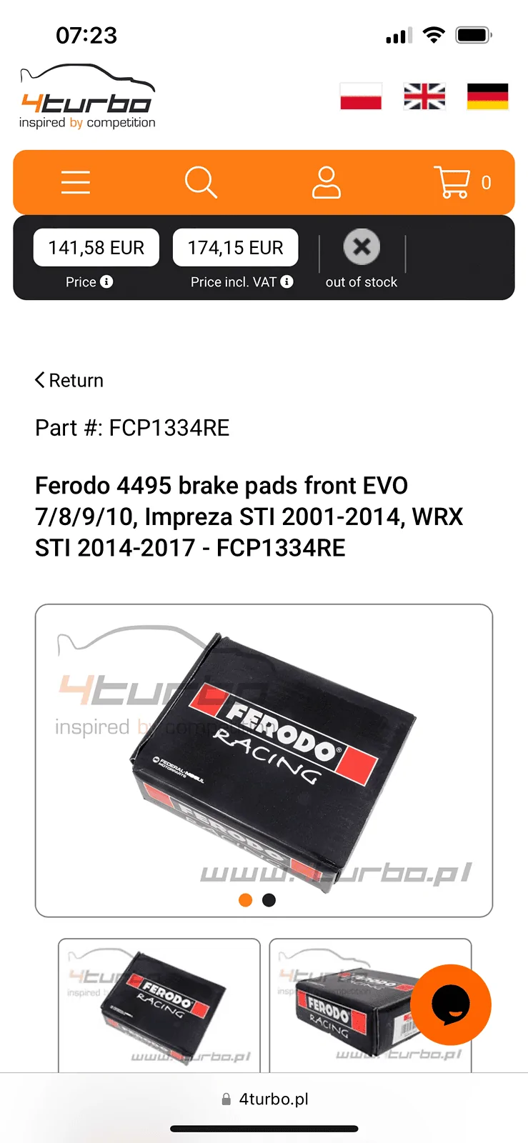

Damn, I could have sworn I saw some cross reference that they were equivalent but I went and looked at the box and it says Pad Material: Ferodo 4495 on the box. Maybe I was hallucinating. I did some googling but I don’t know what that’s equivalent to.

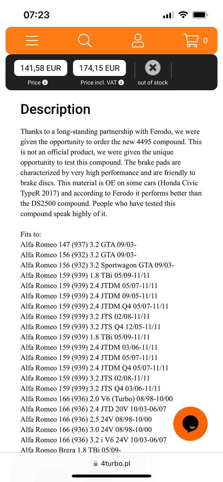

I found this. Interesting description.
