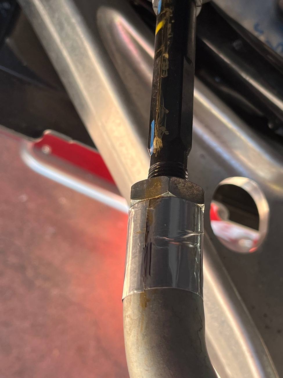

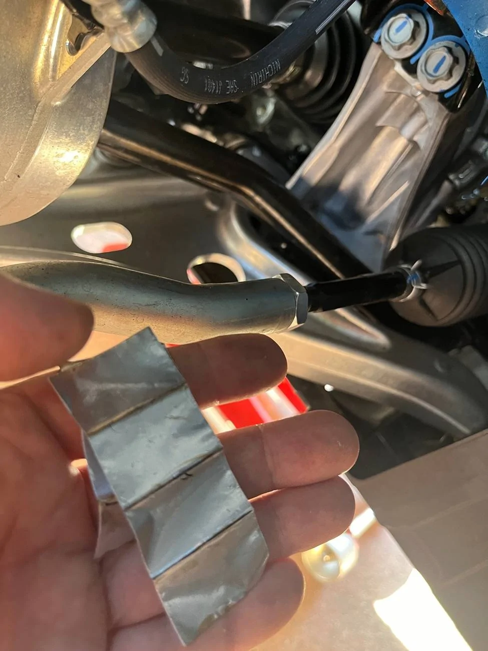

If your car is already aligned, I would highly recommend just marking your tire rods then adjust. It improved my times on Laguna Seca by 5 seconds easy. You can adjust at home, and don’t need to visit an alignment shop everytime.
A full turn on both is about 5mm toe out total.
If you mark it you can easily return back or add more.
With 5mm toe out the car turns in insanely sharp! I was 5 seconds faster with 1.5mm toe out, and will find out how much faster with 5 total.
#1 mid highly recommend
