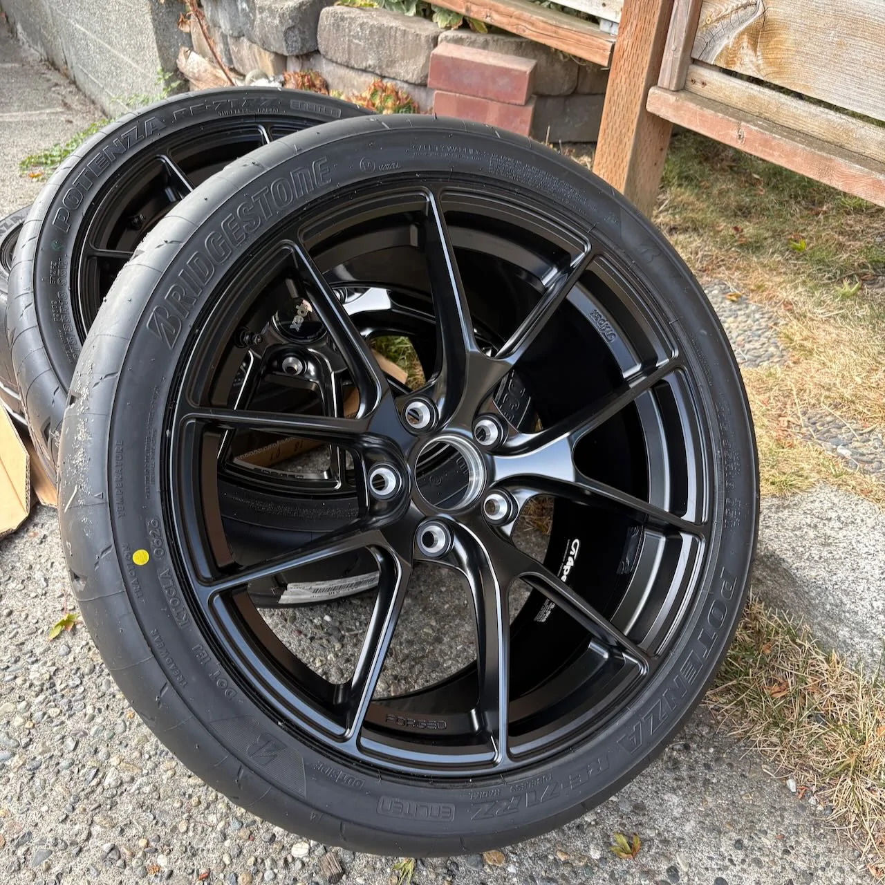

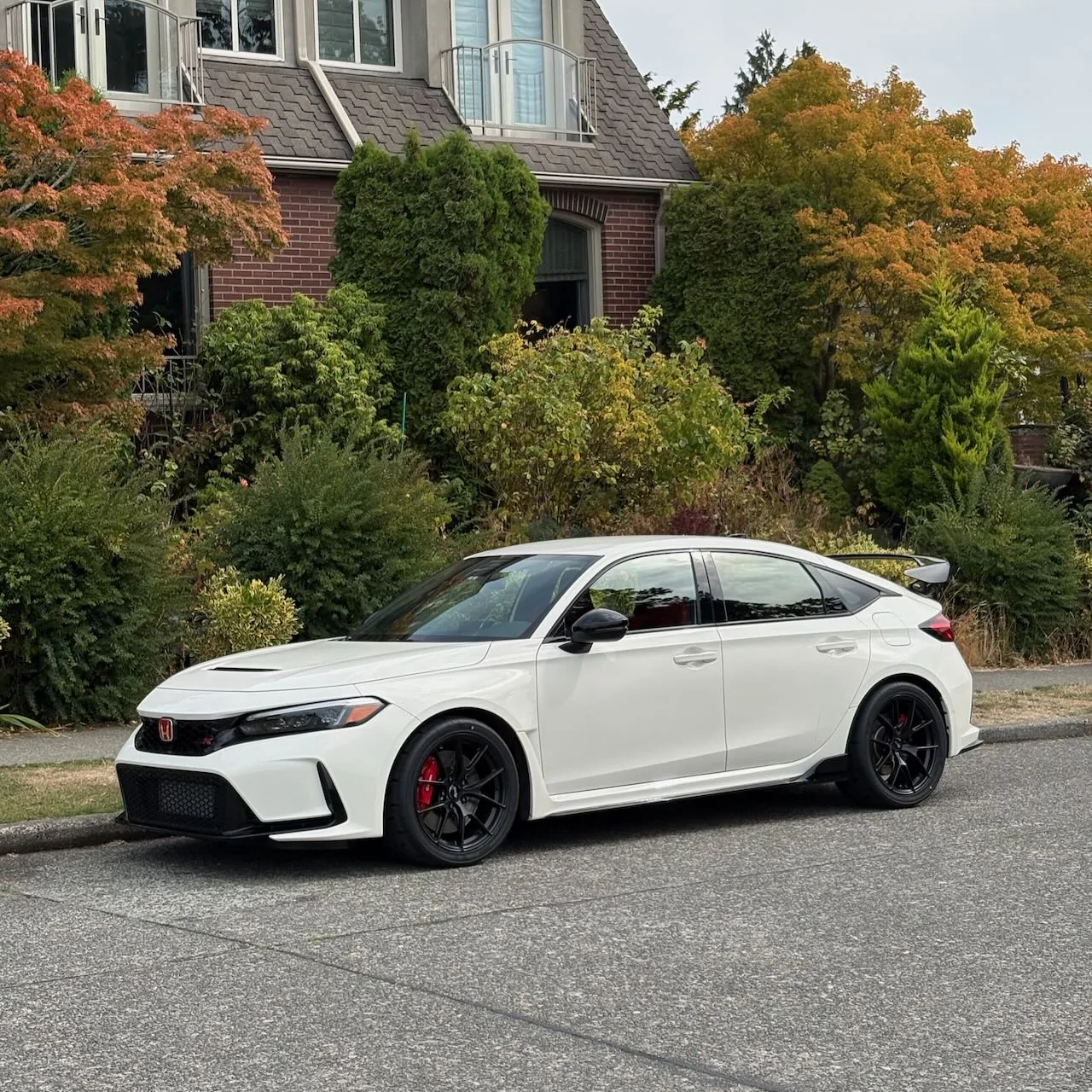

Hey everyone, dropping in to say hi before my first track day at The Ridge in my FL5. I have a good amount of track experience on my GR86 (and BRZ before it) but have never ventured into FWD territory.
I've got the car mostly prepped with CSG C1XB pads, fresh Endless RF650 and 5w30, and the WOT cooling plate. Then I splurged on the labor day sale for a set of Apex 18x9.5 VS-5RS. Just had 275/35R18 RE17RZ mounted.
Can't wait to see how this thing does!

Remove the rain guard under the hood and run your heater while watching water/oil temps. Carefully watch your tire temps and pressures and front tire wear since you’re running stock camber. ABSOLUTELY run with the pedal dance activated so you don’t destroy your rear brake pads.

Thanks for the tips! Definitely removing the rain guard and blasting heat! Luckily it looks like it will be on the cooler side that day—PNW has its benefits—but I'll be watching temps regardless.
Pedal dance for sure. Stock camber is indeed a bummer but at least it'll be more of a 7/10ths day until I get more comfortable. Might rotate tires at lunch too.

If you expect a 7/10 day, AND cool, I would say this advice is completely meaningless for you. I wouldn’t remove the rain guard, I wouldn’t run the heater, your camber will be fine, and I definitely wouldn’t bother with the pedal dance. You’re just going to make yourself uncomfortable and create extra work for no real benefit. When you start reaching pace and ambient temps are warm, these things will start to matter. Have fun!

Nothing about that makes sense to me other than perhaps the “uncomfortable” part if running the heat.
Pedal dance takes 10 seconds, saves your brakes, and has no downside on track.
Rain guard takes 30 seconds, zero downside.
Camber will be a problem for PS4S if his 7/10 is fast enough. I know this from going through a lot of PS4S tires on track before and after camber adjustment.

The PS4S won’t hit the track unless it rains. I’ll be on those RE71RZs pictured above.
I’ll do the rain guard and pedal dance and just keep an eye on stuff. CSG pads are expensive (also incredible btw, blew me away even pre-bedding at street temps) so I’d rather not roast the rears on day 1. 7/10ths to start and we’ll see if I can restrain myself
